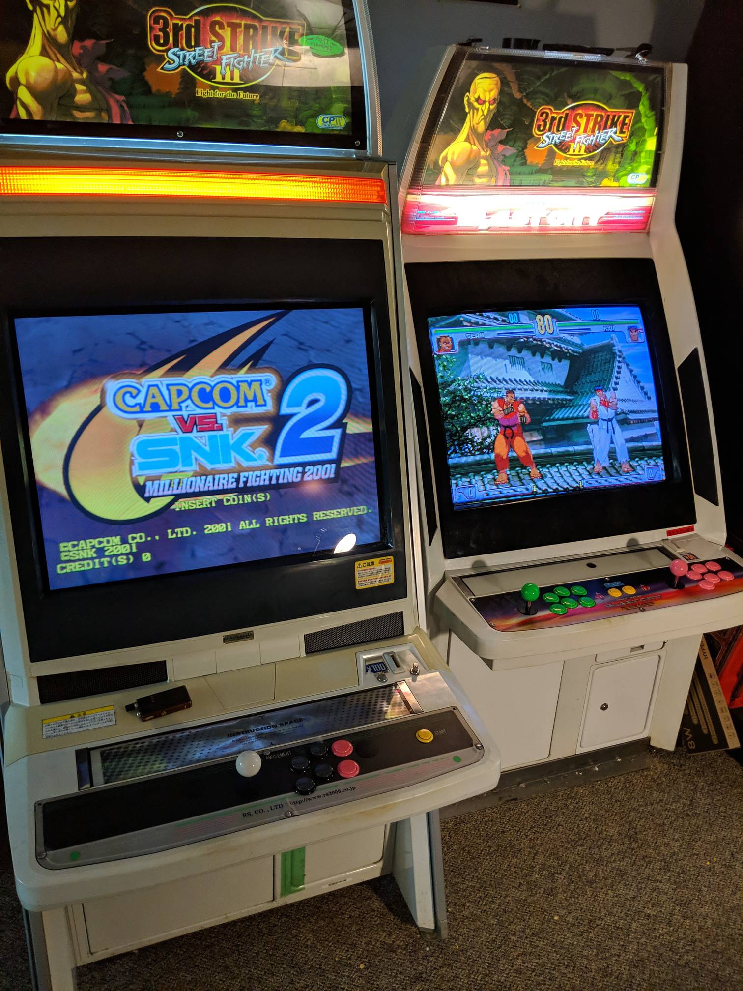

Is anyone else using PiDimBoot? If so, I do have one last question. Is there any way to have it automatically boot into the last game it sent to the netdimm?
Also, is there a CVS2 ROM that doesnt have horrible sound issues? Im getting weird crackling and cut-outs of audio, switching to mono left and right, etc.
common CVS2 ROM doesn't have sound issues, it should be something wrong/broken at your end. be sure to check your NAOMI RAM test, at least.
you're right. Passed ram test, so I switched the audio cables and it works great now!
