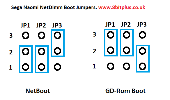

I'm dumb. It was in GD-ROM mode, which didnt know existed until just now. Switched the jumpers and it now boots into network mode. The problem of sending the game failing still persists though. Here's how to do the jumpers: http://8bitplus.co.uk/projects/netboot-sega-naomi-netdimm/

Your jumpers are set wrong on the NetDIMM. Set it up like this:
