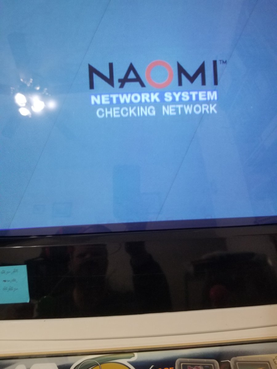

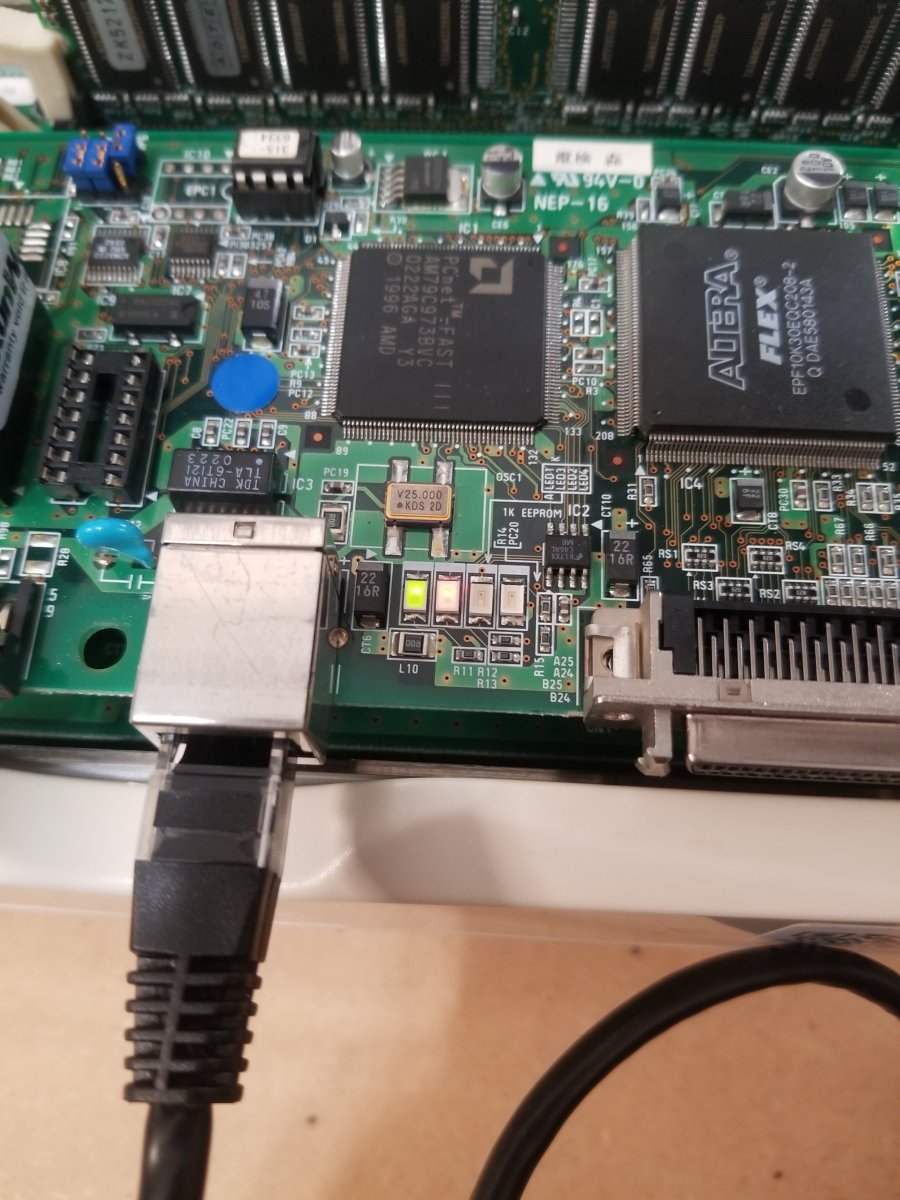

I am starting to think the issue is the pi. While trying to connect to it, none of the network indicator lights on the board lit up. As a last resort I disconnected the pi from the dimm and connected a standard ethernet cable from my internet router to the dimm. Not only did the lights come on, but I also got the checking network screen.

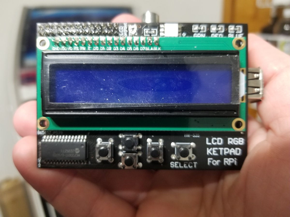

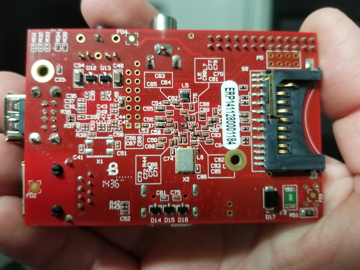

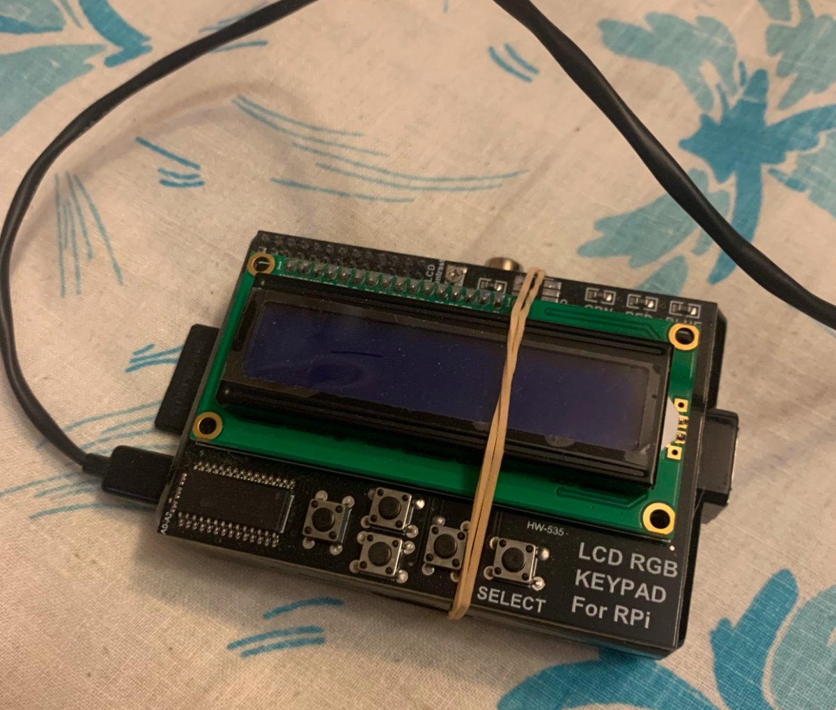

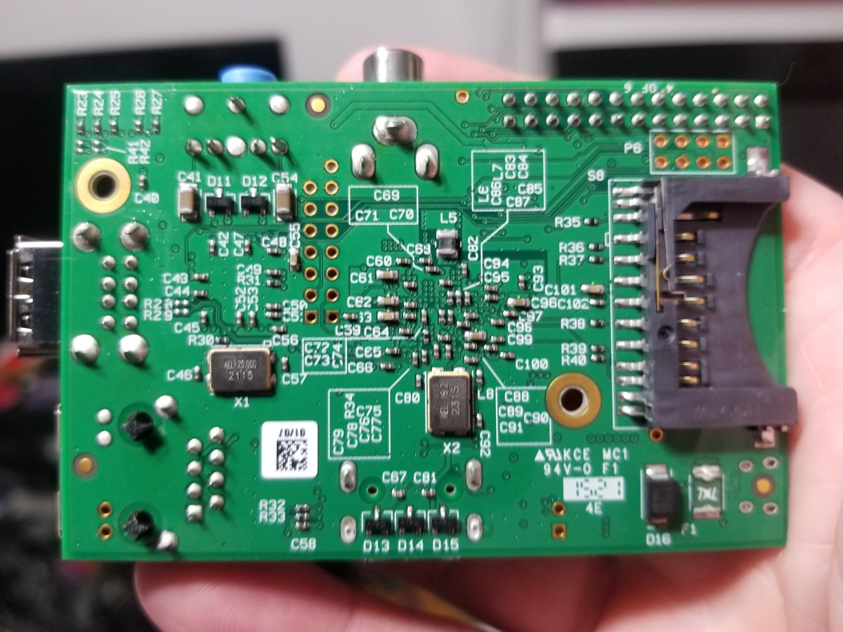

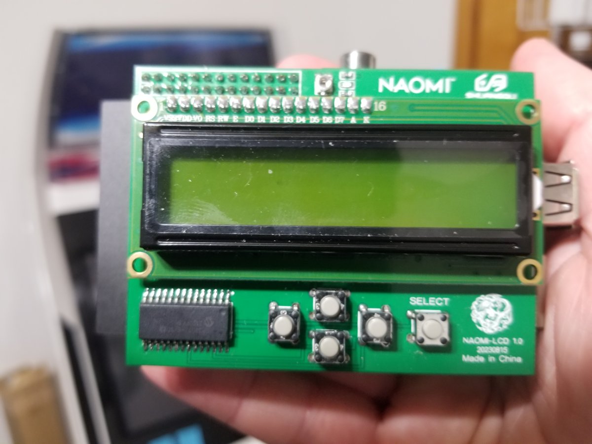

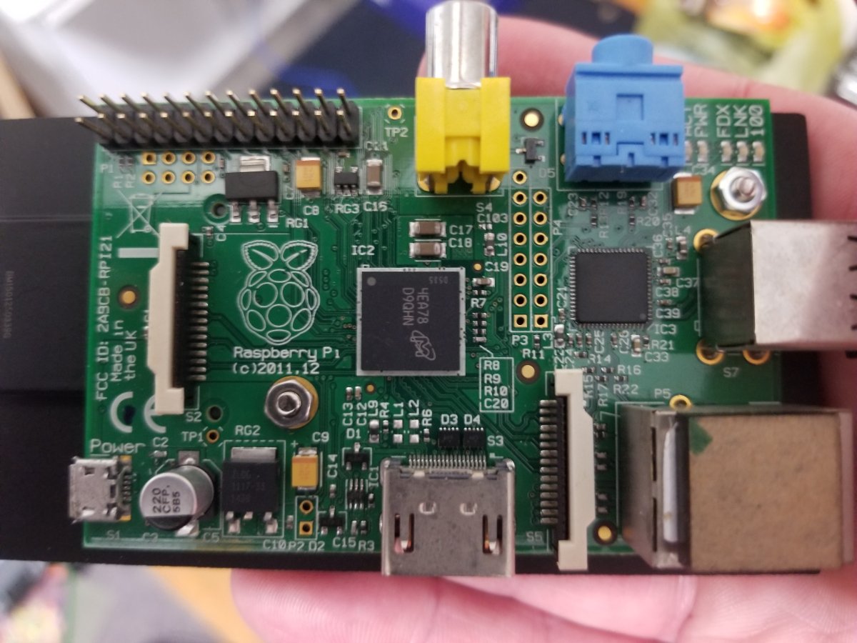

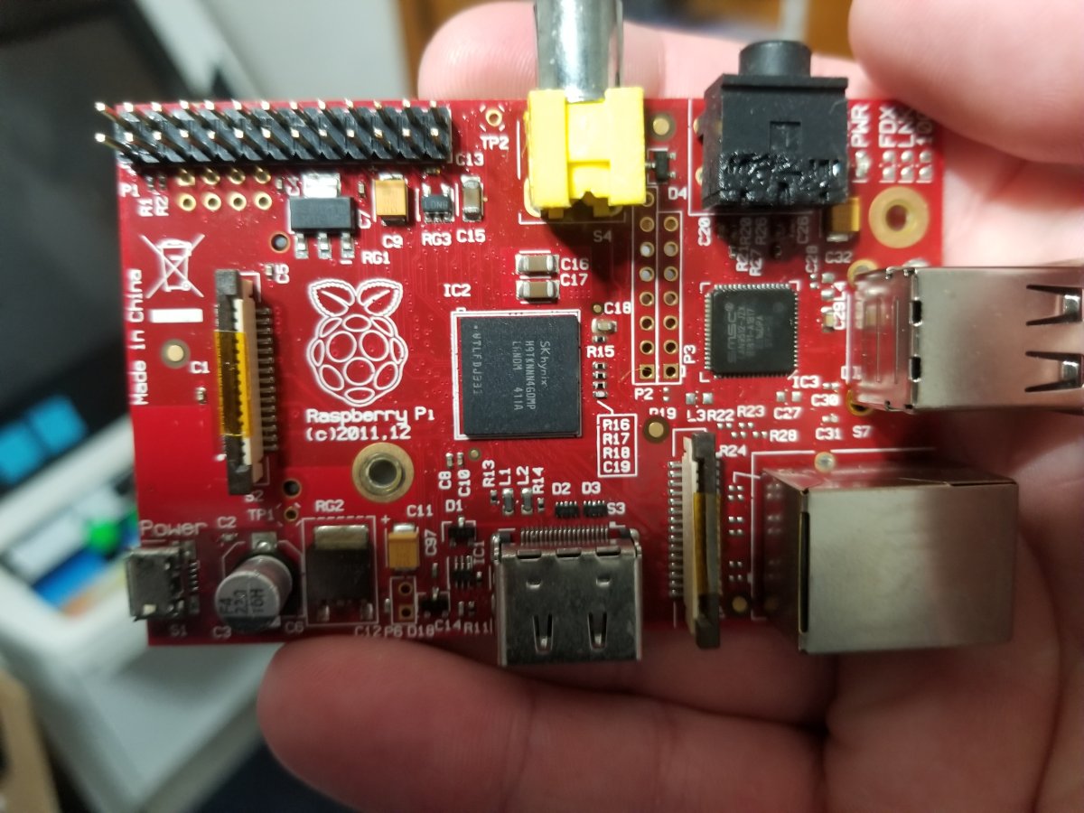

To figure out what was the actual culprit I tried the new Pi sd card in the bad Pi and it did not work. (Strangely enough, the sd card from the bad Pi works perfectly in the new Pi) I also tried swapping out the lcd with the one from the new Pi (just in case something could have been soldered wrong) still no bueno.
The dates on both are the same, 2011. However, the Pi that works was made in the UK and the bad one was made in ......... China.
For anyone who may be looking at purchasing one from AliExpress I am including pics to help differentiate between the two.
Green LCD w/NAOMI printed on it & Green Pi = Good 1st three pics
Green and Black LCD & Red Pi = Bad Last three pics
The bad Pi used Piforce Tools v 1.5 and the good Pi had WiPi Netbooter on the sd card.
An added note, Piforce Tools loads much faster than WiPi Netbooter on the functioning Pi.
Thanks to everyone that chimed in with help!!!!
