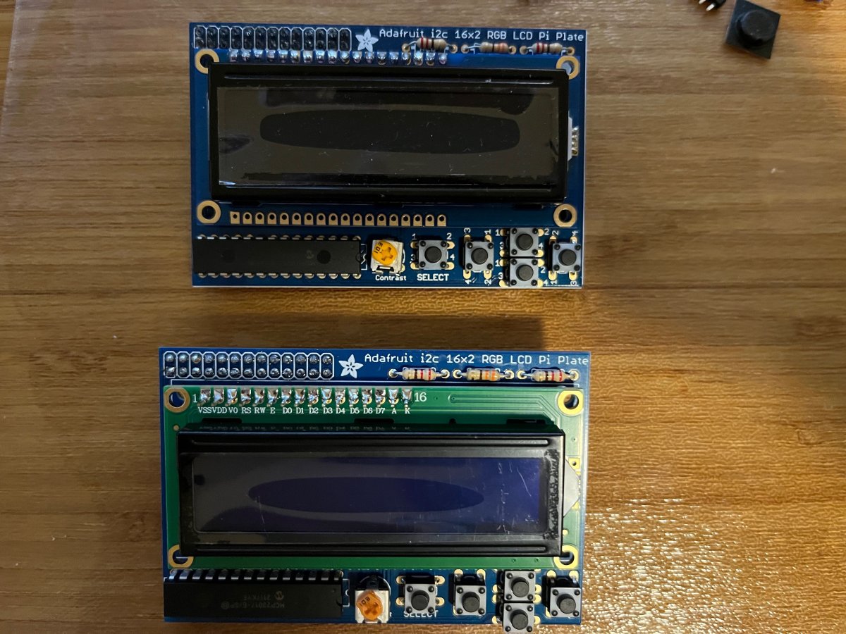

If you have a 16 pin LCD rather than 18 pin, it means that you're LCD does not support RGB commands. In the piforcetools.py file there is a line...
Code:
lcd.backlight(lcd.BLUE)
Comment this line out, and everything seems to work afterwards.

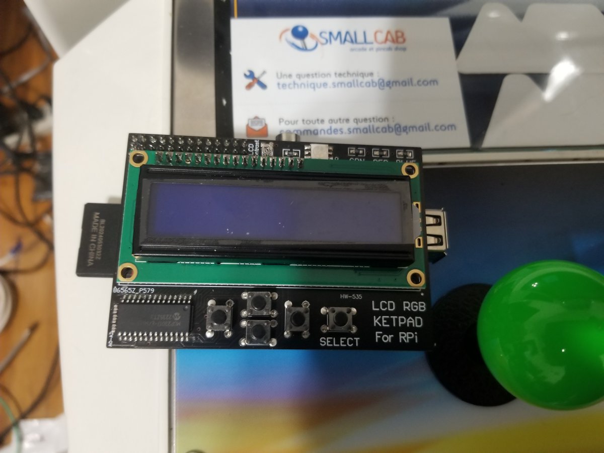

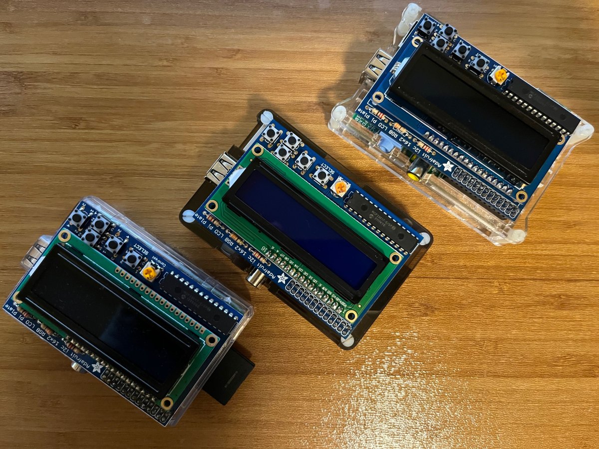

Edit: here are some pictures of my current piforce tool systems (trying to find the best combination of case and components). All are using adafruit LCD panels, but note that the middle one in the first picture one has 16 pins rather than 18 (two are left unused on the button PCB).

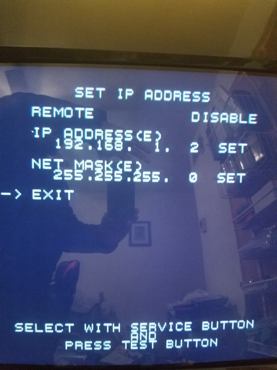

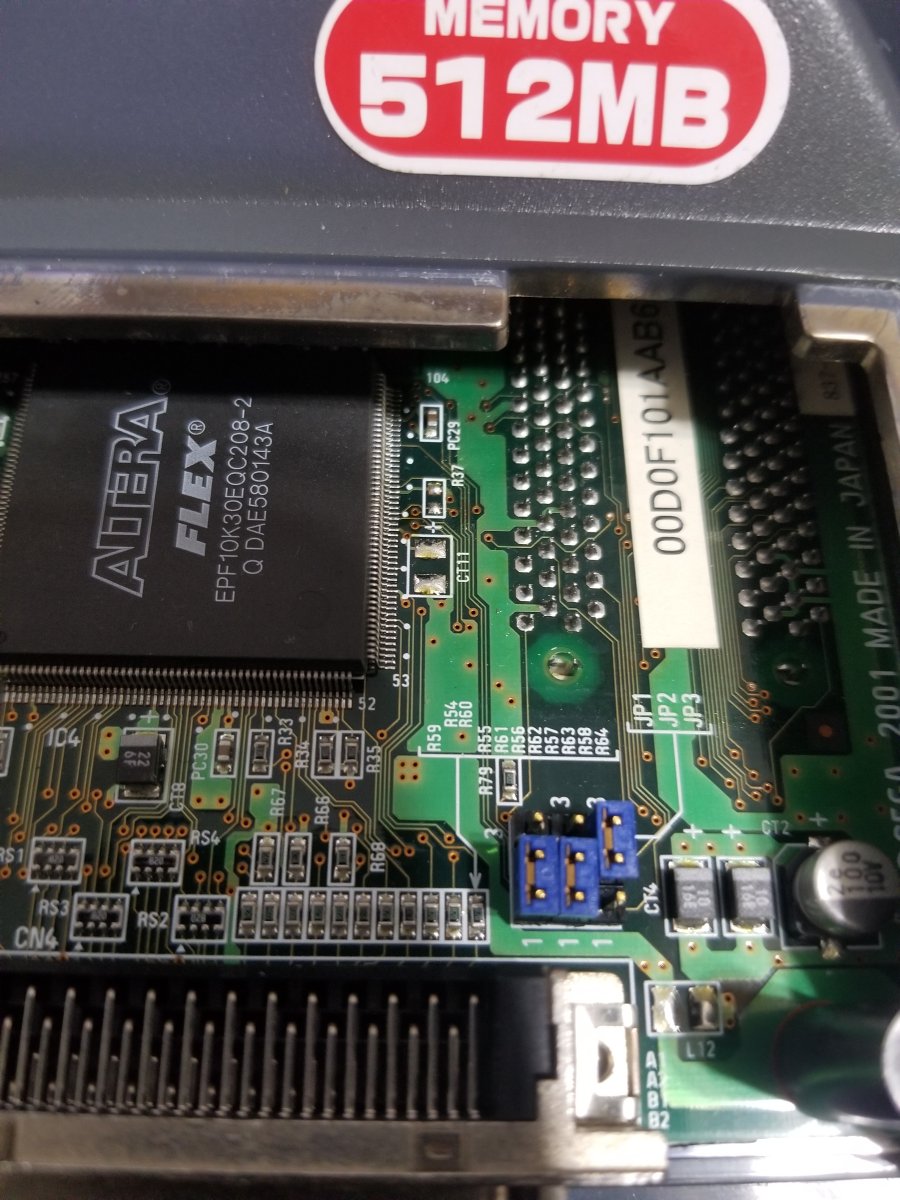

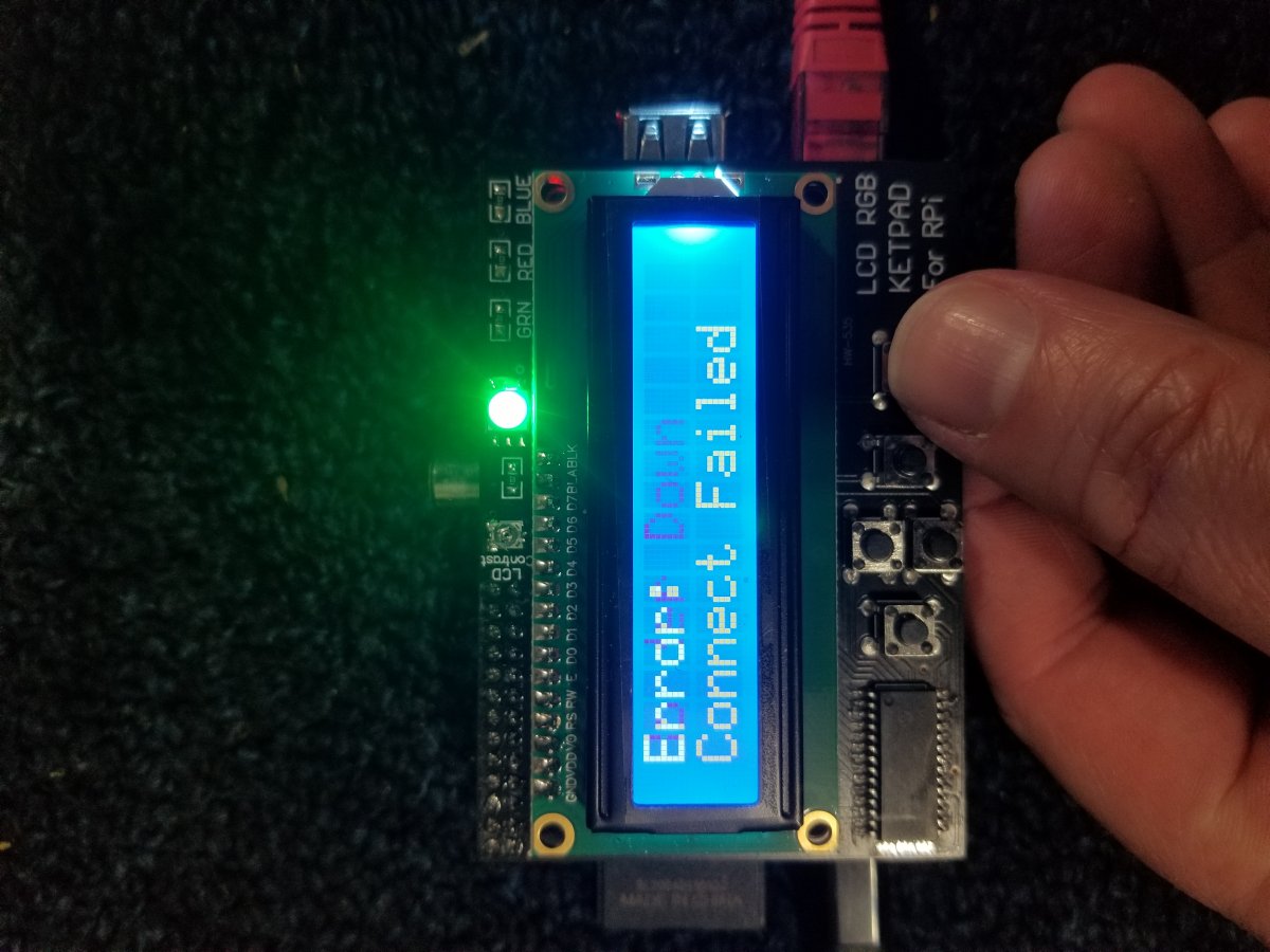

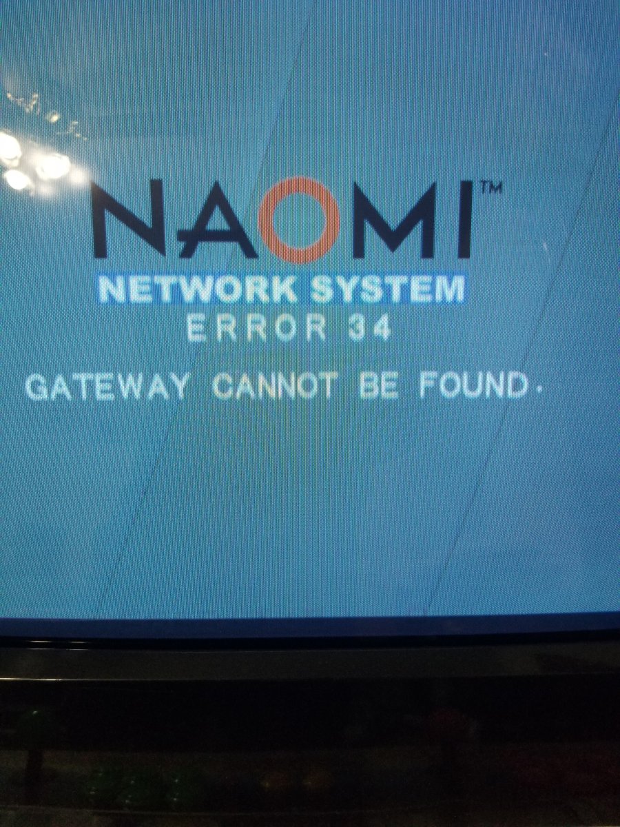

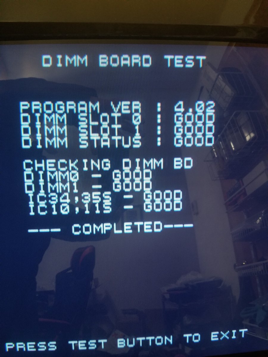

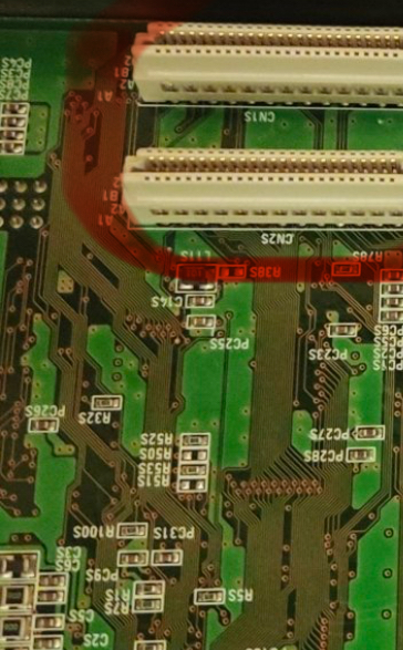

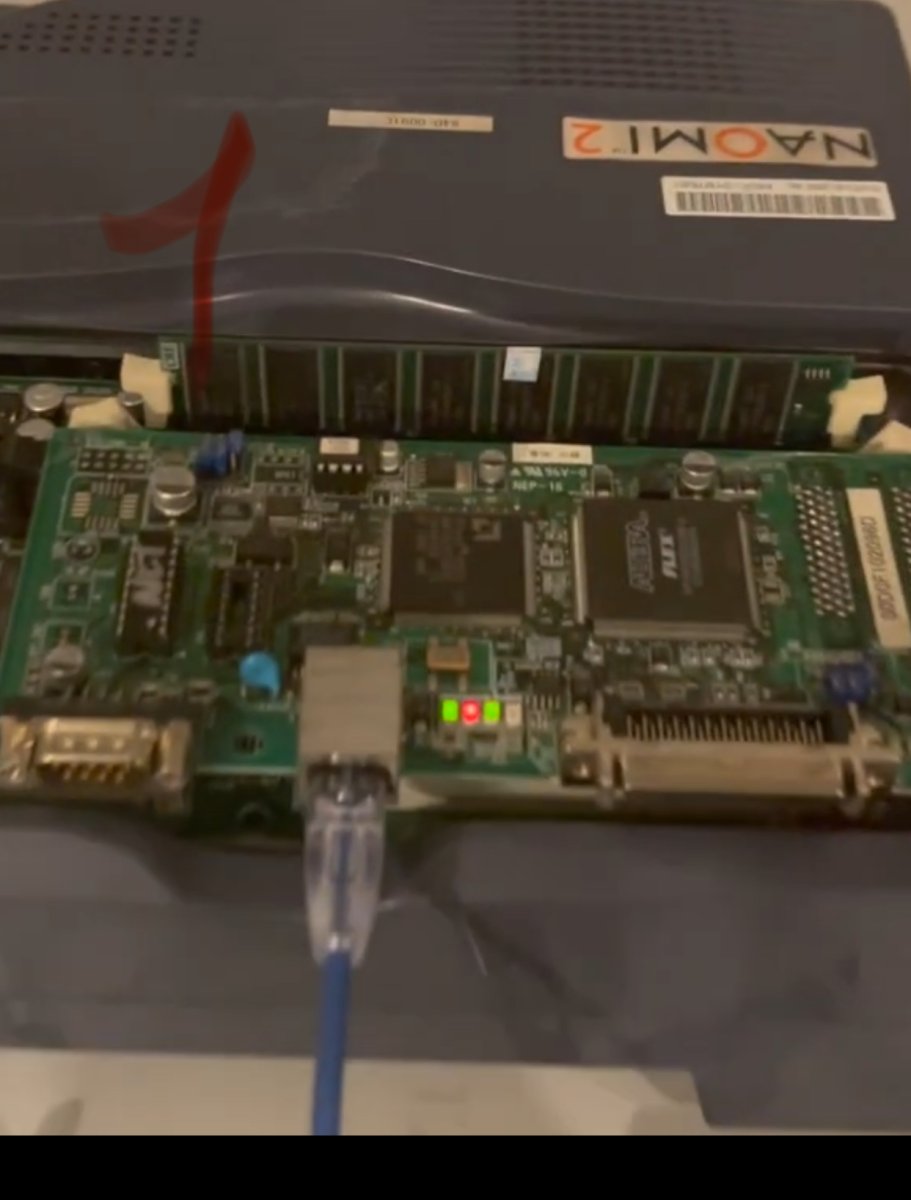

I am having the same issues with my Naomi 1. Does anyone have any ideas? I have two separate Net Dimms that I have tried. One is a standard netdimm with 512mb, the other is an axunworks netdimm 512mb with a built in cf reader. The jumpers in the standard netdimm are set correctly I believe (pic included), and the jumpers on the axunworks netdimm are being used for the cf reader. That netdimm has a switch to go from cf to net. At first I thought my crossover cable may be bad as the one that came with the pi (pic included) I bought from aliexpress was folded up so I purchased another from Amazon. I have set the IP and Net Mask to the settings suggested by others (pic included) and the same IP on the pi. The Naomi shows an error 34 (pic included) and when I ping the pi it states connect failed (pic included).The standard netdimm was one I purchased from an arcadeprojects member with a triforce who used it to boot games to said triforce.
I had the same problem, but the problem was in the RAM. In your photo, everything is ok with the RAM. Do you have 256 + 256 RAM? Try only one 256 RAM. or remove and blow out the slots and RAM boards
Gateway cannot be found is not a RAM issue.
Not the exact same though?
I described my experience, maybe it's a coincidence.
But if inside 256 and 256 ram and one 256 ram dont work, always error 34 in my situation
Try pull out (blow or clean) and put back comm board inside dimm. Maybe connector between dimm and comm board issue.
The axunworks netdimm has a 512mb stick, but the standard netdimm has dual 256mb sticks. I will try removing one of the 256mb tomorrow to see what happens. Thanks for the advice!
Try only one 256mb, if fail, remove and try other one 256mb. Insert to slot 1
Ps
sometimes the RAM (SIMM) passes the test well, but NetDimm was not completely compatible. Sometimes you need to order other SIMM PC133 chip
