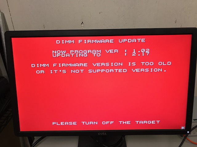

Well, the forum member that loaned me the disc beat me to it. Just got back from business travel. He sent me a message confirming that the 2.17 firmware disc cannot upgrade a Dimm that is at 1.02. Here is the screenshot he took:
Oops sorry. I put in a typo on my last post. The disc used was the firmware 2.17. Fixed that post.
So it may still be possible to update a 1.02 firmware revision Dimm to 2.xx if one can get a hold of an older firmware disc with the security key. But that in itself is proving to be harder than turning water into wine. I am making the rounds inquiring where I can get such a disc. Getting such a disc is next to impossible. Getting it with a security key, is like parting the Red Sea. As it stands, the only practical way to achieve this is by using Dr. Tyler Durden's surgical method. I talked to Mitsurugi-w and he offers that surgical service for $25. I am starting to weigh that cost with the impossibility of finding an older disc.

I fixed my GDROM (thanks @twistedsymphony!) and gave the 2.17 firmware update a whirl myself. No luck. And for shits and giggles tried the same with the 3.17 disc, which I know doesn't work either. But thought I try anyway. Here are the results:
Sigh...........
