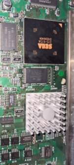

I was able to update my Dimms with firmware 1.02 (with only SCSI connector) to 4.02 (Changed to ethernet) without any problem by changing the bios with a ST M29W160EB70NB chip. If you notice something different, the phrase in blue that says "Network System" at the beginning no longer appears, I just select the game in a normal way using a raspberry pi, on the screen it says loading and loads the game in a normal way and played without problems and the image has not gone black or the game frozen at any time
I think that myth is false...
(Also someone who sells the metal cover for the Network board I'm looking for 2 units)🤣
