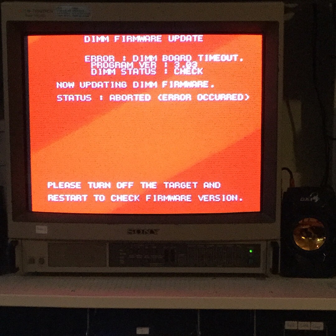

I tried from 3.03 to 4.02 and it didn't work. so maybe I do need to go to 4.01 first? here is what I got when I tried.
Update, after reseating the dimm board and trying again, eventually it worked! I did go directly from 3.03 to 4.02.
