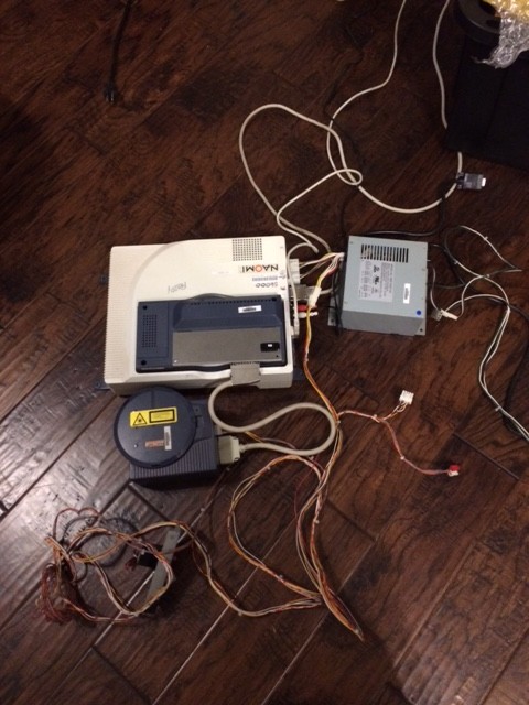

Looks like my GDROM decided to die since the last time I played with it. Did everything, measured voltages, used different SCSI cables, (I have two official Sega GDROM cables), used different Naomi's. Still no good.
Sooooooooo...........paging @jugu. It is your lucky day bud. You don't have to surrender your Egret II to get that "sweet sweet upgrade action" if you have a working GDROM at your place. I can bring the discs down to your place in a week and we can play around with this.
