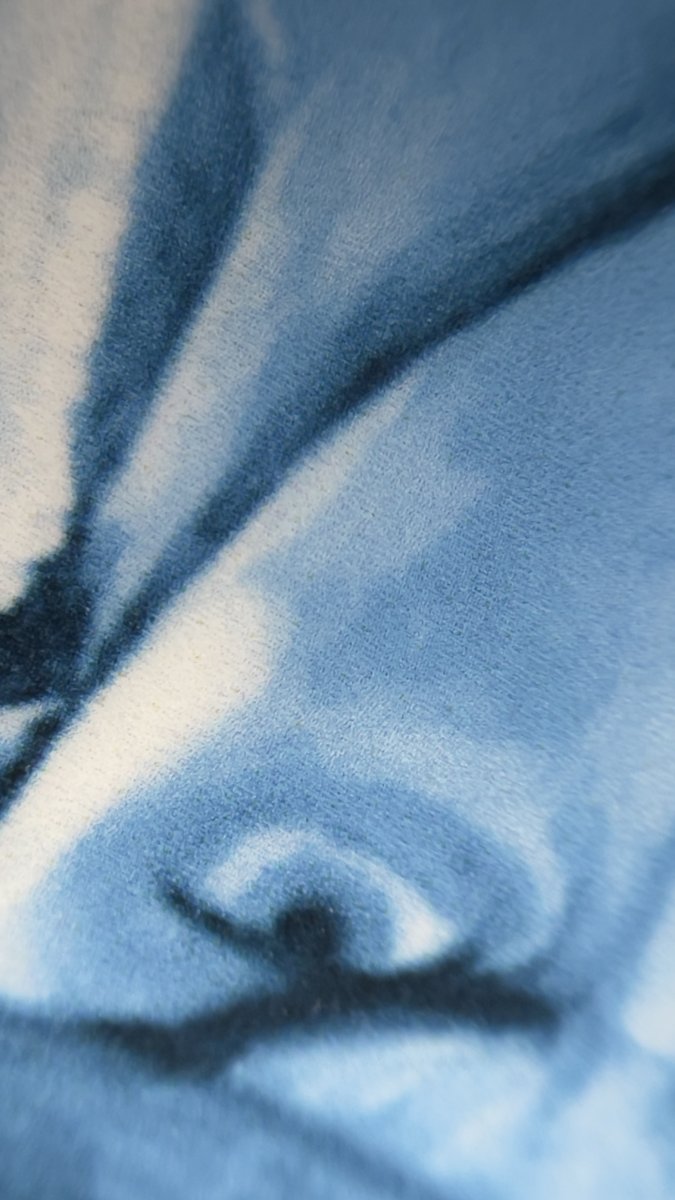

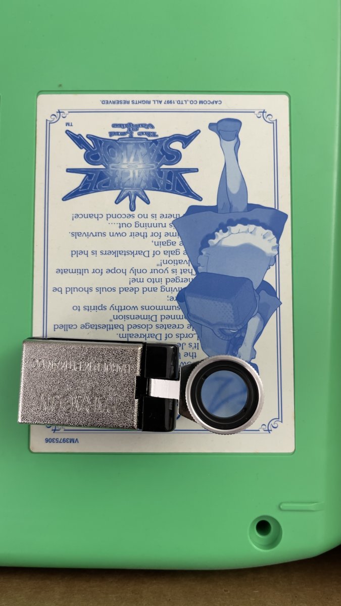

The game label looks to be digitally printed VS the 4 color offset printing that all my other boards use, and I was able to confirm by using my press check loop.
