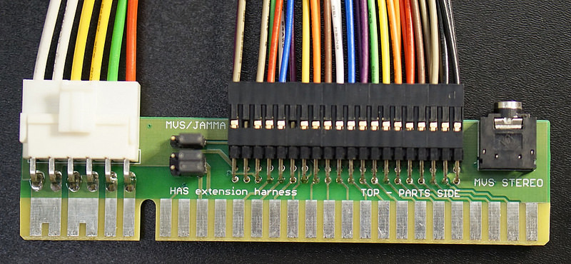

I have heard something like that when the NeoGeo board is not 100% Jamma and you need a Jamma to NEOGEO adapter. If your board is 100% please disregard what I just said:)
Well the sound is currently a problem, but take a look at my first JAMMA board running inside (well sotra next to) the Vewlix C!
Short Video
you are correct. Neo Geo MVS uses a non-standard JAMMA pinout with the audio wiring being the most problematic difference:
I would not recommend plugging an MVS board into a normal JAMMA setup without dealing with the differences first.
