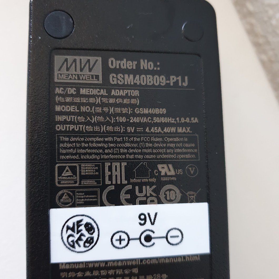

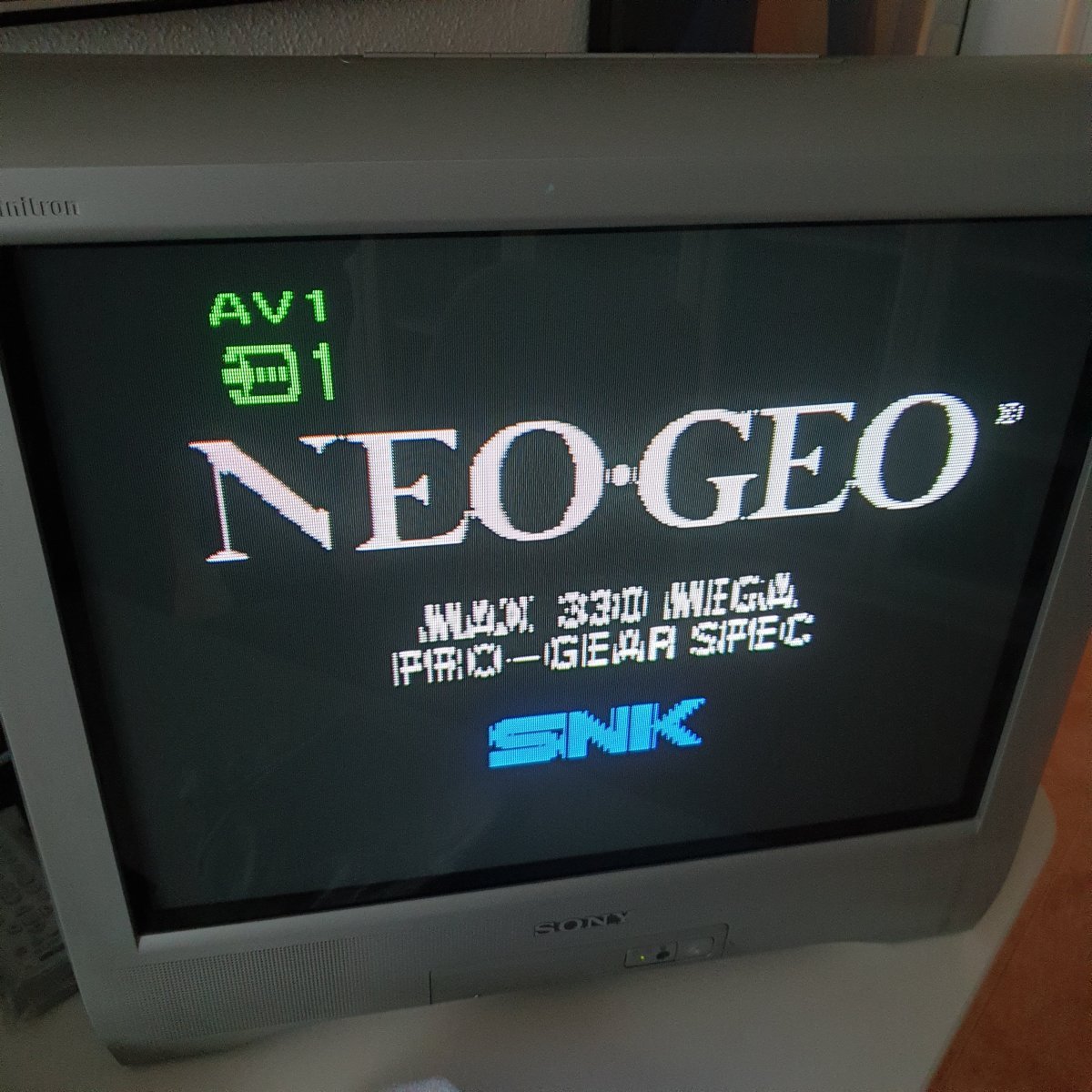

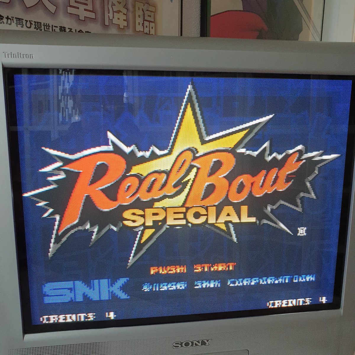

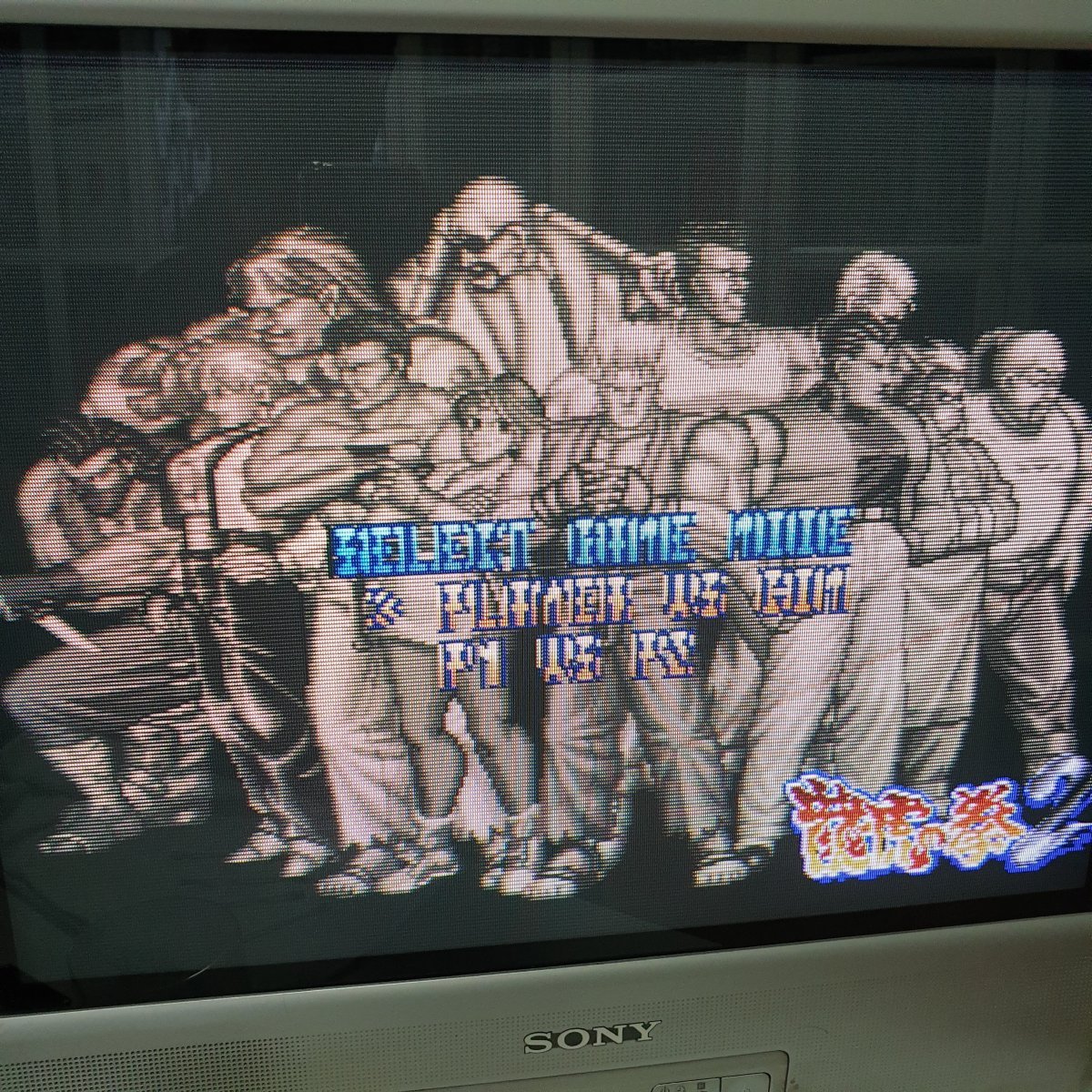

In my 3-5 console (POW-3), I get some text corruption on the games, I need to press the reset button and load the game several times. Eventually after several resets, the game will load fine. I use a decent PSU (see pictures). On my 3-6 system, on the other hand, the vortex cart plays just fine. No graphical issues, games load fine from the beginning (using the same PSU). Only issue I've found is Blue's Journey audio seems to be corrupted, does not sound like the original rom. But this happens to every console I have tried.
Other games sound good.
Are these carts known to have issues in 3-5 consoles, or maybe its just my console that needs some repair? I have also tried it in another 5v console (POW/POW-2) and there, it simply will not boot properly.

The issue you see is not specific to a revision, but a fundamental difference between the 2 systems which I've yet to figure out. I've seen 3-6 systems that show the same graphical issues you have. I believe the issue might go beyond the power supply used and is at the component level. But I don't have enough AES revisions here to confirm this. If you still have both AES systems, and are able to open the 3-6 and 3-5 systems, can you look at the CPU and report back? It would either be a HD68HC000PS12 or TMP68HC000N-12. I'd be especially interest to find out what is in the 3-6.
Thanks for providing some light, leonk! Unfortunately, none of my systems have been opened. I will ask a friend if he can take pictures of his 3-6 "working" console and report here.
Interestingly, "your" vortex cart has no graphical issues on the systems I own (3-5 & 3-6 POW3). Only "rewrite version" does. Which is strange, assuming both carts use the same PCBs after all. None of them boot on my 5v consoles, but as I understand on POW/POW2 consoles that is normal for 161 carts.
