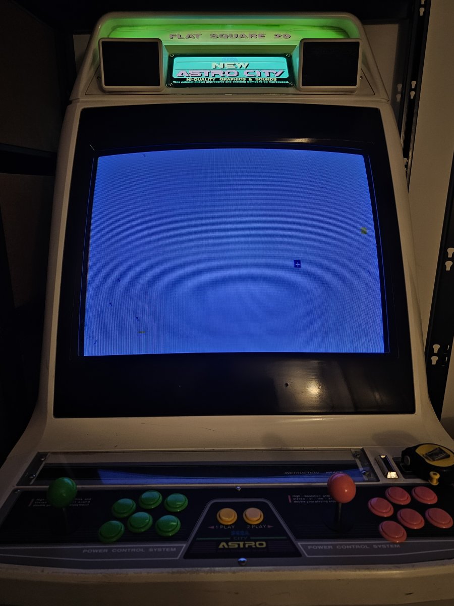

Did you make sure to place the 27c160 in the proper place on the multi?
Edit: looks like you did.
Stupid question but you did program all of the eproms but NOT the gal?
It was an even more stupid problem ...
I was thinking that when you buy it with eeproms you don't need to burn it.
I burn all eeprom and the gal but i still have my issue.
Screen change depending of the game i selected.
This one is for dragon Breed. The other in my previous message is for r type 2
EDIT: it was so long since i use my eeprom burner that i didn't do it properly.
Sorry
EDIT 2 : I burned all eeproms a second time properly and the gal too, i still have the problem
EDIT 3 : i checked all eeproms one wasn't good. now they are all good but still the same problem
In fact my problem is the same as the one that Johnrambo'sknife had.
@Mitsurugi-w send him a new Gal for the motherboard.
Maybe it could solve my problem too?
The gal never needs to be burned. It's a protected device that I program here. So I'm guessing that your gal just needs to be reprogrammed with proper code.
In the pack with all.the rom there is the file for the gal so I burn it. And i didn't understand the right way when you ask me "Stupid question but you did program all of the eproms but NOT the gal?" I understood that you ask me if i forget to burn the gal. Sorry for the lost of time
Yeah I'm not sure why whoever made the rollup had included it exactly. Probably just for completeness. Causes more confusion than good though.

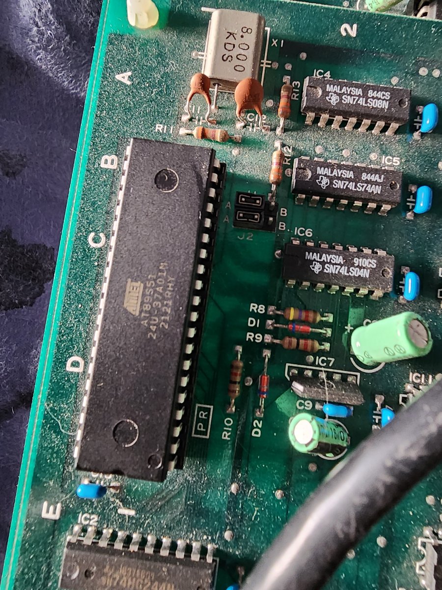

This is a special request. If you bought a multi and have one of the following i8751, please DM me. That's the long chip that you need to replace with the AT89S51 that you receive with your kit.
Please check if you have any of these:
NIN C-PR-B (Ninja Spirit, M72)
DB C-PR-B (Dragon Breed, M72)
Daiku no Gensan (Japan, M72 hardware)
GL C-PR-B? (Gallop - Armed Police Unit, M72)
@Darksoft This guy? This is a dragon breed. I had pastbalster burn the roms and he did a few times and everything worked but r type.
I hope you have it misplaced and can find it.
Please everyone else check yours to see if you have one of these
There are different versions of the MCU. For example NIN C-PR- is not needed, it needs to have the -B at the end.
Please check yours and get back to us!
