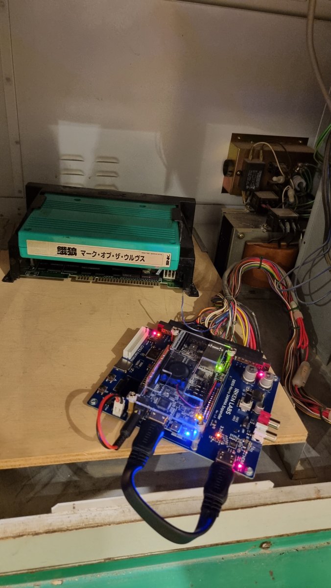

Anybody else running this in an Egret II cab? I can't adjust the voltage below 5.15, but it seems to work anyway. I think the issue is there is not enough "loading" on the 5V rail. Perhaps this could be corrected by adding a beefy resistor to the 5V rail to load it some more.
Finally got the chance to try the expander. The de10 kit took longer than expected to arrive. The first issue was the high voltage(5.41v). After dialing it down to 5.01v everything turned out well. The walk through in Irken's website is straightforward, noobs like me will get it sorted out in no time.
I only regret not getting another one when I got the chance. Hopefully it'll get restock soon.

ITT: people who need to buy a multimeter or a jamma adapter with a voltmeter on it, for their normal pcbs
100% agree. I always use the reco adapter even as a passtrough to adapt if necessary as the pcb you plug can vary on the 5v it draws.
Unfortunate that the reco is not available anymore for now because it is really so useful and perfect.
The Reco is super useful that way. I was diagnosing a problem with the Mistercade the other day, which needs 12v, and my Windy power supply was struggling to give enough juice. It's easy to check with a meter, but it was watching the voltage live on the Reco that confirmed the problem.
This is PGM from that same problem checking session, 12v steady there, but just a handy pic of the Reco.
@Mackie for just voltage measurement, JNX Atlas / Voltmeter is a fine substitute for the reco

@andynumbers you should run a stock egret2 psu on a 100v stepdown. I’m betting you aren’t, which is why you can’t dial its 5v output low enough.
Go figure. I got the thumbs up from Mike to run MS9s on 120v with no issue, but I didn't realize the stock PSU can't handle it. I already went to the trouble of removing my internal stepdown transformers. I think I'll just ditch the stock PSUs and switch to Meanwells or something.
