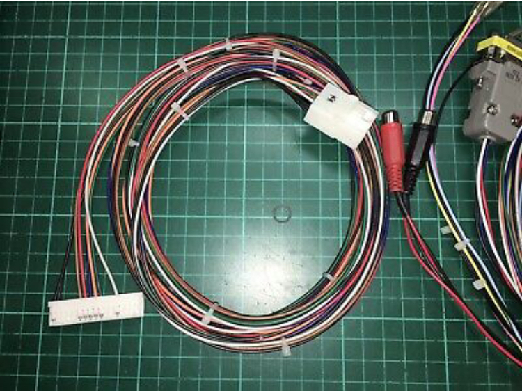

Anyways for both scenario you’ll need this, i.e amp10 connector on the panel side to cps2 kick harness connector on the expander :

As long as you're using the jammafier, JVS does not come into play.
You need a JST-XH to CPS2 kick harness, same as RGB HAS supergun.
The Jammafier has buttons 1-5 on jamma edge, and buttons 4-6 on kick, so in theory you only need to wire up button 6, but probably best to get one with buttons 4-6.
@invzim Thank you for the concise answer 👍 i'll get a kick harness made up.
And thanks everyone else that chimed in 😊
