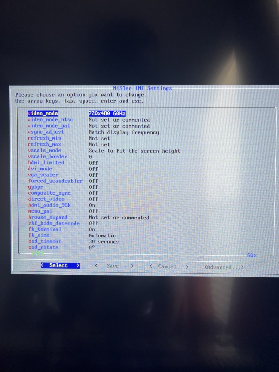

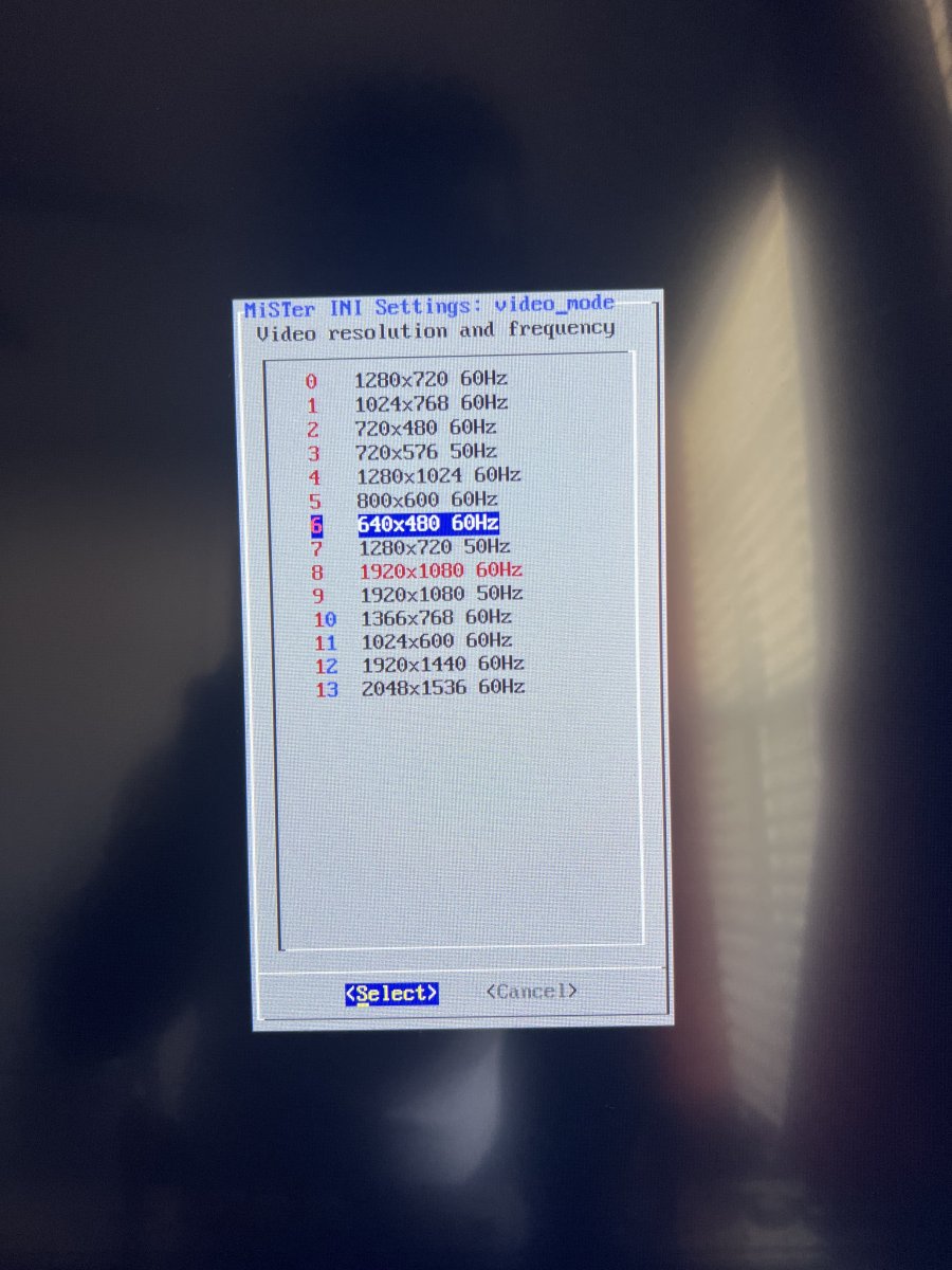

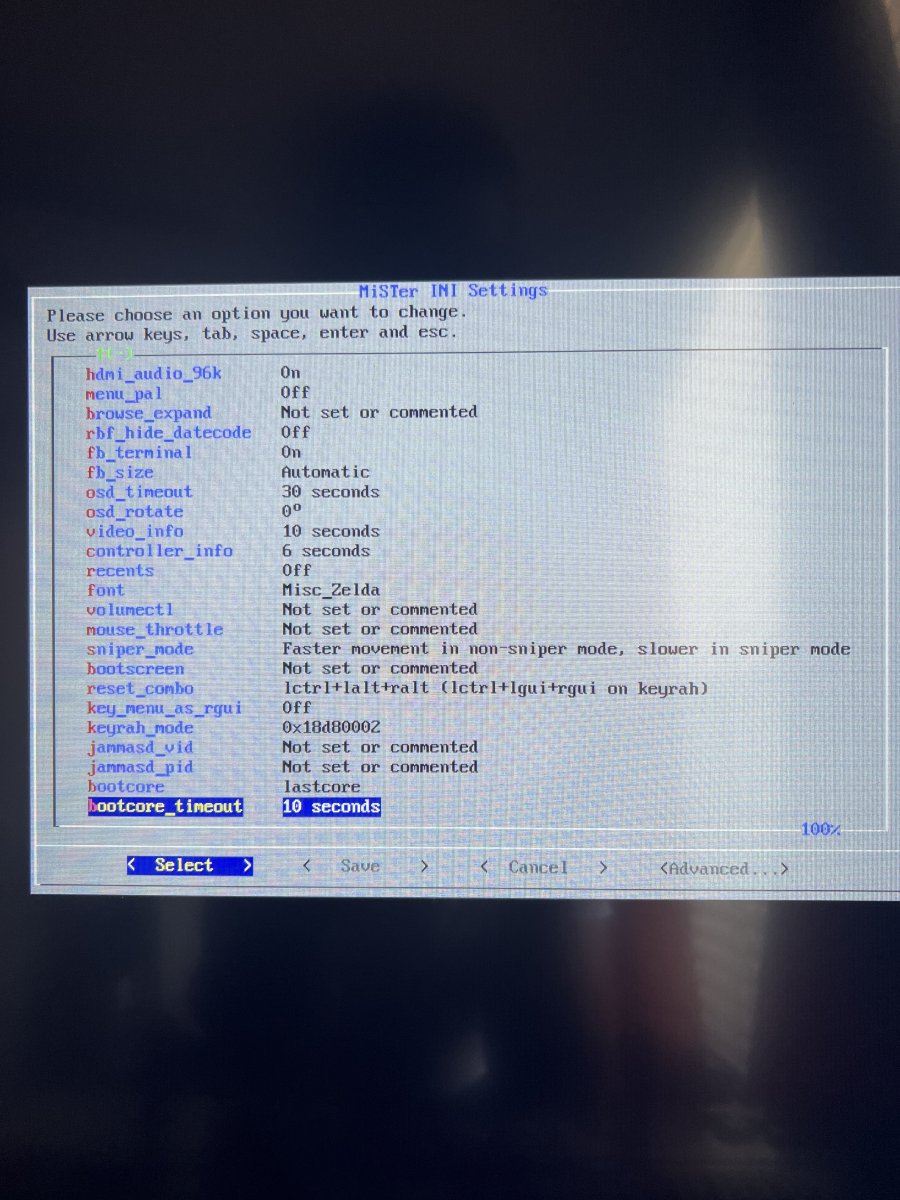

I have a quick question, my setup consists of the De10 nano and jpac2 on my vewlix Diamond black.
Im wondering what are the best settings for the video area on the mister like the resolution i should have it on. I have the stock 1080p monitor.
Here are my current settings which im sure are wrong.
If anyone can take a look i would appreciate it.
