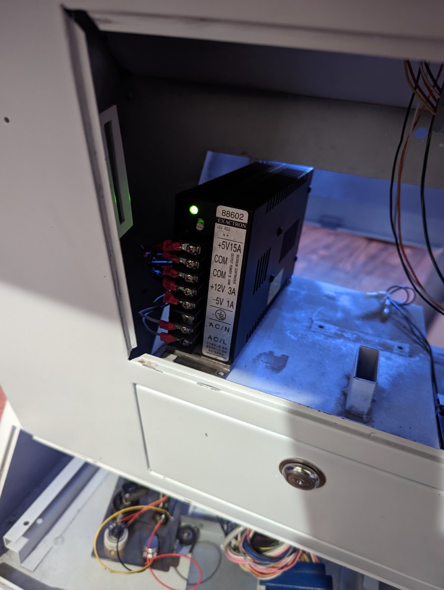

All I've done so far is replace the speakers, the right volume pot, and move the earth grounds to where they belong (thanks again @twistedsymphony ). I also spent some time spent attempting to figure out my video issue and the right speaker issue, but to no avail on either.

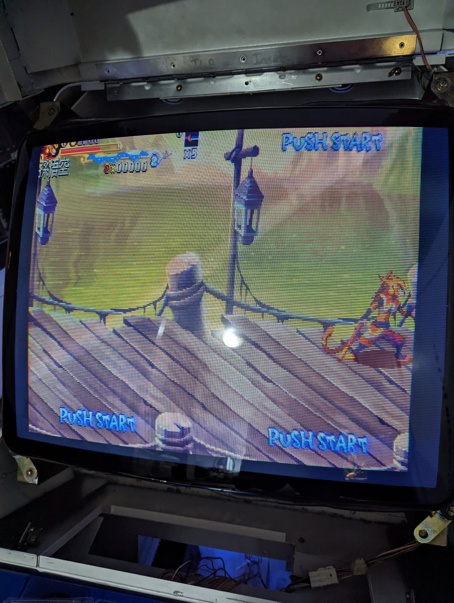

Well, put some spade connectors on the PSU lines (they'd just been bare wire clamped under the screws) and the monitor issue has cleared itself up.

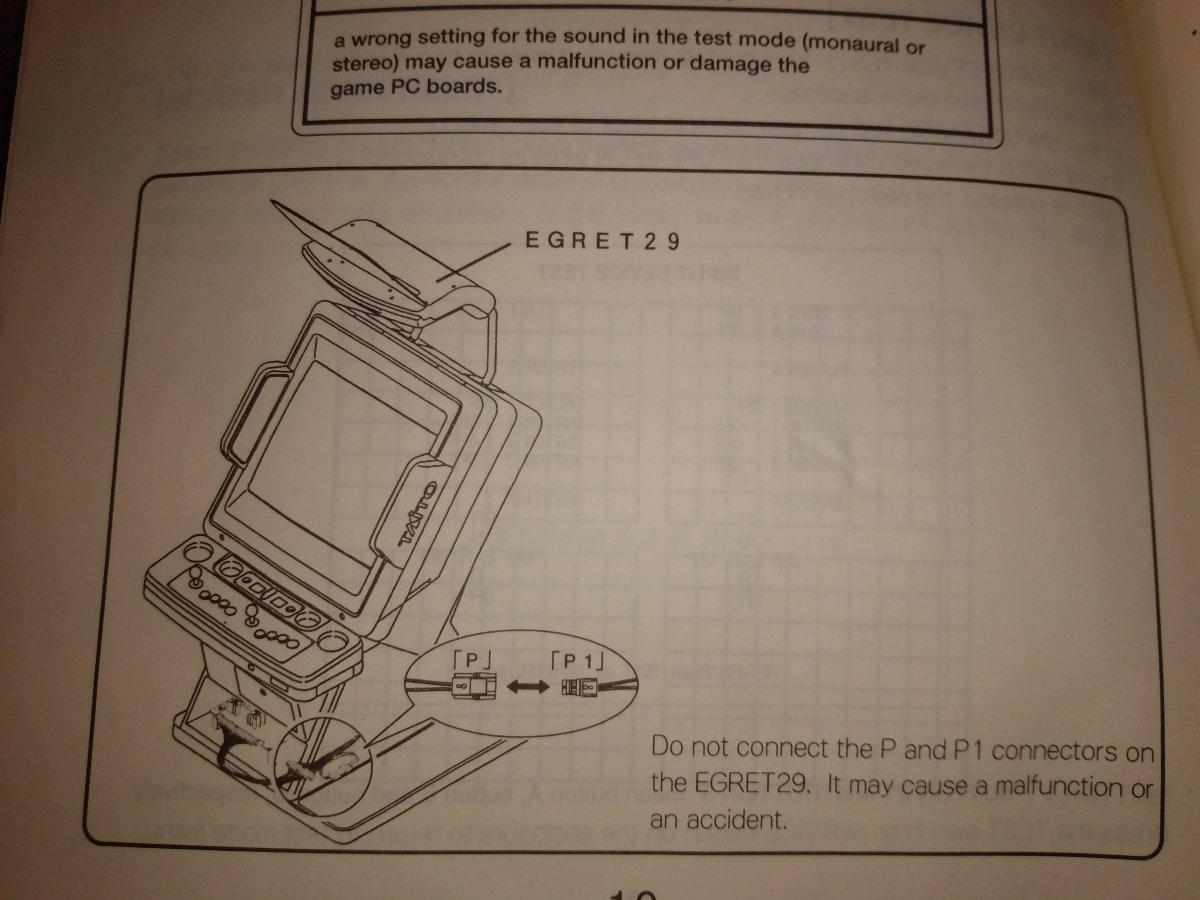

out of curiosity what are you using for a test PCB? and is the P-Connector connected or disconnected?
EDIT:
For Context the P-Connector is a few inches down stream of the W-Connector (the big blue connector just downstream of the JAMMA edge). it's a little white 2-pin connector that modifies the Audio wiring.
The Taito Game that support Stereo over JAMMA want the connector disconnected, here's a page out of the Psychic Force 2012 manual talking about it:
I'm honestly not sure that the wiring diagram from the E29 manual (like the one I have in my thread) really explains the P-Connector I believe it adds ground to the audio circuit when connected (separating the left and right in the diagram when disconnected).

P connector is indeed connected. It shows as connected in the schematic so I left it that way.

Well, dual mono. But still. Problem solved! So now it's just pop that in if I have a stereo over JAMMA Taito game I guess!
no no, disconnected is the desired configuration for Taito Stereo Over JAMMA. I leave mine disconnected 100% of the time.
the only time you'll ever have a problem is if the game leaves "speaker -" disconnected for some reason. Everything else will work.
