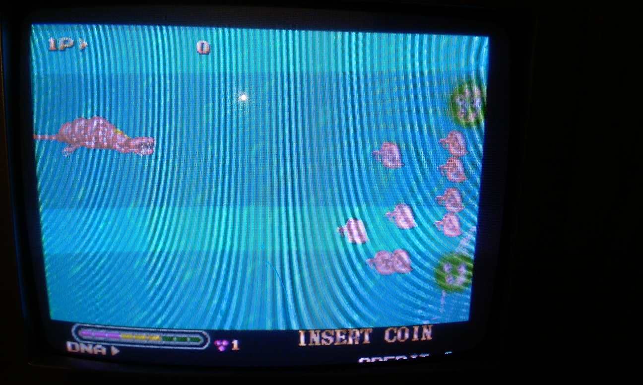

Hammy was nice enough to test out my Chimera Beast conversion and confirm that it runs on actual hardware.
I've posted the patched files for Chimera Beast and 64th Street A Detective Story in the first post.
So I guess now I start learning how to route a PCB to make a 4-in-1 Multi :P
Yep Runs perfect :)
