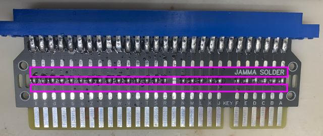

Hi @Frank_fjs, I am thinking 2 rows of drill holes between the traces should be added in the area highlighted above. The purpose is to allow for easier re-routing of wires. Instead of routing wires all the way around the side of the adapter, wires can be routed through the drill holes. In doing so, I think one of the edge routing slots can be removed making the adapter a little thinner. This will allow the adapter to have a bolt pushed through the edge card without touching adapter. What do you think?
I any case, so far this is fantastic. This going to be a project for @Segasonicfan Sync Cleaner Pro v1.0. I will be adding +5vdc meters for this to complete the aesthetic. As for bridging the solder jumpers, I had a little trouble with getting the blobs to connect. They would always dissect on their own. Perhaps it is JLCPCB's fab of the boards; perhaps the solder pads are too small. Never ran into this problem jumpering CSP2 B-boards or Infinikeys. But I found a technique that worked and I'll pass it on to anyone:
  1. Apply iron to both solder pads at a time
  2. Add solder until a bridged blob forms
  3. Then the key is to lift the iron off the pad first
  4. Then in rapid succession, remove solder before solder solidifies
So a boom-boom 1-2 motion with lifting the iron and solder from the jumper pads is all that is needed to form a bridged solder blob. Pics when this is done.

I like the idea of the drill holes. I'll see if I can add them without jeopardizing the trace work. Any suggestions for diameter? How large should the holes be to accommodate pushing wire through?
Re the solder jumpers, I can move them closer together perhaps, to make bridging easier.

What about a pin header? This would make rerouting even more convenient?!
Just big enough without eating into the traces. Ideal diameter would be to accommodate this wire with a diameter of 0.0253". Oval holes would be best to allow for more than one wire in a single hole. Most applications will use kynar wire which a hole of this size will be overkill anyway.
Its fine. Might be my solder equipment or JLCPCB's fabrication.

Oh, with the drill holes in place, the routing slots towards the outer edge become less important. Removing one of the routing slots allows the adapter to be less wide. A user can then shove a bolt through the adapter and bolt it to the JAMMA harness so it doesn't come loose during PCB switching.
