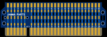

today I played a bit around with easyEDA. Since I like to make some adapters I tried my best to modify yours to my needs (adding holes for a volt meter). Here it is:
As you can see I also used feedback provided by @acblunden2 to improve it:
Hi @Frank_fjs, I am thinking 2 rows of drill holes between the traces should be added in the area highlighted above. The purpose is to allow for easier re-routing of wires. Instead of routing wires all the way around the side of the adapter, wires can be routed through the drill holes. In doing so, I think one of the edge routing slots can be removed making the adapter a little thinner. This will allow the adapter to have a bolt pushed through the edge card without touching adapter. What do you think?
Since this is the first time I have done something with PCBs and easyEDA I'm not sure if everything is fine and if it will work? Feedback is highly welcome!
For course im happy to share the easyEDA and Gerber files when I'm finished. If someone needs them to verify my work I'll PM them and I'll upload them when finished. I hope everyone understand that I don't want to publish unfinished PCBs.
Thanks in advance for every feedback ^^

It looks fine to me, well done!
I like the wiring holes too, nice touch.
Thanks for offering to share it back, that's the spirit!

Thank you very much for verification!
Here are my files, feel free to use them for yourself :thumbup:
Please keep in mind that I'm not responsible for any harm this adapter does to you or your hardware. You can use my design at your own risk!
This work is licensed under a Creative Commons Attribution-NonCommercial 3.0 Unported License.

Oh one more question @Frank_fjs: are the pads far enough away form each other so no electricity can "jump" form one pad to the other?

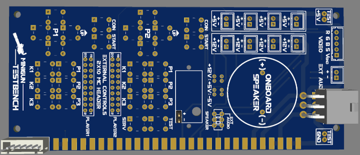

I've been fiddling with Easy EDA a lot lately too, pivoting off of Frank's work. Getting better with it (I think). Working on this right now:
Just want my test bench to be uncluttered. The one I've used for so long has just been a stripped out harness from a cab. I put a 3P3T switch for all 3 voltages. A hole for calibrating the meter. A DPDT switch for onboard audio to output to an external speaker or to attenuate the signal for the onboard speaker. Test points for a probe. Extra +5v and +12v connections. Ability to use external controls. Most importantly, momentary switches for signal inputs.

I have seen your work in an other thread, I really like it! It’s a good idea such an easy and clean test board!
