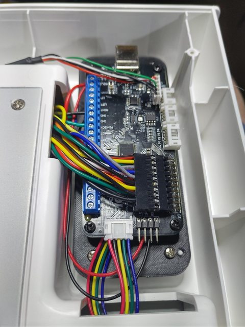

I have a Sega Astro City mini stick and as we all know there is only a Select (credit) button and a Start button. I wanted to mod it with a Brook UFB but also incorporate a Guide/PS Home button without having to install additional buttons.

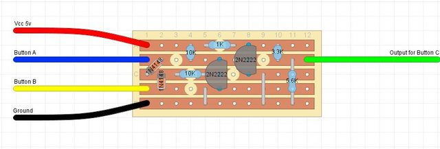

An additional small circuit using a few common components can be made for this to work on all common ground boards. All credit goes to the gentleman here who helped me out with the circuit - https://electronics.stackexchange.c...uttons-to-trigger-third-input-using-common-gr
After confirming the circuit worked on a breadboard, I measured the voltage across the buttons on the UFB, which is around 3v-3.2v. From testing an Xbox controller too, this seems to be fairly common.
As the circuit is driven by the 5v from the USB connection, an additional two resistors are needed on the output to make basic divider circuit to drop the voltage from 5v to 3v. This may not have been necessary but I didn't want to take any chances. Anyways, I ended up using 3.3k and 5.6k resistors. A calculator can be found here - https://ohmslawcalculator.com/voltage-divider-calculator
Here is the end result of the complete circuit layout I designed on veroboard.
