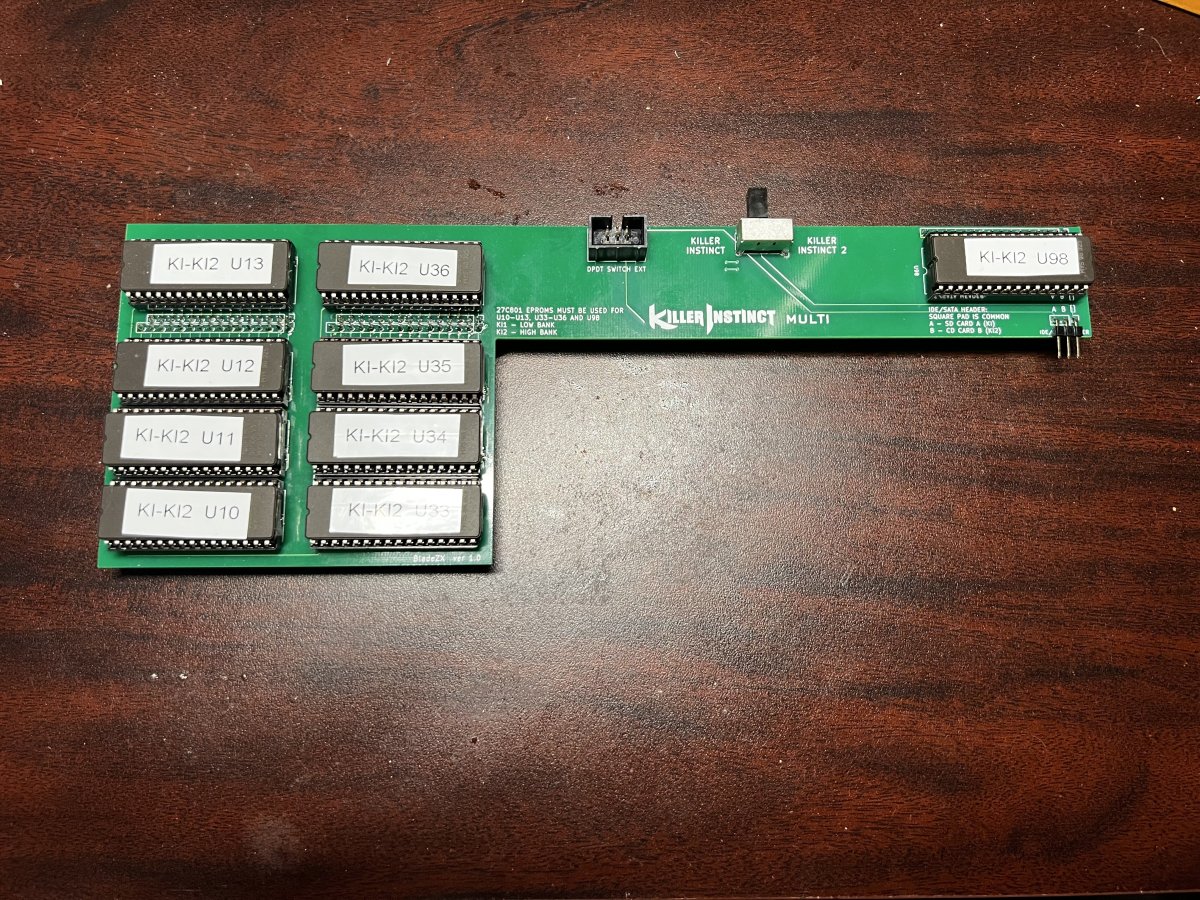

Killer Instinct Dual Board
Leaving post for interest I have both boards. If I can be of any assistance to this project let me know.
Almost ready to test

For the switch it is best to use an ON-OFF-ON switch in case you want to make use of the ribbon extension to locate the switch elsewhere on the cabinet
You would them need to make sure the switch on the pcb is OFF
OR just do not install the switch on the pcb
I will not be selling the boards but I will post the files for you to have your own manufactured
