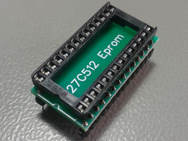

Anyone know where to get some good 32pin sockets that will mount on the add-on board and extend down long enough to plug into the sockets on the KI pcb
I would be surprised if sockets like that are a thing (at least for anything that isn't machined pin). I think you will need to place separate pin headers on the PCB, like this
or, bump up to M27C160s which will make it much cheaper than sourcing a bunch of 27c080s
Yea crap - I will need to do this
