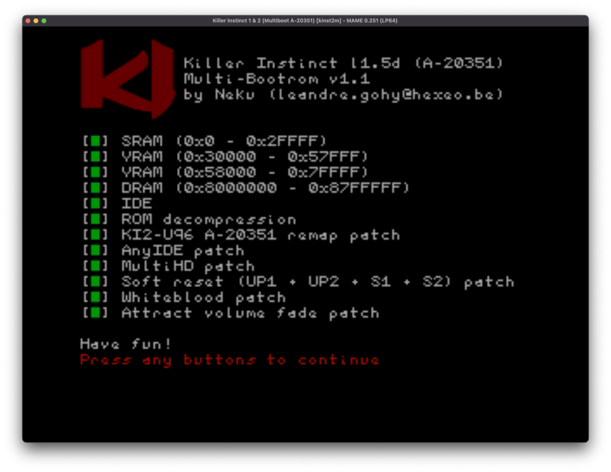

Hello,
Here's a small update.
I have ordered a first batch of a prototype of the bank switch PCB. Waiting to receive it to make some tests with it.
I already have some idea of improvements to be done to that board but the general idea won't change.
I have also added IDE connection self-test check, the test is not validating any checksums yet but the presence of an IDE drive properly connected.
One last thing, i have improved the bootscreen and game version selection screen.
The KI1 and KI2 characters displayed on the game version selection screen are random and match their respective game version.
Source of the sprites : https://www.deviantart.com/blzofozz/art/Microsoft-KI-668294406
