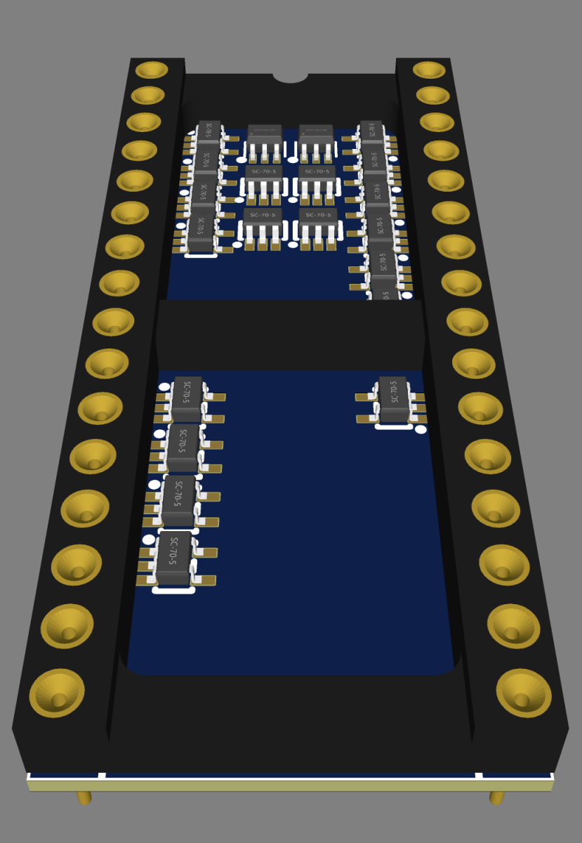

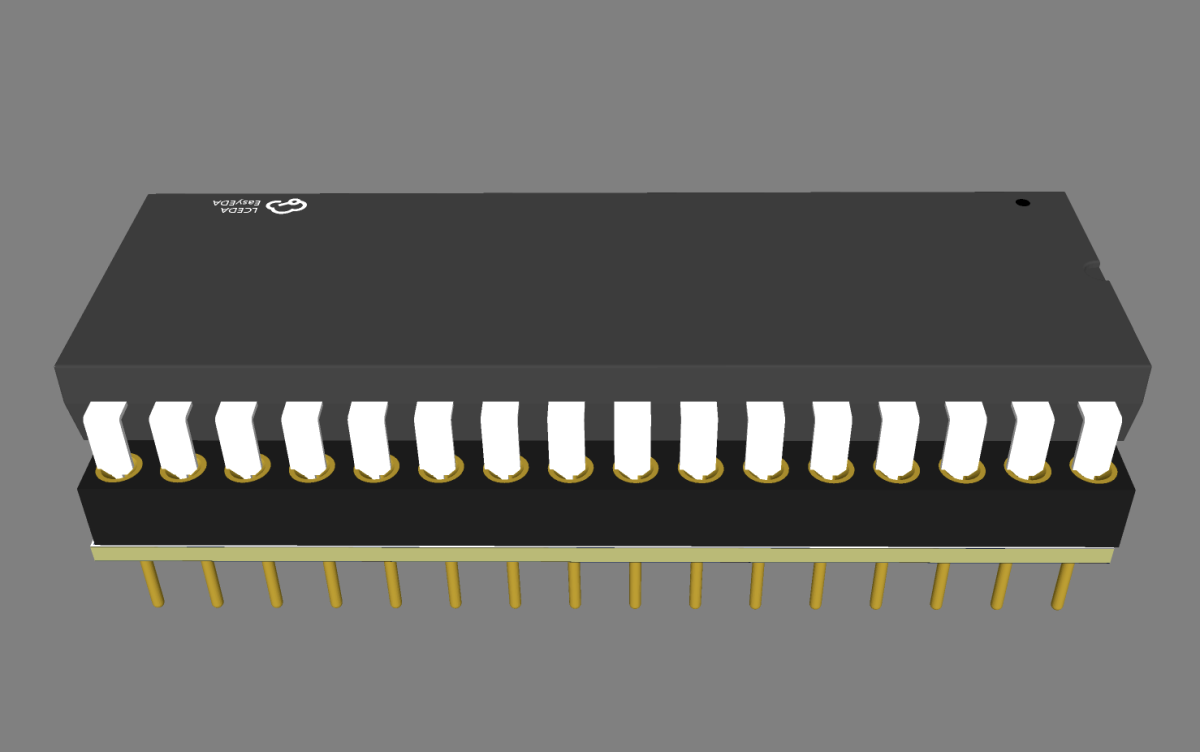

Here's some renders of my idea about the soft multiboot ROM adapter for U98.
Sound ROMs would have the same kind of adapter but without any additional electronics.
What do you think of it ?
I am waiting for your feedbacks then i will probably order a first batch as prototype.
Now going to work on the IDE adapter (idea there is to intercept Head/Cylinder/Sector address and offset it for the second game so we could use one drive for both of it)

Sorry, I’m really interested but I don’t understand what it does. It looks like a bunch of voltage regulators stuffed underneath a machine pin socket. “Software multi boot” sounds like the software would pick the bank to boot from but I don’t know why you’d need a hardware solution for that. But you’re clearly a wizard so please explain to me what’s going on.
Also for what it’s worth when I build stuff like this myself I use dual-wipe sockets instead of machine pin. It holds the EPROMs better!
It's a bunch of logic gates NAND, AND & NOR forming a SR Latch circuit.
Two specific addresses on the ROM are used to control the SR Latch controlling the High/Low signal on A19 of the 8 Mbits EEPROM.
This is reason i am calling it soft, event though there is an hardware part to it, the switching of the upper/lower bank is controlled in software in contrast to the current solution requiring to flip a switch. I am abusing the memory address lines as control lines.
Regarding the type of socket, i had a lot of trouble finding a part with long enough legs to pass through the 0.8mm PCB and still be long enough to hold into the board socket.
An other solution i have thought of is to use sockets strip line and then solder an SMD dual wipe socket on the PCB but i was not able to find stock of the strip lines.
