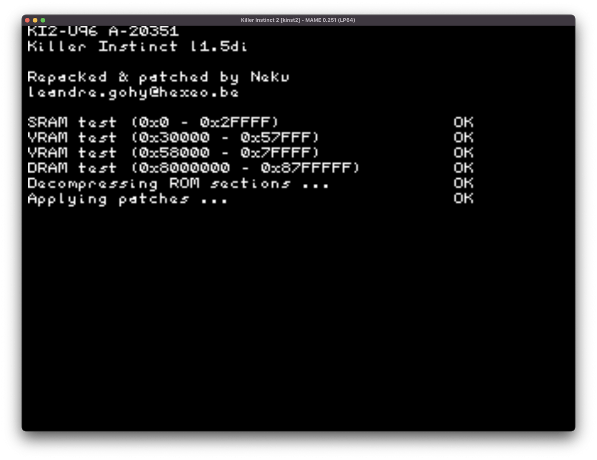

Yesterday evening, I worked on making a font and writing a print function in the boot rom and this afternoon on self test, here's a quick peek at the result.
The following test are implemented and working:
- SRAM
- VRAM framebuffer 0
- VRAM framebuffer 1
- DRAM
For the moment if a test fails it will display NOK instead of OK, later when i know each chip memory range it will display the chip ID (Uxx as labeled on the board) if failing.
In the screenshot, on first and second line is displayed respectively the board identifier (based on U96 label) the boot rom is compiled for and the game rom version
