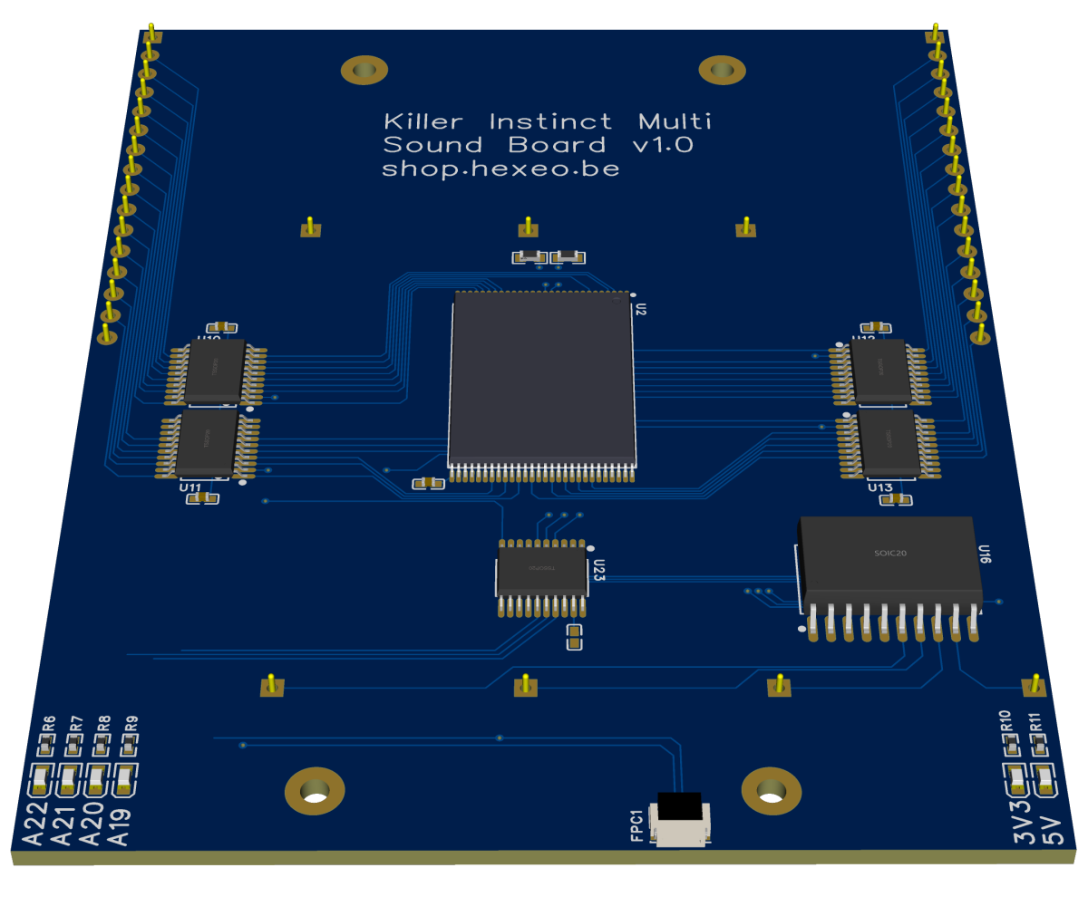

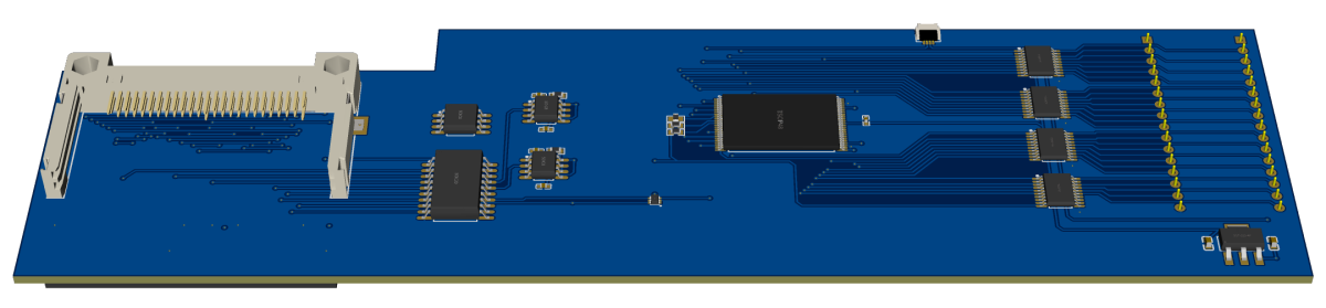

This is not the final design but I would like to hear what are your thoughts about this.

We are miles away from a stealth mod like your previous prototype here ! I'm still in the OEM look philosophy and I don't like these huge pcbs hiding the original hardware (sorry 😅).
A sandwich pcb in the HD area, with high and low signal to drive the daisy chain, would be a great improvement for a modded board or simply another option! 😉

By the way the new PCBs are not so big, the sound board is the exact size of the surface area of all the sound roms sockets, hiding nothing but the sockets.

I would appreciate some through -holes to add support. IF the KI board has holes that we can line up. for proper stand-offs that'd be good, but even not just being able to add a support peg on a empty spot on the main board to help keep the sub boards from flexing that'd be good too.
That's already planed, support hole will be added, like you said, to avoid the pcb the bent where it's floating.
I would appreciate the option to run a DOM instead of a CF card. they're more expensive but they're faster and more reliable and I'm running DOM instead of CF on every HDD game I own when possible.
I will add a 44 pins connector in addition to the CF connector. So it's up to you to choose which one you want to use.

I know it's just a render but for PCBs I usually like the multi to match the color of the main board, or be black (since black goes with everything). I tend to find other colored PCBs paired with a green mobo to look tacky.
So far i am planning to produce the PCBs in black (even the small flat cable connecting to two boards) unless there is a strong demand for an other color.

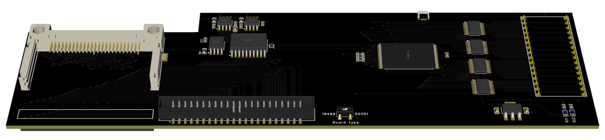

Hello,
Quick update.
Here's a new render of the control board (IDE + Bootrom) PCB.
You can notice few changes:
- 44 pins connector added to allow to plug a DoM or original HDD.
- LEDs to show which game is active
- A dipswitch to select the board type
The control boards will come with a 16Mbits flash memory to store the bootroms that way i can store the roms for ki1 & ki2 for both type of motherboards making it universal.

Looks great. Appreciate all the work and effort gone into this.
Any idea of a time frame for release? Its been so long since I played killer instinct 1, this would make my Christmas :)
