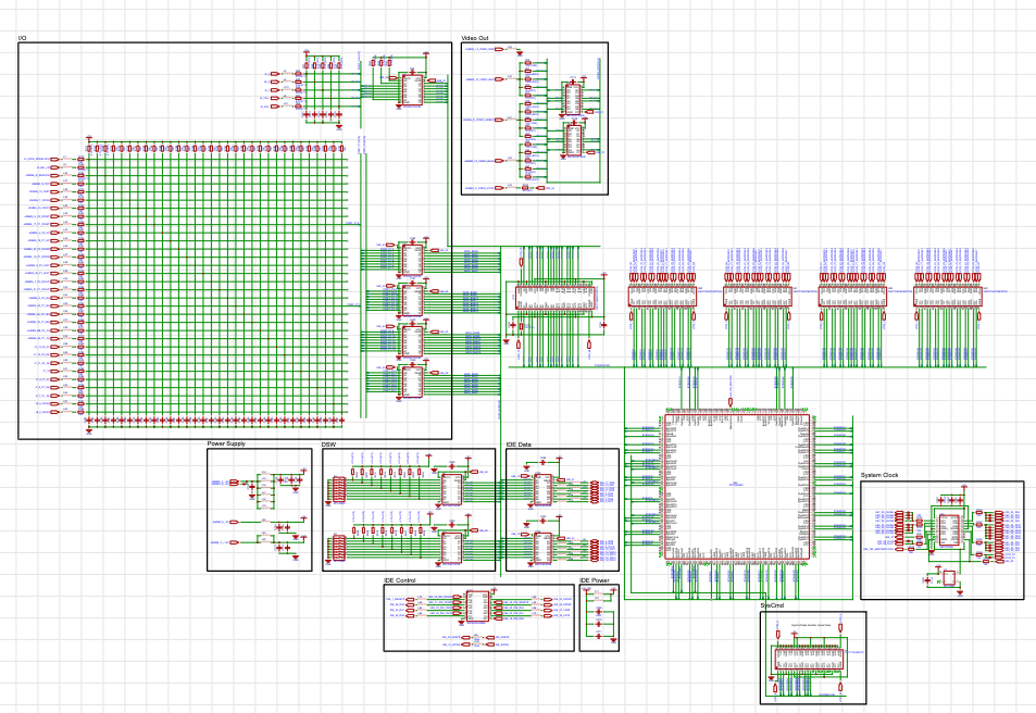

In the mean time i have continued to work on the reverse engineering of the KI board.
I may have some good news later for those with dead boards as i may have a solution to swap the CPU for a different model with an adapter.
I will also try to rewrite the VHDL for U92 (Clock Controller ?), U103 (Memory I/O Controller), U104 (EEPROM Controller)
I followed suggestions and i created a Patreon : https://patreon.com/user?u=19643365 (I hope you don't mind i post it here)
It's empty for now, but i will take some time this week-end to start posting.
Here's a quick peek into the schematic so far:
Hello, @neku , is it possible to make this diagram available in high definition? Congratulations on your work and I'm counting on us for the tests too.
