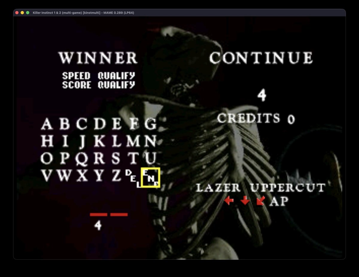

NiceHello guys,
Do you see something unusual on this screenshot ?
KI1.5d
d@0x88027D8C=0x0e00a263
d@0x88027DB0=0x0e00a263
d@0x880285A4=0x0e00a287
d@0x880285C0=0x0e00a287
KI1.5di
d@0x88027C7C=0x0E00A21F
d@0x88027CA0=0x0E00A21F
d@0x88028494=0x0E00A243
d@0x880284B0=0x0E00A243
Unused gfx?Hello guys,

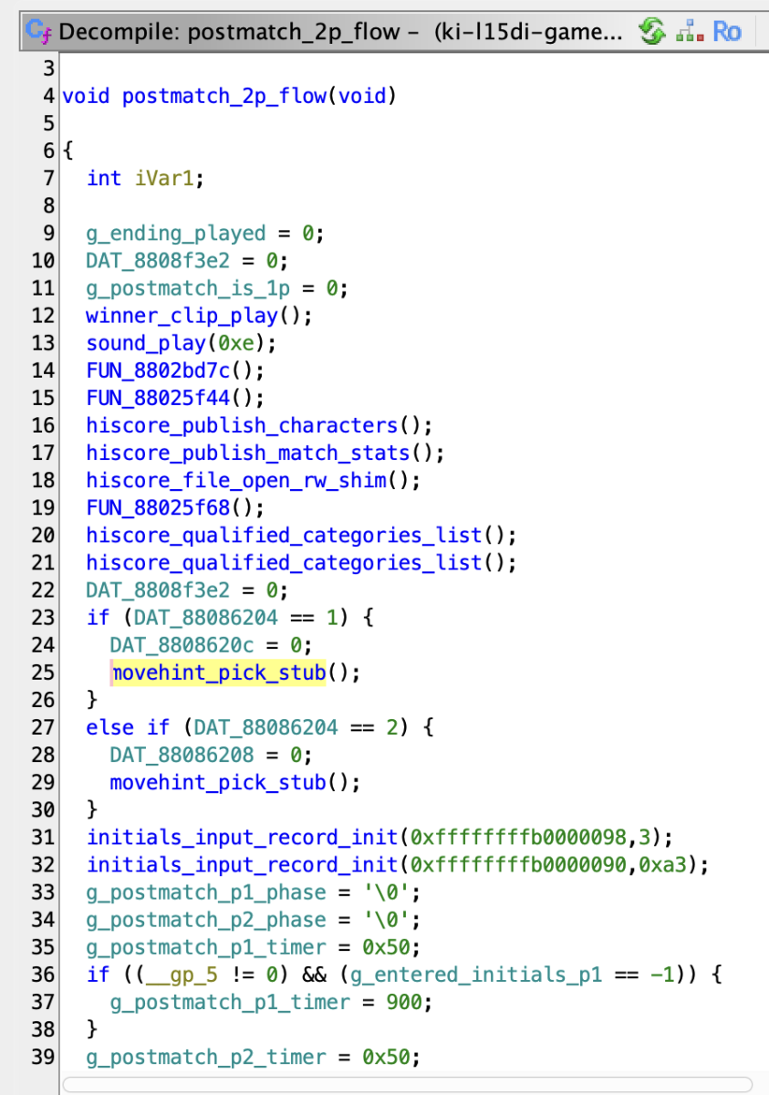

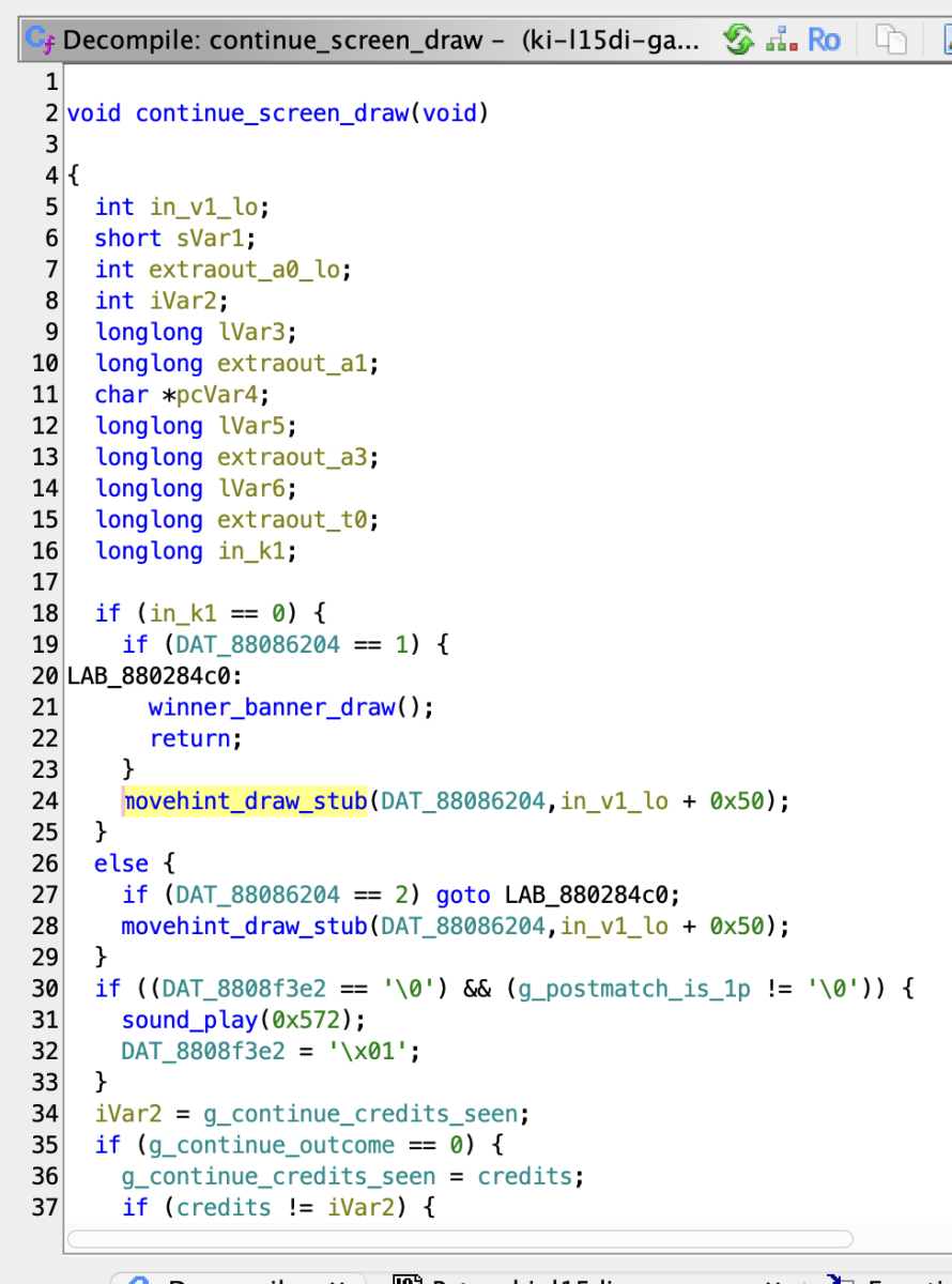

The game contains code to display two types of hint when losing a game.Unused gfx?
Excellent work; I really think there are still more hidden things that haven't been enabled.The game contains code to display two types of hint when losing a game.
- Generic hints
- Special moves about the character you lost with (3 of it)
The code was disabled in the final release of the game by returning immediately in the pick/draw hint functions.
