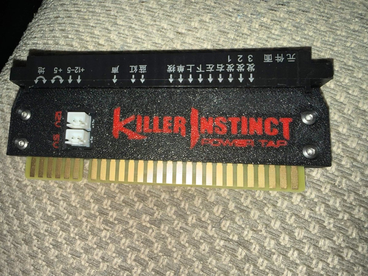

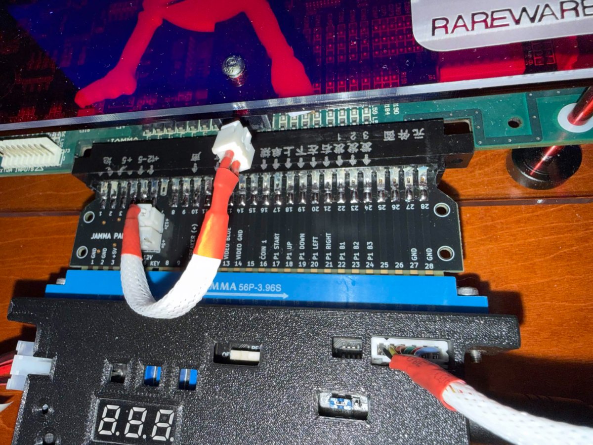

Alright, final PCB is here and tested. I spent all day Sunday figuring out what was wrong with my Kick harness. 1 day lost due to a few pins being crushed during crimping. Oh well. That's fixed and everything works fine, including the Fan, which is what this PCB is. If you're tired of soldering a fan to some location on these arcade PCBs, then this is for you. It's a 5V and 12V breakout to hook up standard fans. I believe most fans have the JST connectors to directly hook up without any modifications (like mine did but I needed an extension due to the way I routed my wire). I'm making a shell, of course, but with this completed, I will start getting some kits together for what I have leftover, along with a full writeup on this MOD.

Here's a bonus that I made over the weekend to tide you over until all is done. Made a shell for the Power tap.

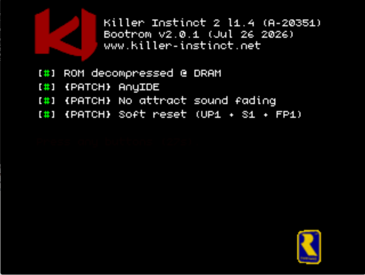

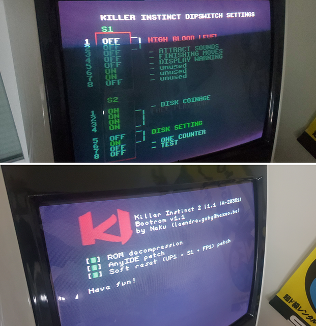

I burned 20351-ki2-l11.u98
I have the BootRom v1.1 menu on boot.
My dipswitch 6 and 7 are ON (S1) but the loop the music in attract mode doesn't works.

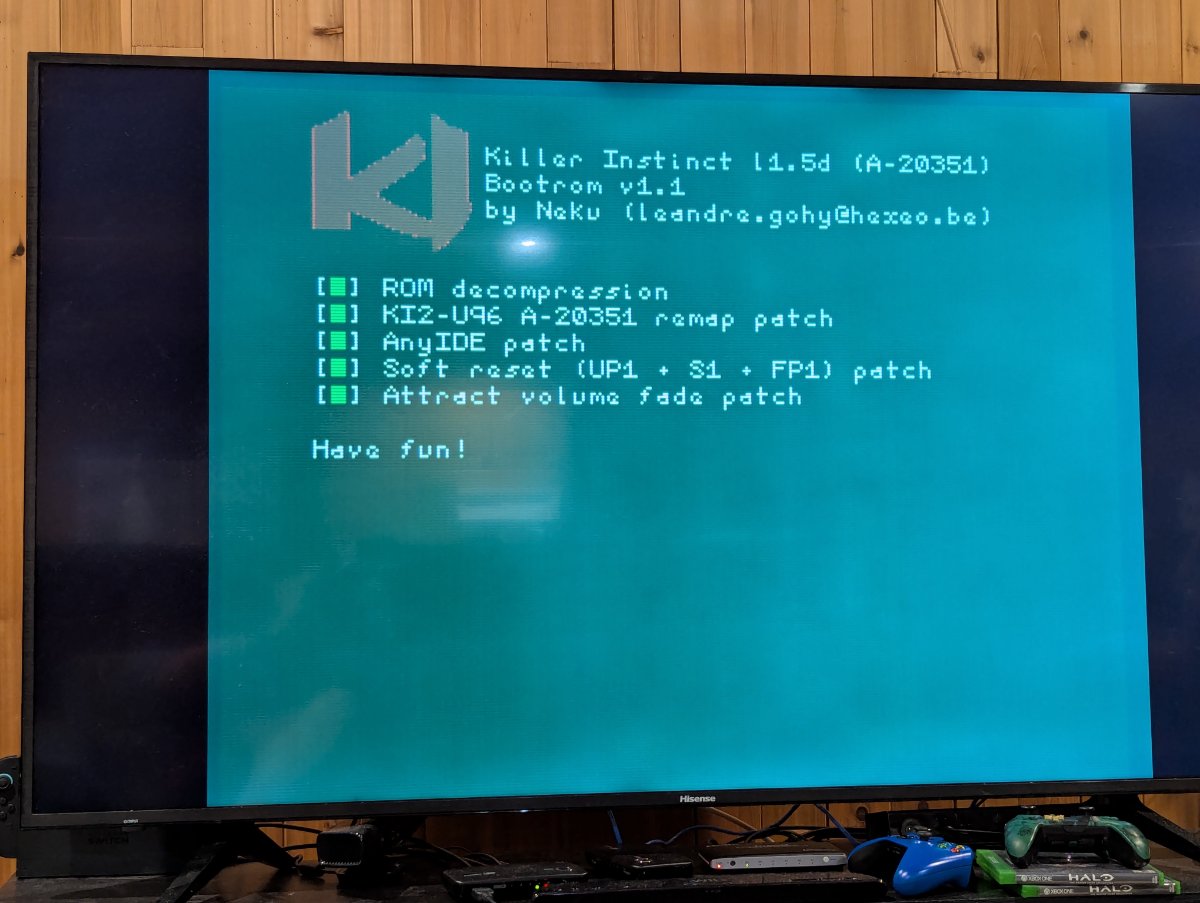

From my usage the boot screen would list it as "Attract volume fade patch" if it was enabled. Try burning a different rom?
I was able to successfully boot Killer Instinct 1.5d on my KI2 board using these patches.

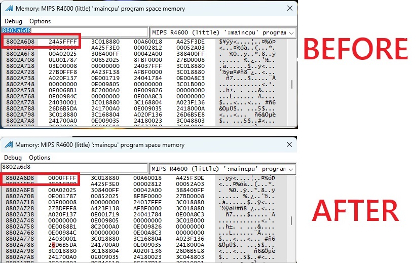

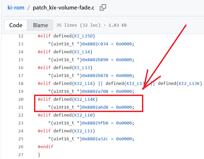

I used MAME -debug and launched KI2 with KI2_L14K.u98.
I modded 0x8802a6d8 = 0x0000 like here and the musique not disparaite in Attrack Mode.
Great, but now I want to mod the ROM (.u98 )... :/

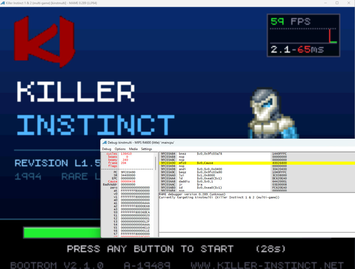

On the multiboot side, the hardware is still cooking, but here's the exciting part: starting today, you can grab the 2.1.0-multiboot beta bootrom along with a modified MAME binary (Windows x64/arm64, Linux x64, macOS arm64) straight from the website!
Just hit the soft reset combination (UP + START + FP) to bring up the selection menu.
And it gets better, 2.1.0-multiboot beta ships with a brand new redesigned bootstreen and a completely reworked multiboot selection menu. I can't wait for you all to see it!
Give it a spin and let me know what you think :)

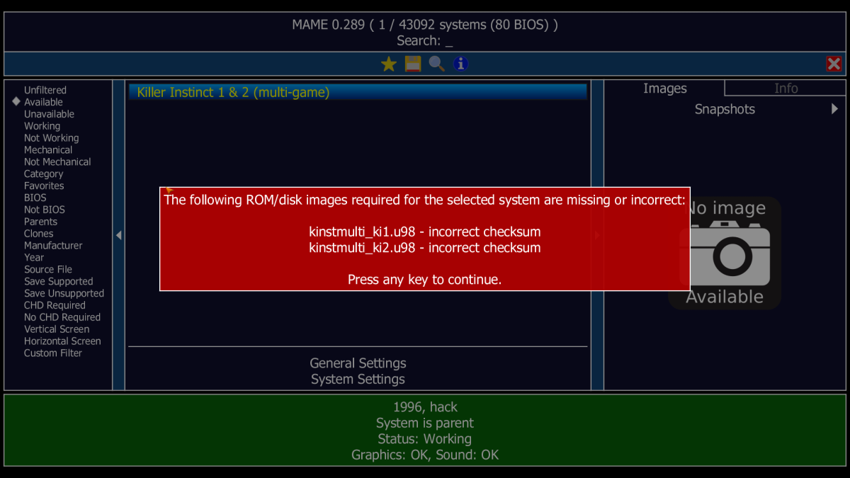

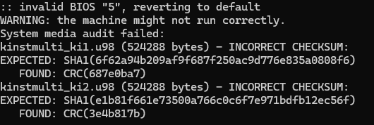

Hi,
Thanks for all !
An error when I launch mame-windows-x64.exe :
Launch it with the following parameters
mame-windows-x64.exe kinstmulti -skip_gameinfo
it should work, i'll add the CRC values to the binary to avoid that message and republish
