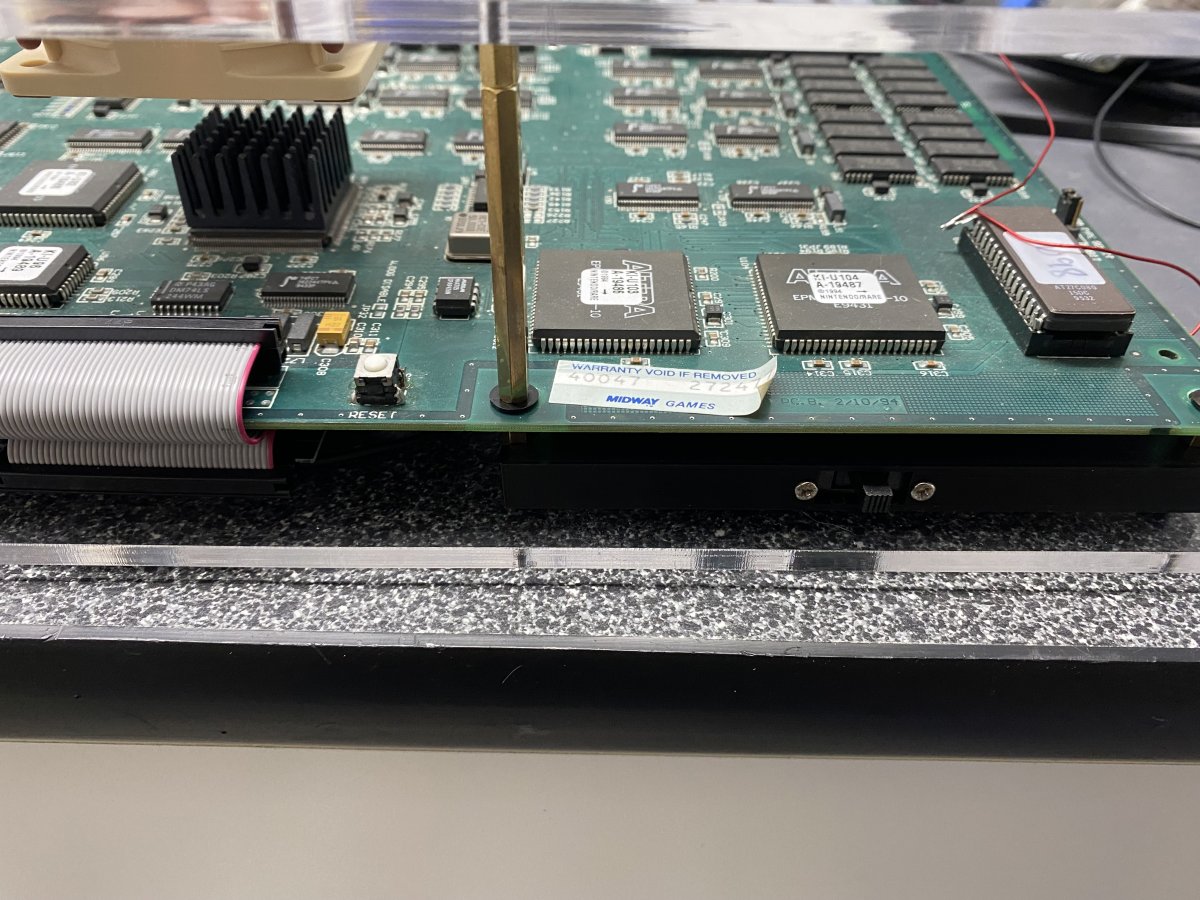

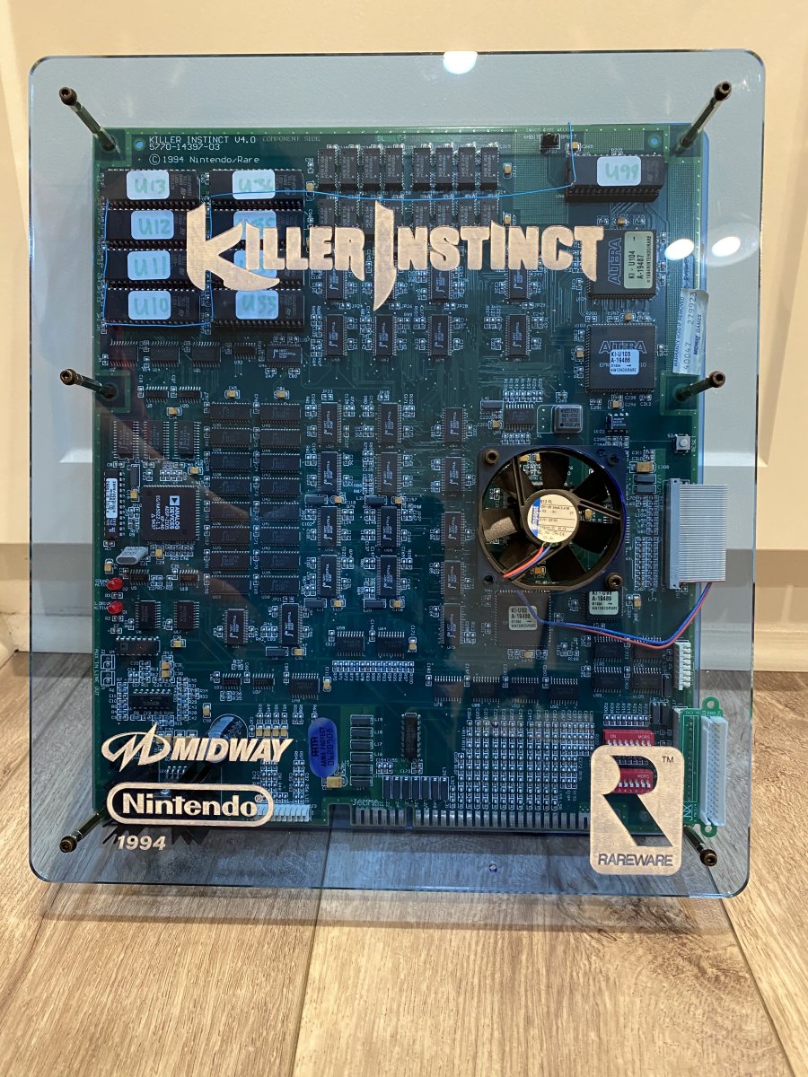

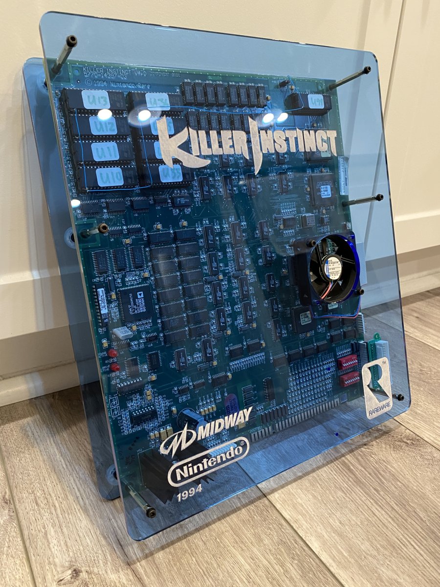

Not as pro looking as @luke7110 - but its functional! I also used his 3d printed switch holder and it works perfectly!
15mm for the bottom spacers, 55mm for the top (wanted enough room for the Noctua).
