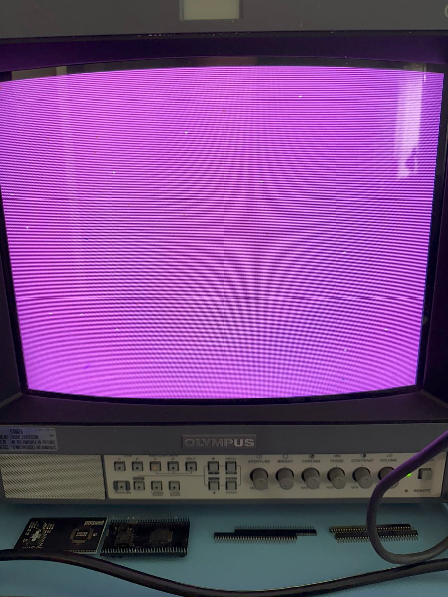

The board came to me with an original hard drive and the boot rom [U98] had a broken/missing window on it. When booted the disk drive started to spin up and I hear one BONG followed by the SOUND ACTIVE light coming on. The D. DRIVE ACTIVE light comes on without the drive, and stays off with the drive attached (it seems it may flicker initially then turn off, probably once it sees the drive is there). In all test scenarios I end up with a pink screen with colored dots (kind of like sprinkles on a delicious pink cupcake of death), and the position and color of the dots are always in the same locations. Pressing Test/Service doesn't seem to do anything either.

Any other ideas let me know. It could be the CPU but I figured I'd ask since I don't seem to see the white lines screen like everyone with a bad CPU seems to mention -- also it isn't clear if those with CPU problems get any activity at all, like the BONG or disk lights, so maybe I lucked out there? The CPU heatsink gets hot after a minute or two, but not too hot to touch and everyone always says it normally gets really hot so that may be normal.
