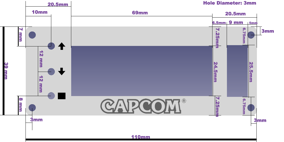

Hey Pablo or anyone that knows this
do you have the correct dimensions for the LCD and buttons
I with to make my own mount and need the dimensions for the cutouts for LCD, buttons and the mounting holes please

Necrobumping an old thread, but I needed the LCD measurements myself for laser cutting a Plexiglass window. Here's the results of some digital caliper measurements and some l33t Photoshop skills:

I think he meant he needed the measurements, so he measured his LCD with a caliper and was posting them in case anyone else needed them.
Yes, that's it exactly. Posting my measurements for the future benefit of others. I tried working with the 3D case measurements in SketchUp and it was a PITA for me.
