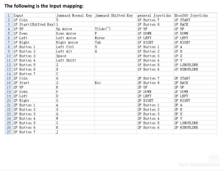

Hello, I'm the producer of SQArcade. If you have any questions during use, please consult me. Thank you.
Purchased an adapter from SQ Arcade. Thanks to @MickyMac I got it working with Groovymame. I would also love to know what all of the jumpers do.
@Arcade_Lover can you please answer us? We need the ESC key working so we can exit games.
in keyboard mode, Press the 1P key for more than 3 seconds to switch to the keyboard shift mode, where there is esc key.
