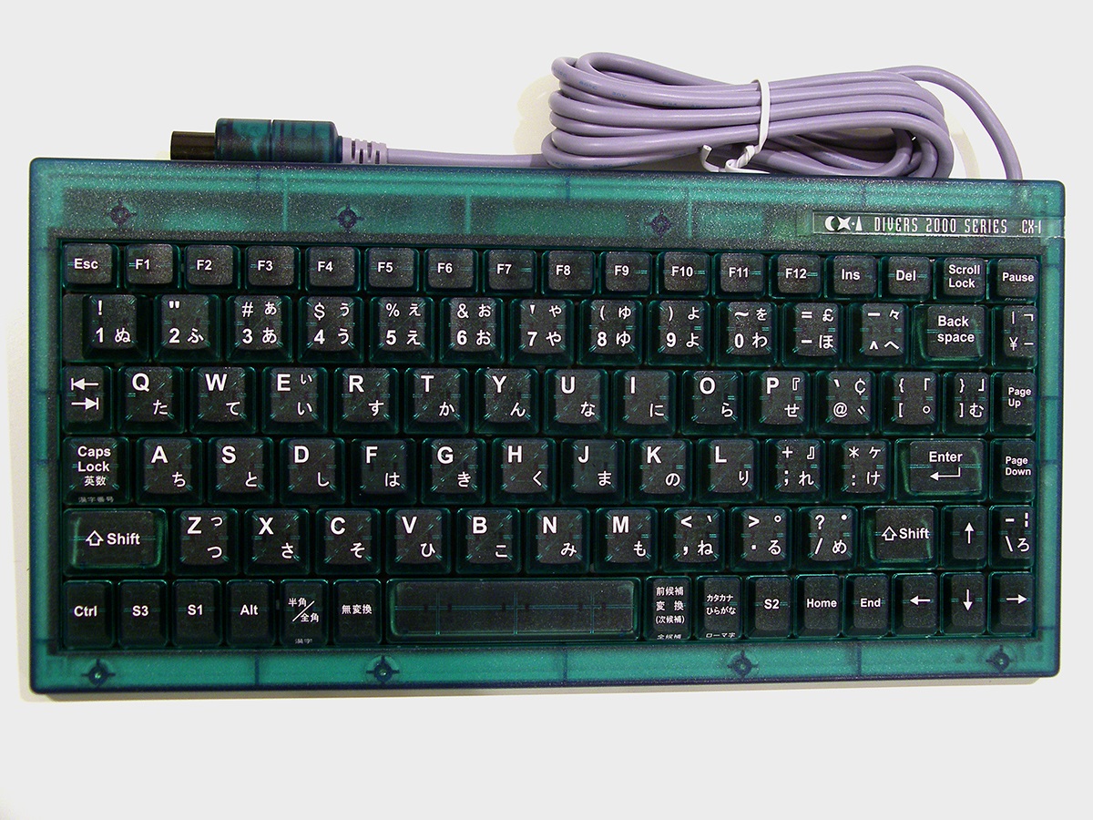

Okay actually you can enter the apostrophe. But you have to type shift + 7 to enter it.
Here's why, apparently the game is expecting the smaller "Divers" style keyboard instead of the full SegaNet keyboard.
That's actually the Japanese keyboard layout. double quote is shift+2 and single quote is shift+7. it's the exact same layout as the "full-sized" (tenkeyless) Japanese DC keyboards.
PC keyboards typically send the appropriate code for whatever letter you pushed so different layouts are interpreted by the PC the same way. but it seems as though the NAOMI is literally just looking for a key number and doesn't understand the difference in layouts.
I wouldn't be heartbroken if we just stripped the apostrophes from the game altogether.
I was thinking one solution is to replace the apostrophes with colons, since it would match up to apostrophe for a US keyboard, but I believe you'd see a colon on screen and that would be confusing.
