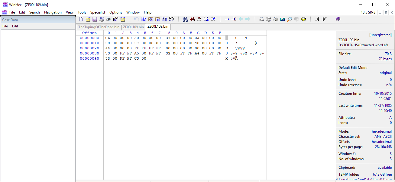

Some of the dictionary BIN files are the same size and can be found directly in the Naomi BIN and easily replaced.

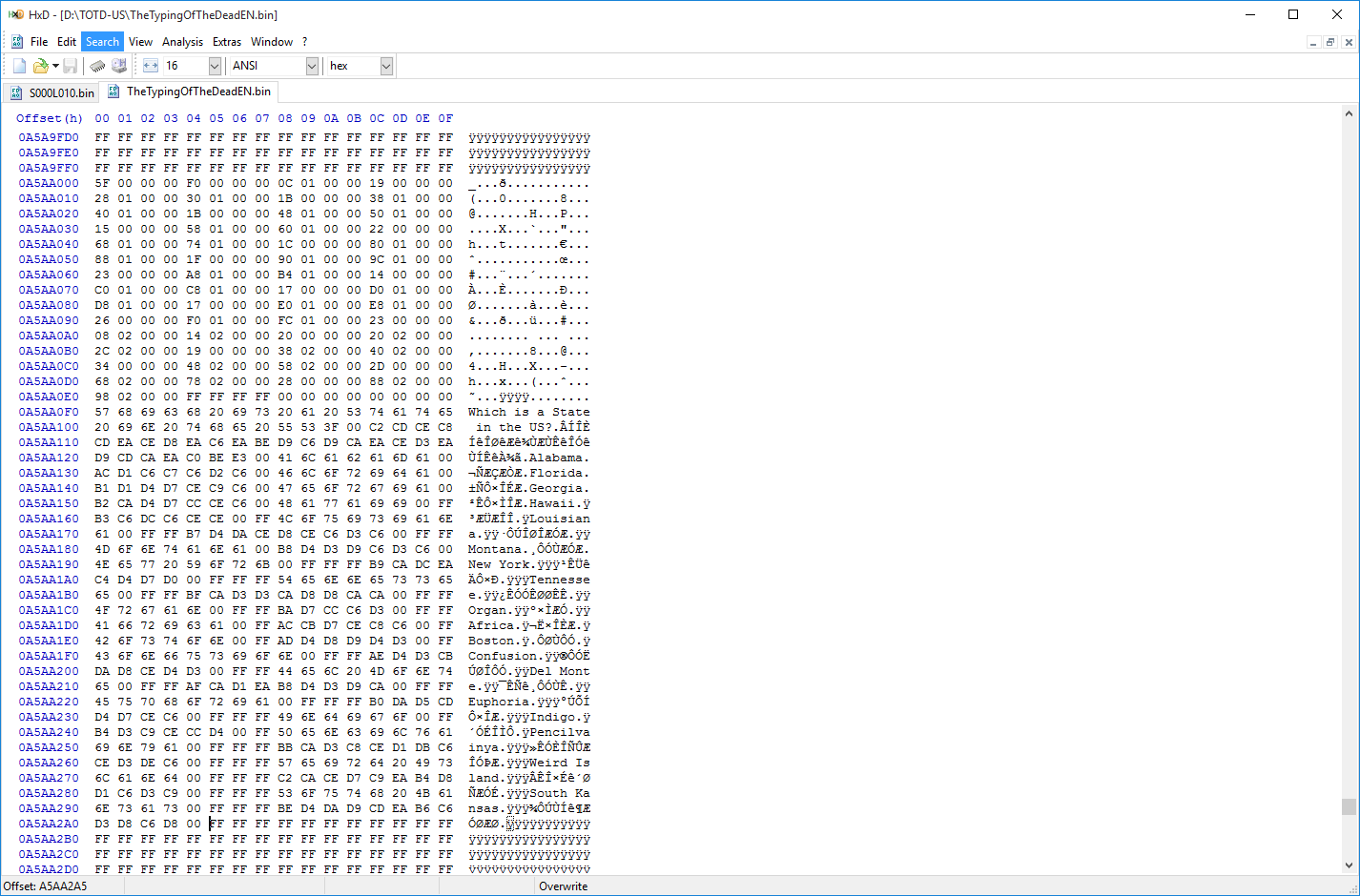

Also, it looks like there is plenty of FF padding around the BIN files in the Naomi binary so we may be able to just drop in the larger files like so.

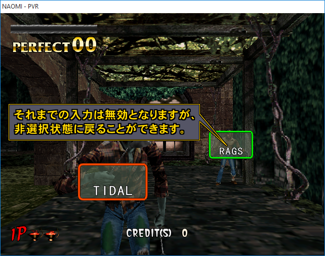

Another thing I noticed in your image is that the upper text comes through blank. In the Japanese version the upper text is Kanji/Katakana/Hiragana with the lower text in Romanji, but in the English versions the English word is just repeated. I'm wondering if the NAOMI game code is looking at a different location within the bin for the different versions of the same word while the English version only lists the word once. I'm wondering if this difference can be identified maybe we could script the word duplication to get it to display properly.
I'm shrinking down the English bins to fit by removing some of the word bank. I'm kind of doing it by eye and wouldn't be able to code something to do this automatically without entirely understanding the format of the BIN files.
The top line seems to only be missing on some stuff, not exactly sure why. The more advanced lines are showing both the upper and lower text in the demo mode.
It seems like the game would still be playable without the top line, since it's the same as what you're typing in the lower line.
