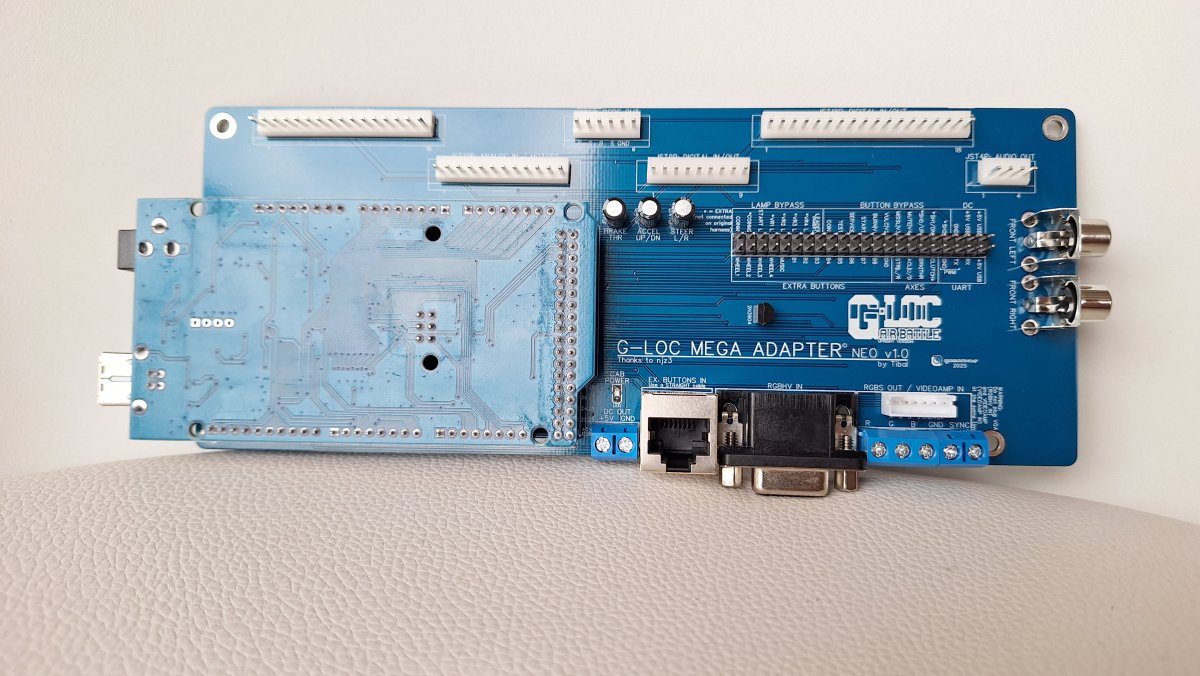

Hi I've finally got around to installing this.

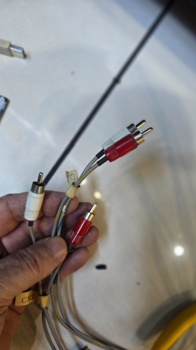

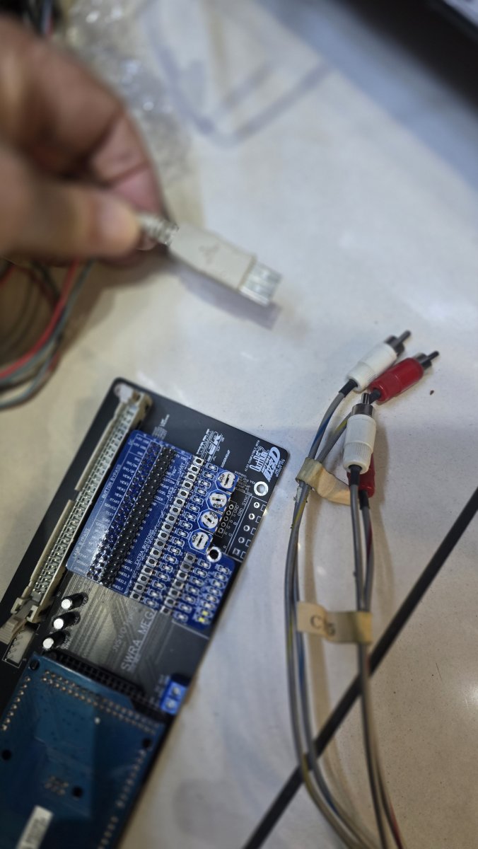

I need advise please on the connections. There is a cabinet usb cable input and 4 audio inputs that in unsure of.
The usb cable included with your package obviously goes from your Mega board to the PC, does the cabinet USB plug into the PC too? Audio will be an issue?
Attached are pictures of the screen and the board, usb and audio cables.
Cheers
Bob

Hi Bob,
Be careful, the "USB" cable you had in the cabinet is a JVS cable, not USB, even though it looks the same. Don't use it, it would harm your PC.
You need to plug the Mega Adapter where the IO board sits. The installation will be similar to what you see in this video:
View: https://youtu.be/W4AHt0lVRGQ?si=XhQhgpoAJnoy44HS
For the moment, you can unplug your Control Panel Mini (the blue board with a lot of buttons, plugged in the Mega Adapter). You'll plug it back in only if necessary (for diagnostic purposes, or to control the PC on a desk outside the cabinet).
For your Audio cables, the original Sega Amp has RCA inputs. You can either:
- go straight from the PC to the Sega Amp with a Jack to RCA audio cable
- use a jack to Female RCA adapter and reuse the original RCA cable on the Hikaru side, like I did in the video

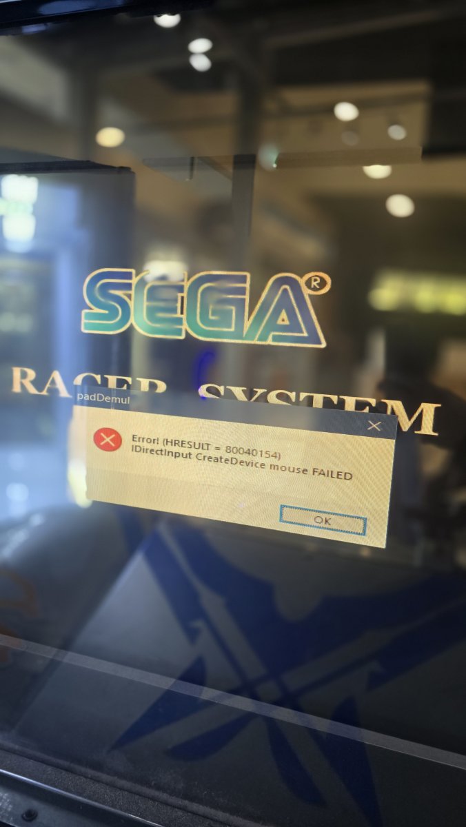

EDIT: you need to leave a keyboard and a mouse plugged to the PC for Demul not to crash
