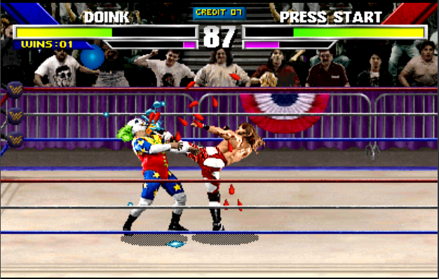

Blood: There ain't none! In fact, we've told Mark and Sal that we don't really want any... after all, you don't see blood in the WWF anymore... if you want blood in wrestling, you watch the WCW, where they still use branding irons and such on each other... " . But they still tried it during development with Doink's character, and the code is in there, just commented out.
It was easy enough to enable. It's only shown on some face hits, but really changes the tone of the game.
The current ROM release with Doink blood and Yoko fatal is available in the GIT in the ROM folder ( wwf_game_rom_l1.30.u54 and wwf_game_rom_l1.30.u63)
