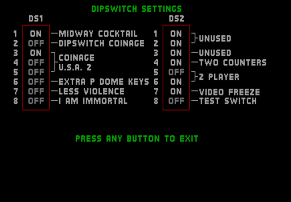

smash tv new dip switch settings process. experimenting with layout and options. possibly adding extra keys in paces, immortality/invincibilty, not sure about violence settings, as I don't think there extra violence just less

I just take the path that gets you to the key bonus room. you'll definitely have enough keys then. :P
some of the room names got changed for revision 8.0, maybe an option to use the 5.0 room names?

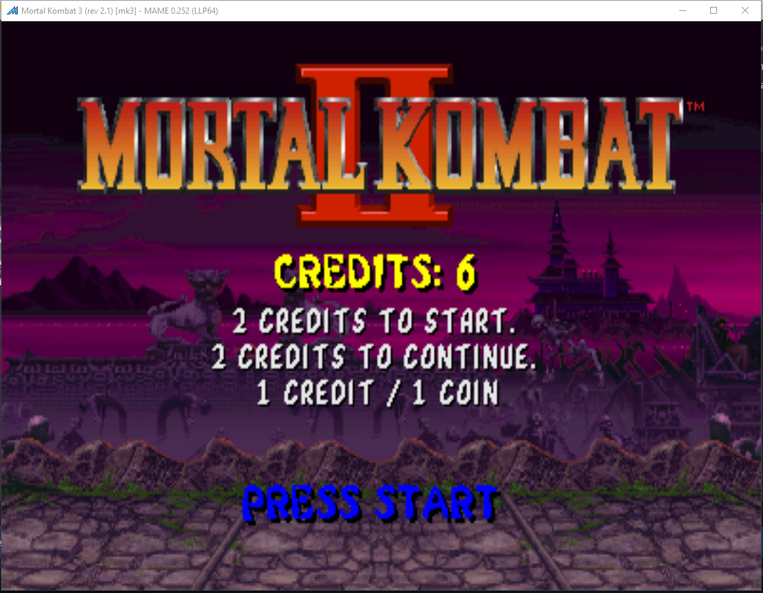

At this point i need people with real hardware, some mk2 skills etc. to play through it (MAME is fine) and report crashes, glitching, differences vs. the real game, and preferaby real hardware for myself to test further on.
Did you know that mk2 is almost Wolf Unit hardware? It's so close, that we can do this:
(Hint, look at the Window title..)

That was fairly easy. There's some stuff left to do, and the music/sound has some issues loading mk2 roms.
Also some inputs need to be remapped.
