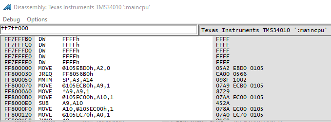

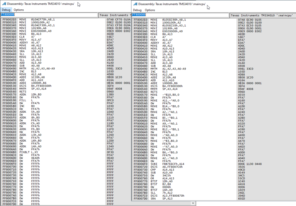

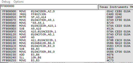

well, I tried the roms out but its a black screen scenario right now
I’ve realised now the issue, I have run out of space for 1meg roms like I thought before not by much but enough so it’s 2mb roms for the futureon the smash tv updates, I checked the actual rom files and the code still fits inside a 1mb rom. last address is at 1F945h so I've no idea why its complaining about not enough space. all this stuff is a real labour of love, grrrrr

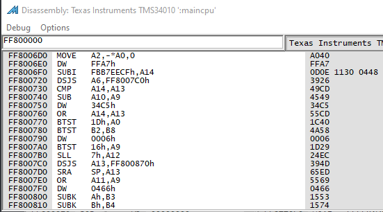

FF88BFF0: MMTM SP,A7
FF88C010: MOVI 4h,A4
FF88C030: CLR A1
FF88C040: CALLA 10B7F90h
010B7F90: DW 0000h
010B7FA0: DW 0000h
010B7FB0: DW 0000h
010B7FC0: DW 0000h
010B7FD0: DW 0000h
010B7FE0: DW 0000h
010B7FF0: DW 0000h
010B8000: DW 0000h
010B8010: DW 0000h
010B8020: DW 0000h

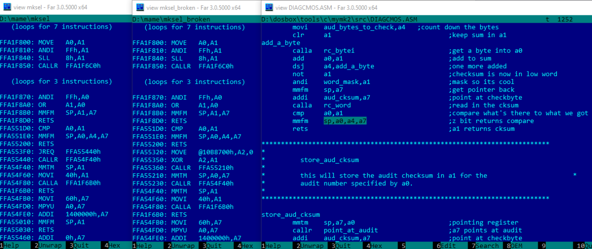

form_aud_cksum_and_store
mmtm sp,a1,a2 ;save a1!
callr form_aud_cksum
-> move @bad_aud,a2,w ;get the "fudge" word
xor a2,a1 ;make cksum bad if audit is bad
callr store_aud_cksum
mmfm sp,a1,a2
rets
I will certainly take a look, I need to update my builds now we got passed the earlier issues. I have a fork of yours so will update form thereGame crashing is probably because it fails to create a process. This was changed in main.asm. audit_game_starts.
It uses the CREATE macro to do this.
I'm thinking we need to redo the DIAG* / CMOS stuff as this was the problem when we first started.
pid_secbust, secbust_proc.. on_hstd those things were all 'off' and causing compilation problems at first.
It seems audit stuff is also wrong or misconfigured, maybe we got a WIP build when they were changing this for, i'm not sure.
The game crashes wanting to audit the game start.
Might be related to the problem with continues in Smash TV / Carnage, as these probably also audit 'continues taken'. Not sure.
