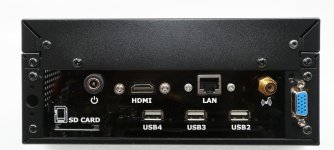

Finally got into trying the MiSter out, liked it so.....decided to put it a smallish pc case since I didnt really like any of the offerings.
Went with simple/minial soldering required setup with off the shelf parts, etc, think it came out pretty well. Removed the stock fan on the io board, installed a big ass 120mm, overkill, but I wanted quiet and large air movement, plus the case came with mounting location for it, so why not.
Still need to tweak a few ports here and there, but overall very happy with it.

Thanks guys, this was basically my beginner build, to use quickly with hdmi or vga display and some wired/wireless controllers, etc.. Any sufggestions on controller to use? Wired or wireless?

@Derick2k you should sell that as a kit, it's one of the best case designs I've seen.
Thanks bro, it can be a lot cleaner though. Now that Im learning about what it can do Ill make a revised case with a little bit more options. Cleaner wiring, will put in pin headers for wire management, etc..instead of direct soldering like most do, I want it to be easy to replace anything in that could go bad.

That is seriously so pretty. You have no idea how many more people would get in on MiSTer if it wasn't an octopus. Or, well, maybe you do. Excited to see what you come up with later! I want it!
