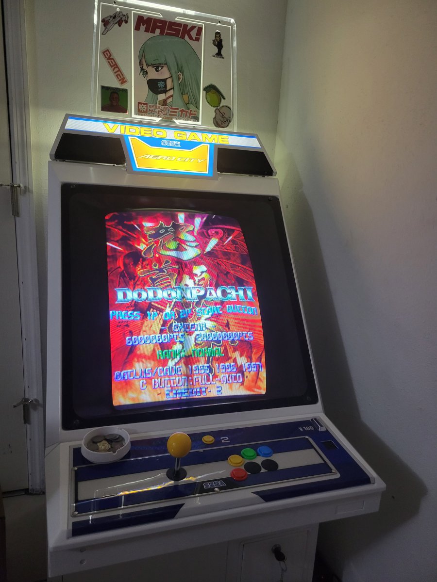

It's beautiful. And it works great too of course, just easier to get a shot of on its own here. Very excited for future remote and VS possibilities.
