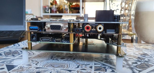

I agree, there are no major issues, just feels a bit sloppy for such a premium product to be honest. Please see the below as constructive feedback, instead of criticism.

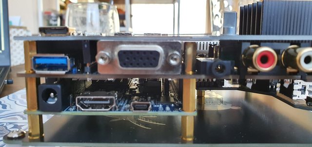

So here's what the top plate looks like when mounted:
You can see that the standoffs are lower than the VGA connector, which makes the plate flex a bit, and you can see a gap between the neighbouring standoffs. Also notice the slightly missaligned connector for the remote on the top plate.

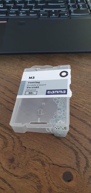

What I did to correct this is put some of these washers (with spring as that was what I had lying around) underneath:

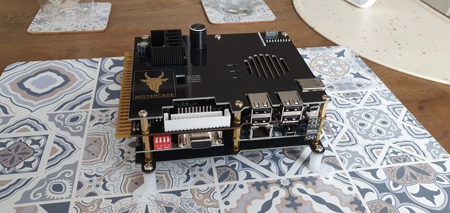

And then it looks like it should imo (the buttons on top can still be pressed just fine), nice and flush/straight:
I did the same for the bottom plate. Ideally the top standoffs should be a tad longer and the bottom screws a tad shorter, but this works fine as well.

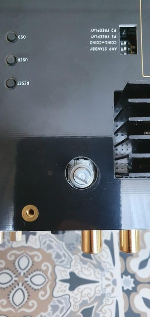

Also noticed the volume dial is not really aligned nicely btw:

I thought everything you said here was just me messing something up. But no, the screws not being the right size for the bottom plate, the volume knob being slightly off and worried about it pressing down and scratching the top plate, the vga port pressing up on the top plate flexing it. All valid concerns.

Yeah sorry about the bottom screws. I noticed the bottom plate was a bit loose but it was already too late. Anyone who wants a $5 refund to replace the bottom screws shoot me on email using my site's contact page. https://misteraddons.com/pages/contact
Regarding the XL VGA port, it's a tricky balance. The upper standoffs are M3x12mm. If you make them 14mm so they clear the VGA port, you lose the ability to actuate the 3 tactile buttons. M3x13mm may better satisfy both constraints - I'll test and report back. Again, sorry for this oversight.
Regarding the arcade volume knob opening - noted, will fix in the future.
