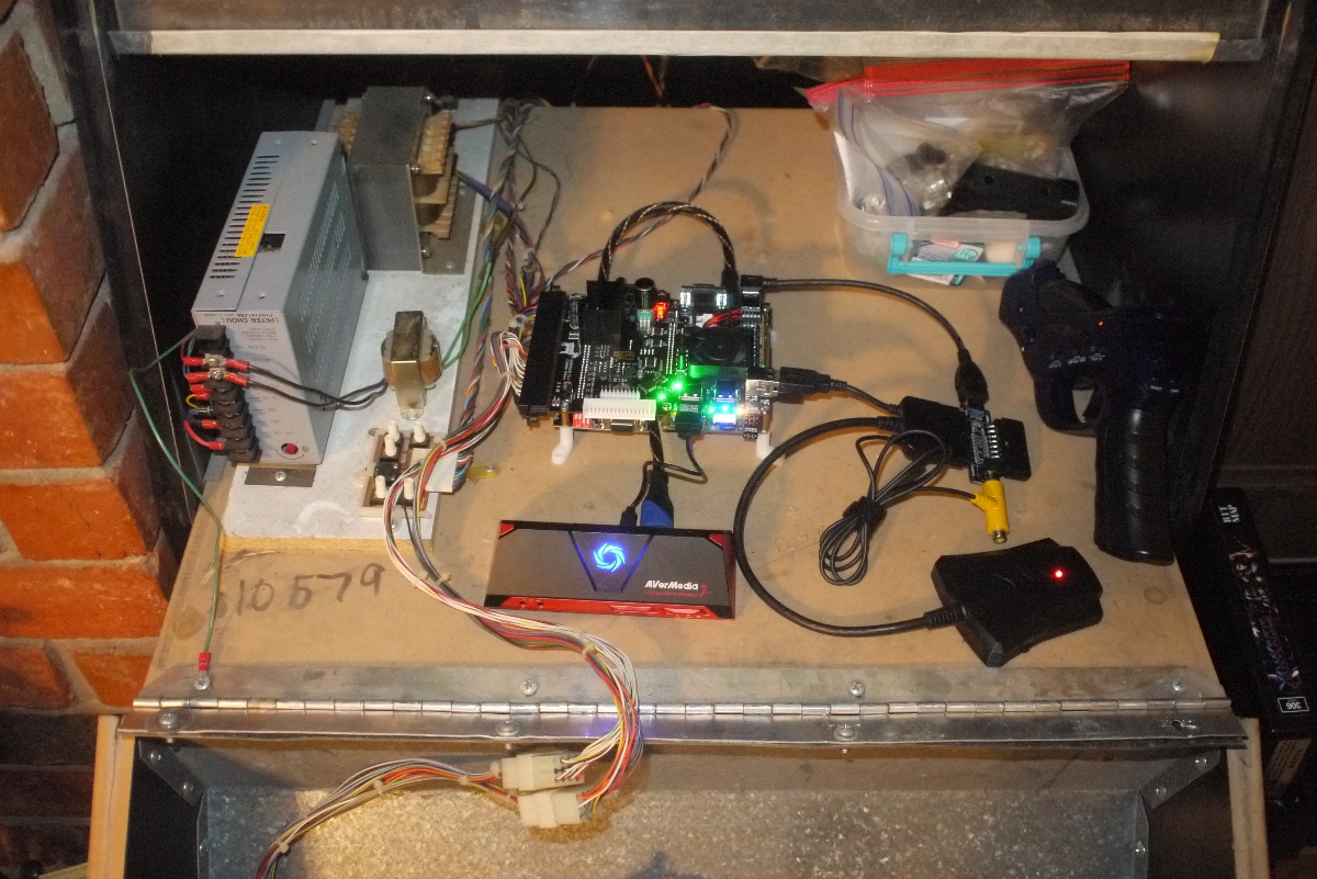

New here, but this thread seems to be the center of the MiSTercade universe, so it seems the place for it.
I've gone through a fair amount of misadventure getting the MiSTercade to record/stream, but think I sorted enough out.
Things I've noticed:
  • [Menu] section in mister.ini messes with hdmi signal, but it clears up when in-game (this thread helped me with that)
  • no HDMI audio, probably that DE-10 switch that flips during install
  • needed ground loop isolator to clean up some noise in 3.5mm analog audio
  • I still probably need a little usb-powered headphone amp on my audio, since I'm not doing line level, and am probably also losing some volume to the ground loop isolator. For now I'm boosting it in post-production.
Edit: well, with my HDMI audio discovery a few days later, all of my analog audio fiddling vanished. Now what am I going to do with a usb-powered headphone amp? 🤦‍♂️

Welcome! Love that you did all this and spent so much time troubleshooting. Thanks for sharing your findings!
How's the Mistercade Versus coming along? I was looking into solutions for wiring up my second cab to my mistercade for a side by side setup, and it seems like the obvious solution.
So there is a big correction to that video. There is HDMI audio. No need for any of that analog fiddling I was doing. I have no idea what I was doing wrong. I toggled the HDMI_Audio_96k off via the ini settings script and it just started working, but now I can't reproduce the lack of audio even in 96k! 🤦‍♂️ So that greatly simplifies everything in my recording setup.

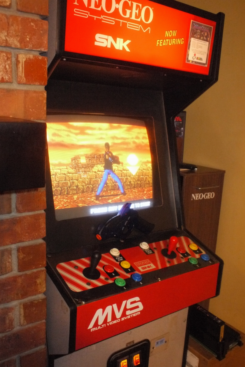

And I've got another new toy. A PS1 SNAC adapter, with a wireless PS2 light gun. I was shooting so many PS1 baddies last night that my hand almost fell off.
Time Crisis has aged like fine wine. I think I need a cable-notch in my cabinet so I can use wired accessories--maybe get some fishing, pachinko, or other controller-based craziness going.

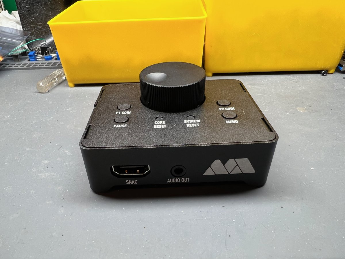

@misteraddons any idea when we can expect the official remote cases or updated remote design w/SNAX support? That's my last bit of setup before I can finalize the Mistercade fully.
...I say that and then the Versus becomes available. 🙃
Yeah the V2 remote is being assembled at the factory and includes SNAX. Meanwhile, V1 remote case should be in production as well. I'm waiting on samples of the V2 remote case.

Out of curiosity, what brand capture card do you have? El Gato cards have some longstanding issues with audio, so just checking if that's the case.
It's an Avermedia 'Live Gamer Portable 2.'
But I've got more tests under my belt and it has to be the 96k. No idea why it ever worked on a retry, I probably failed to save my settings correctly. The 96k audio did fail to record on a future attempt and now I just leave it in 48k and have had 3 tests that have all worked fine.
My 'main MiSTer' has another LGP2 for recording that setup, but 96k has always(?) been off in the ini. I flipped 96k on, gave it a full power cycle, and it recorded a perfectly silent video for me.

Is that a new case for a remote board?
Yes, that's the official case that's being designed.
