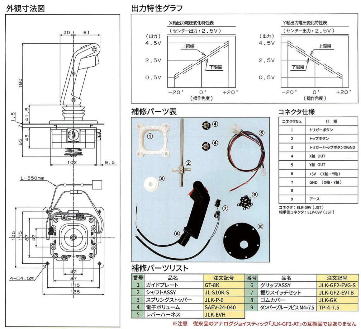

Ok got this on the joysticks:
JLK-GF2-AT is discontinued.
JLK-GF2-EV is the successor of this model. 37,950 JPY.
Can be purchase new from Tops :D
Parts number JL-S10K-S maybe around 12,000 JPY, need to confirm.

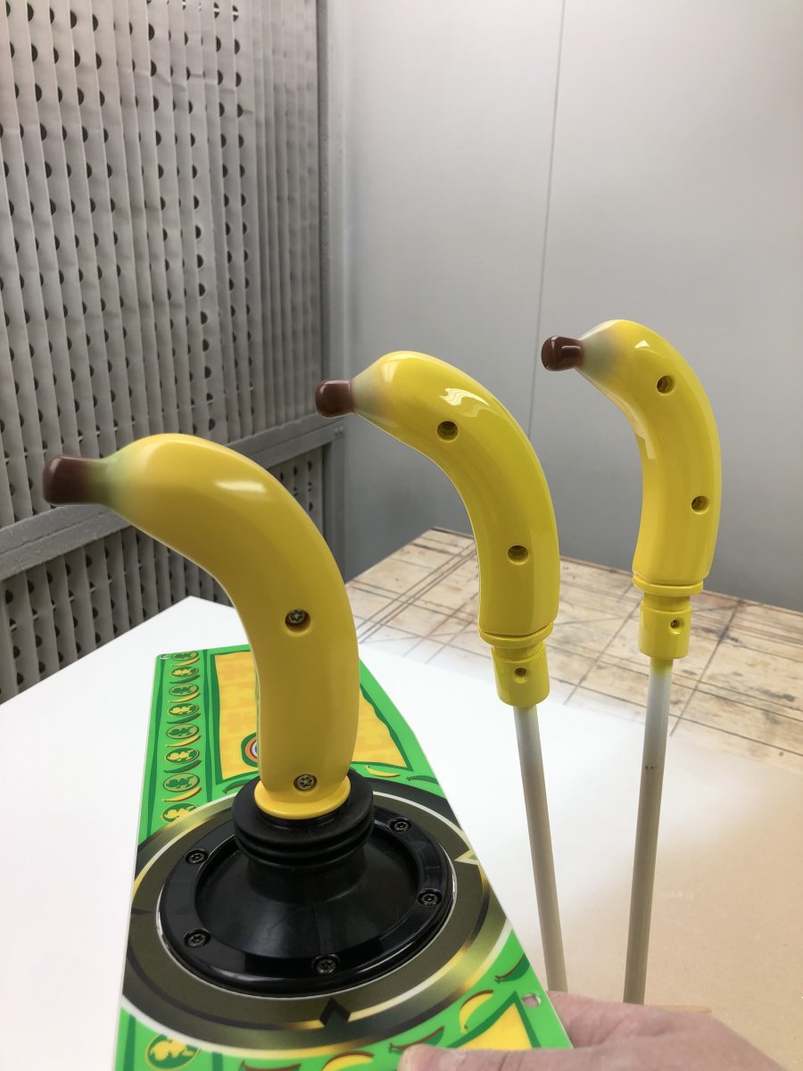

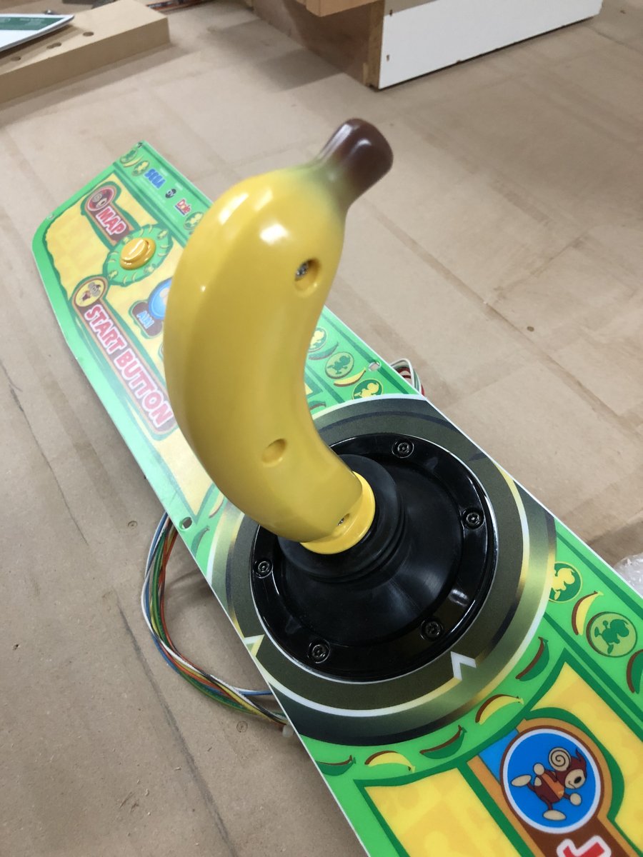

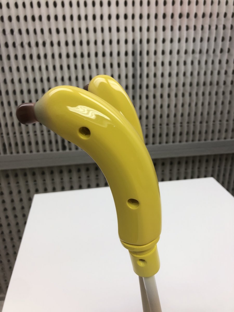

Finished 2, I want to try them on the shaft before I do more.
I decided to glue both halves together, I’m putting two combination washer screws connected by a coupler just to fill the holes.
They are not fully dry in these pictures. They do look nice in full gloss, what do you guys think?
My mix should end up semi gloss once cured.
I’m happy with them!

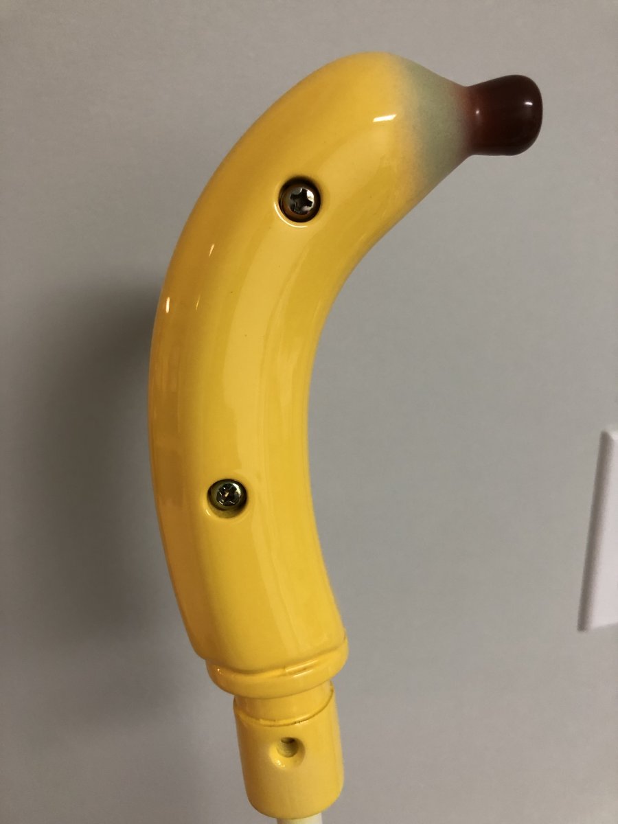

These are the screws I’ll be using.
Anyone have a problem with the high gloss? Looks like I didn’t put enough flatening agent in. I quite like them glossy.

Agree, love that high gloss look.
