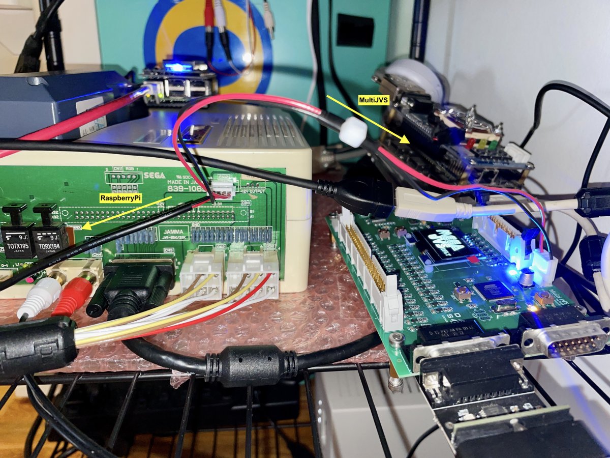

Wanted to post a quick update on my MultiJVS setup. I created a harness that allows me to power the RaspberryPi AND MultiJVS from the CN12 5V header on the NAOMI. The RPi pulls 250mA while at idle, (340mA when sending a game) and the MultiJVS pulls 80mA at idle and 85mA during button presses so it should be fine long-term. I'm running a PS1 / DB15 adapter off the MultiJVS. Other than portable arcade sticks, I don't yet have other IO to test but that's coming 😉
Overall, I am really happy with the MultiJVS as it really simplifies my supergun-like setup.
