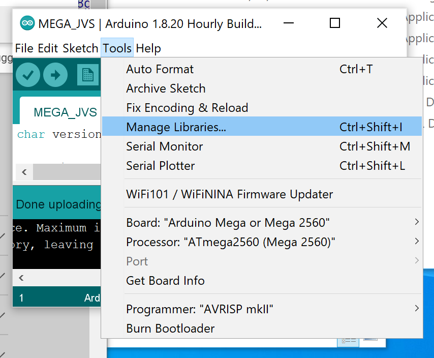

I needed to update the firmware on the MultiJVS to V1.2.7.
  1. Download and install Arduino IDE
  2. Download Bounce2 and place file in 'libraries' folder of Arduino IDE folder you just installed via 'File Explorer'
  3. Under 'Tools' menu of Arduino IDE application, go to 'Manage libraries...' and install "U8glib" (there's a search box so you don't have to scroll)

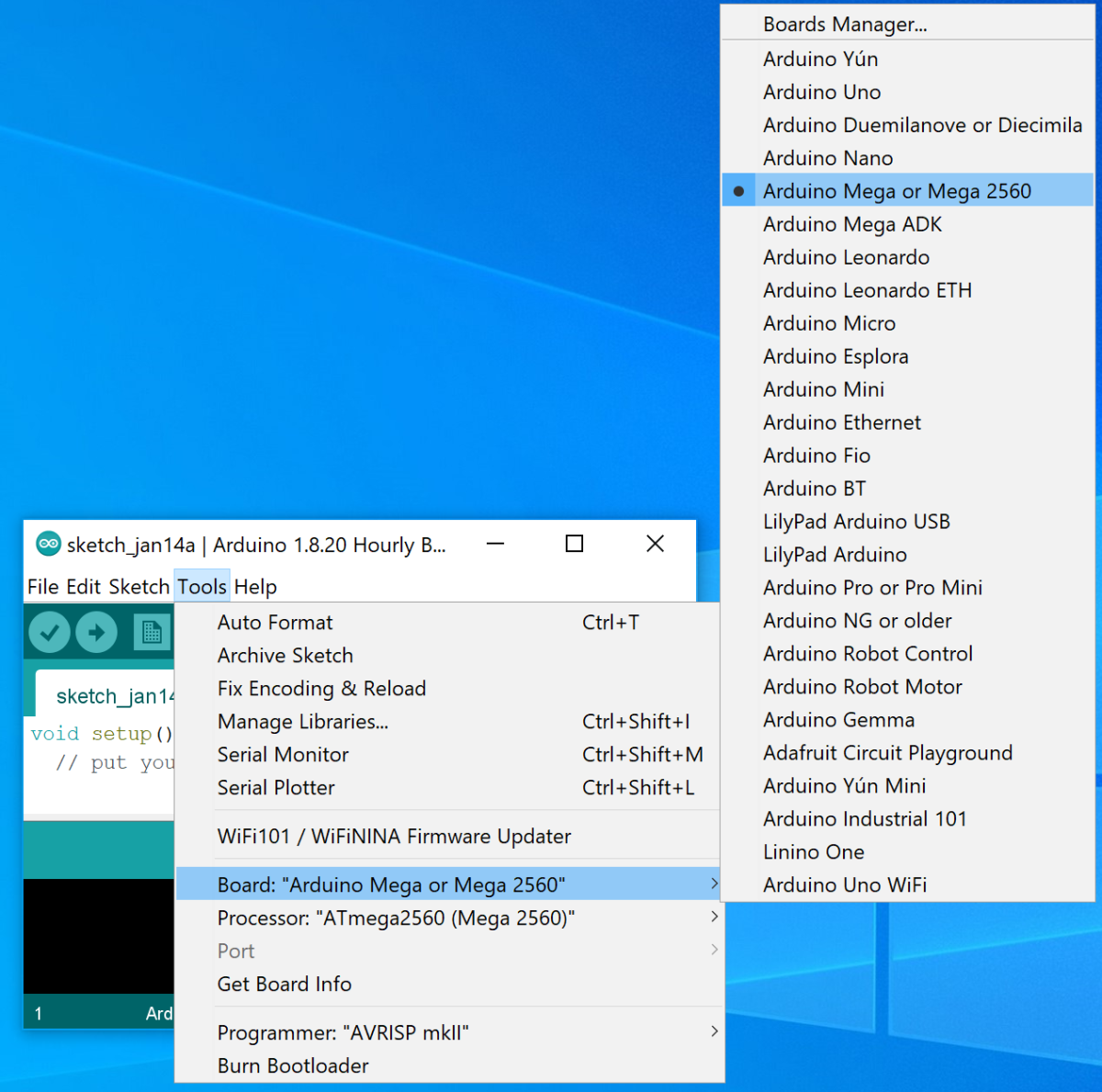

  4. Under 'Tools' menu, make sure 'Arduino Mega 2560' is selected under 'Board' and 'Processor'
  5. Back in Arduino IDE, go to 'Open' (control-O keyboard shortcut) and navigate to "Mega_JVS.ino within "MEGA_JVS" folder which can be downloaded at @winteriscoming github here
  6. Hit 'Upload' in Arduino IDE and wait for progress to finish
  7. When asked to select serial port, select COM port where your MultiJVS is connected via micro USB cable—this can be found by right-clicking the 'start menu' going to 'Device Manager' then finding the MultJVS under 'Ports'

EDIT: Some very helpful notes and clarifications from @clintkolodziej for those folks like me who are more comfortable around hardware as opposed to software 😅
  • Arruino IDE can be downloaded from the Windows Store instead of downloading direct from link above. This ensures the software updates automatically through the store.
  • Bounce2 can be installed from Manage Libraries the same way as U8glib
  • On winteriscoming's github, you can download the respository files by clicking the green "Code" button and choose "Download as ZIP" from the menu
  • Connect the multiJVS to your computer by plugging a MicroUSB cable into the "PROG" port on the board. There is no need to power it separately, it will draw power from the USB connection
  • Open the Device Manager and expand the "Ports" section. The MultiJVS will show up as a "USB Serial Port (COMx)". If you are unsure which port is the correct one then unplug the multiJVS, note which ports are shown, then reconnect it and you can identify which COM port is the new device.
  • During the firmware upload to the MultiJVS COM port an orange LED on the board will flash
  • Eject the SD card from your computer by right clicking on the SD card drive and choosing "Eject" and insert it into the SD card slot on the MultiJVS
