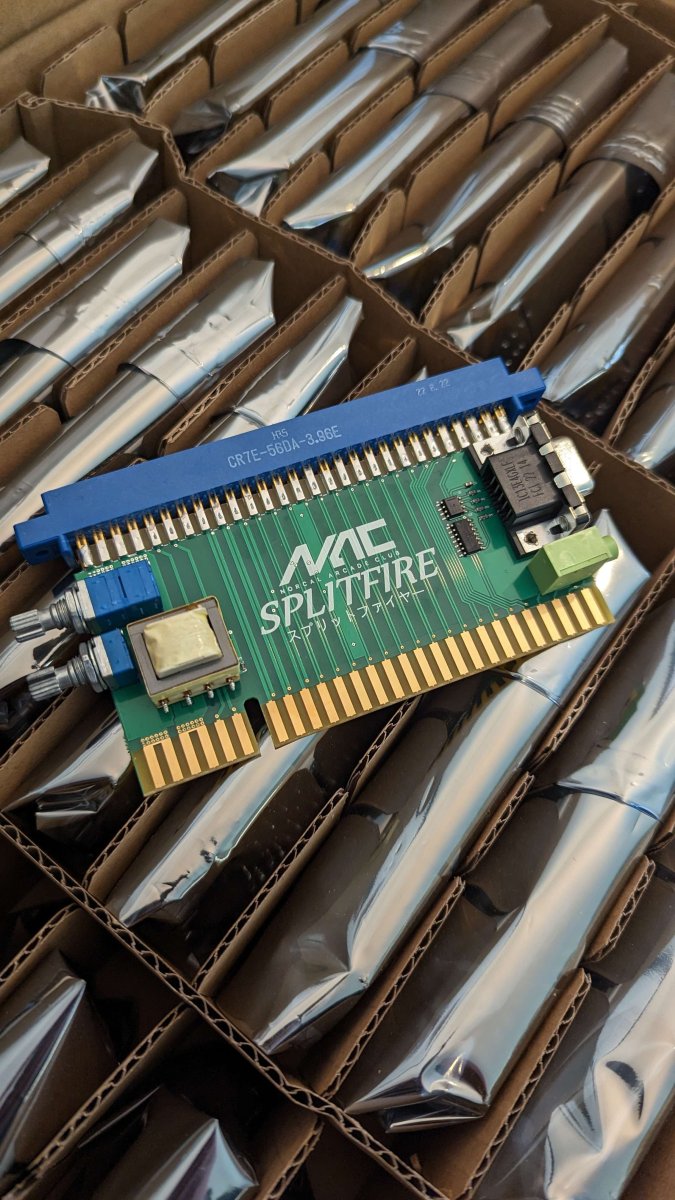

Hi everyone, the Splitfires have just arrived from the factory today and turned out great as expected. I will be processing and shipping orders in the next few days. Please keep an eye out for an email from the shop with your tracking once shipped.
If you missed out on the preorder there are still a few left in stock: https://birdlandarca.de/products/splitfire
Thanks again for all of your support. And also thanks again to @Hatsune Mike for developing such a great product.
