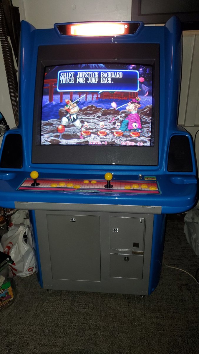

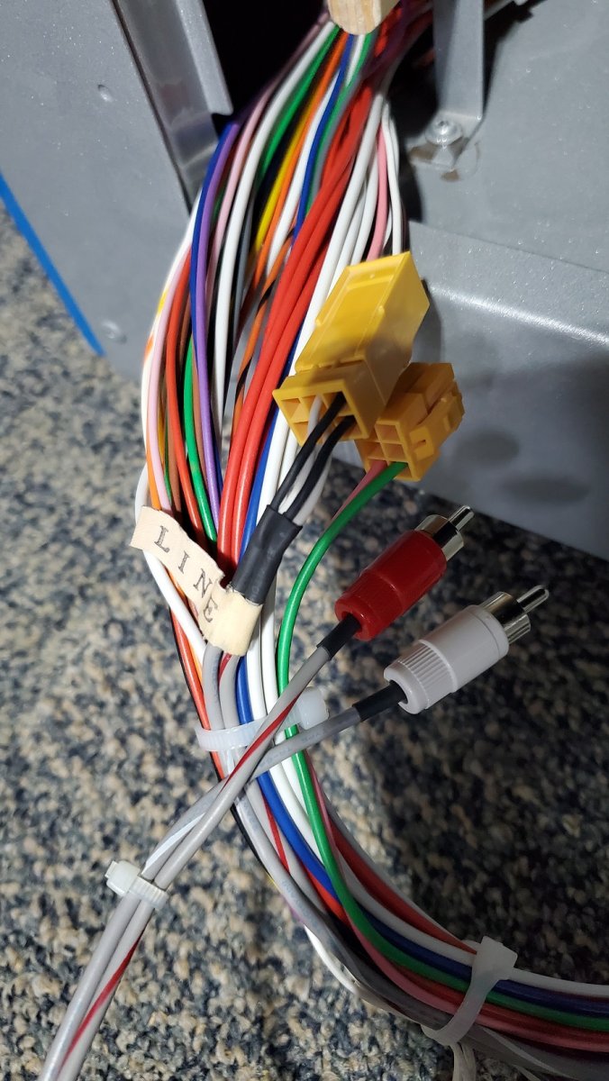

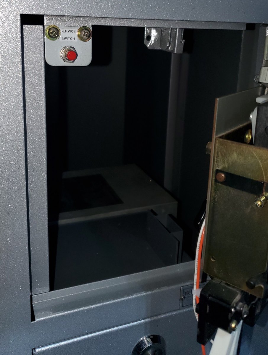

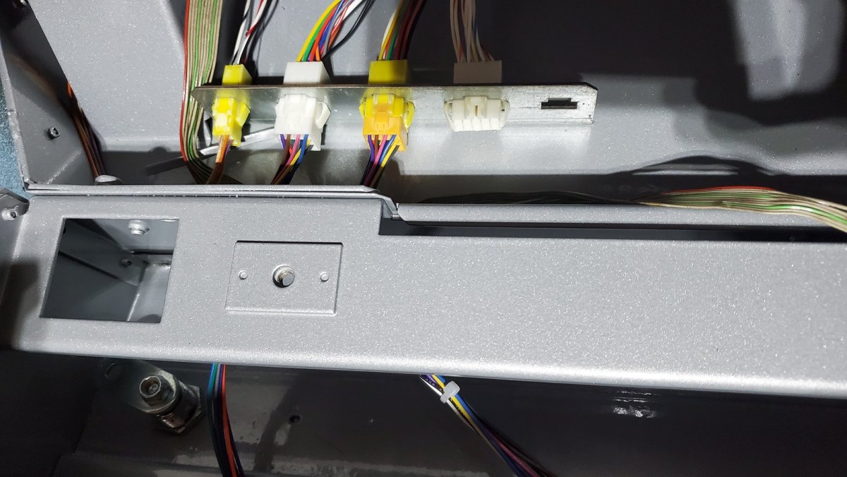

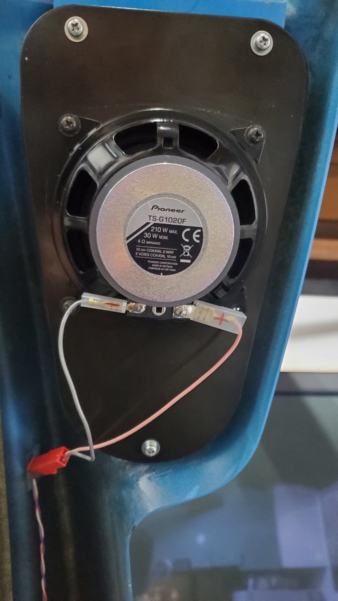

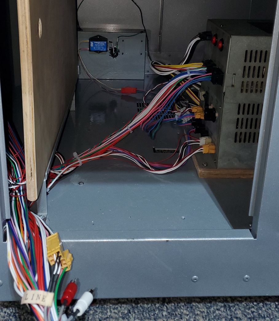

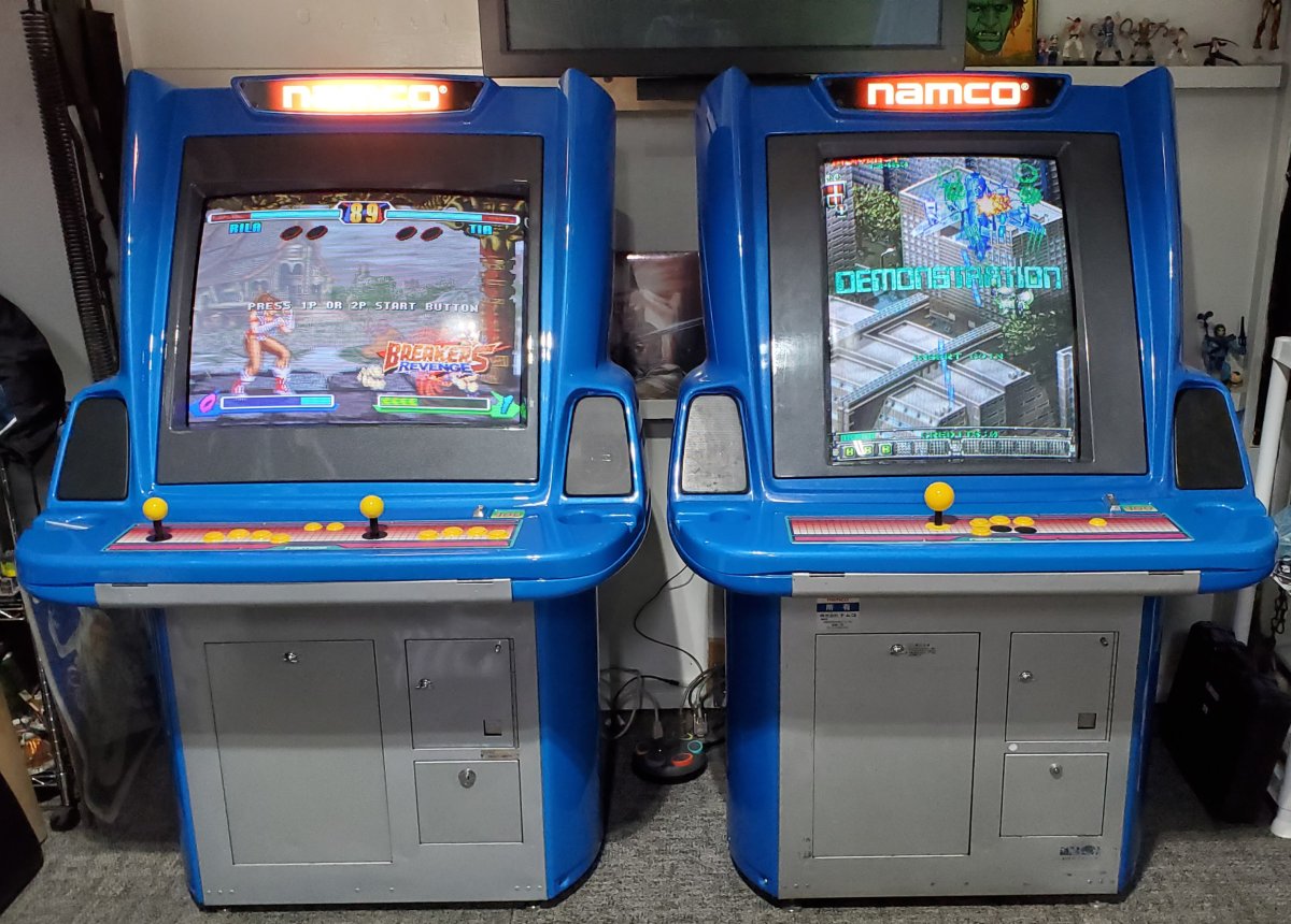

I wanted to post some pictures of the Exceelena Blue that I got redone. I originally bought the cab off ebay from Overcome Arcade and it came as a hot mess. Long story short, I got back 100% of my money (no thanks from Overcome Arcade) and I used that money to get the machine professionally painted and power coated. I hate the Namco wiring, plus my wiring was so wrecked that I decided to get the whole thing redone. A Sega NVS-4000 power supply was used so I can get stereo, mono and JVS power. I took the player control panel bracket and used that, since it makes the wiring look so much better. The cab is about 95% done. I am waiting for the wheels (by Hammer) and a few more earth grounds and the machine is done.

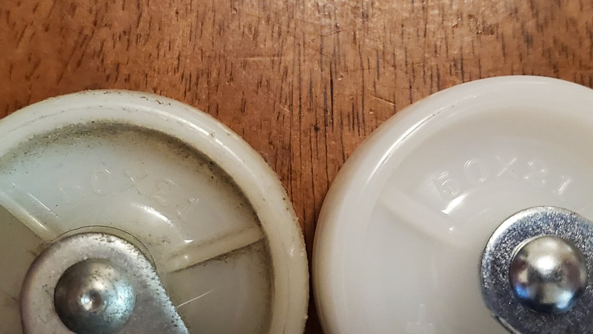

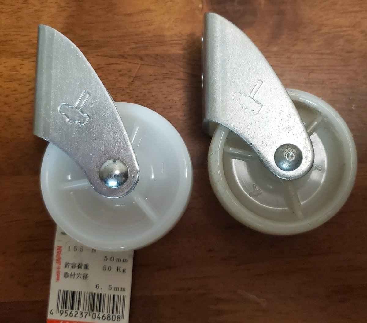

So thanks to @Battlesmurf who showed me this website: https://kital-tools.com/products/155n50bar01-6023

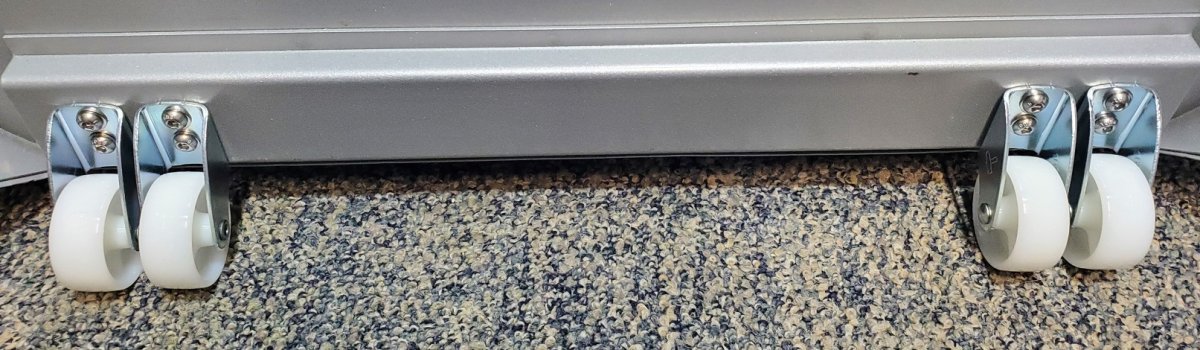

I was able to finish up my Exceelena Blue with brand new caster, which are the exact model that's on my original and in the manual. The wheels themselves are cheap, but shipping is like $30 via DHL to the USA. Took like 4 days. So if you need wheels like I did (mine were completely missing them), I suggest you get these.
Can confirm that they are indeed the same part - I was particuarly pleased with the translation of the parts list on pages 18 and 19 of the manual
