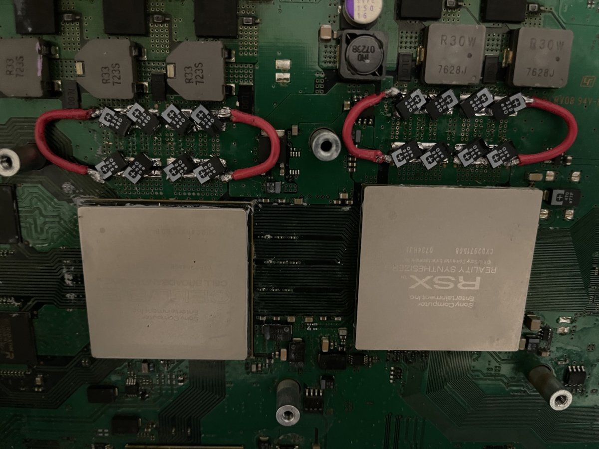

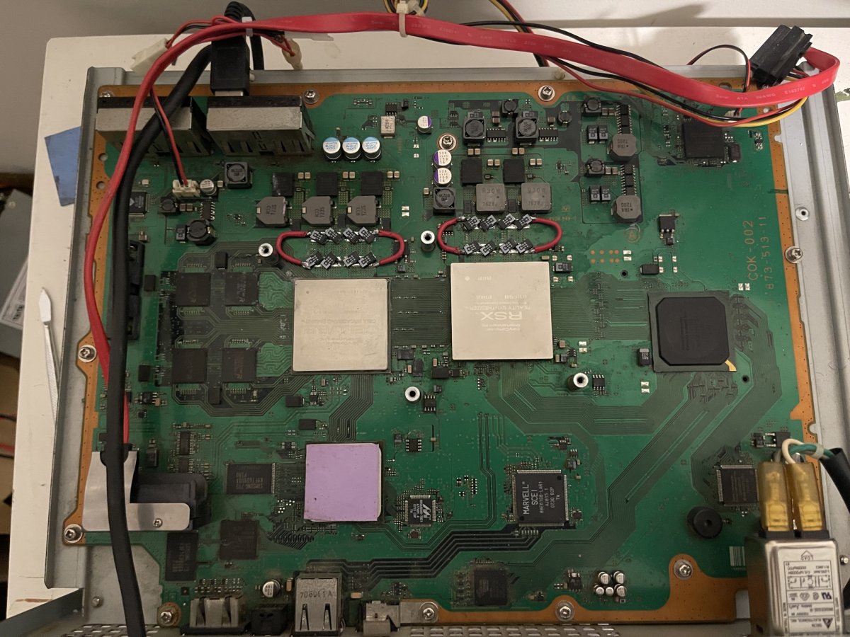

Well, a bit of an update on my Namco system 357 A pcb. It still seems to have some issues as sometimes I get the 3 beeps but after some unplugging and replugging the power cord several times, it boots back on. Just in case, I replaced the rest of the caps but the issue still persists but it happens less frequently. Not sure if the RSX might be having connection issues as I have read that the CELL is less prone to failing compared to the RSX, I can confirm that the CELL does warm up but the RSX takes a while. Probably some electrical connection issues regarding the BGA solder balls? Might it need a reball or have the RSX replaced from a donor pcb? I’ll keep investigating to figure out what the issue is, at least I have the 357C but I would like to keep this system working. I will also give the SYSCON method a try. Anybody know someone or somewhere who can do BGA reball/repair work?

Update 03/04/2022: I’m still doing a bit of more testing on my 357 A PS3 motherboard to determine what underlying issues it might have. I’m 100% certain that my system needs a full reball on both the CELL and RSX chips. Putting a bit of pressure on the CELL and flexing the board a bit seems to bring the system back to life. I did do a reflow but it only works of a while until the system completely cools down. While the NECs seem to bring back the system, the BGA solder balls seem to be the issue, it could also be power distribution issues but I won’t fully know until I try out SYSCON. Messing with the PlayStation 3 is pretty much brand new territory for me. I might buy myself one of those cheap hot tables or Small IR BGA rework stations and practice a bit of BGA soldering. I unfortunately can’t find anyone who can do it for me so I’ll do it myself :) before all of that though, I’ll see if SYSCON will work, after all, the board (COK-002) is compatible.

I did do some voltage test but it all seems to check out, even the regulator on the PS3 board has the correct voltages: 5v and 3.3v. 12v is also fine but I’m not sure if the replacement caps could be drawing too much current which would result in the system shutting down? It doesn’t make sense as when the system does want to work, it would stay on without any issues. Had it on for 2 days straight and no single issue at all, the issues occurred once the system cooled down. Pretty weird. Also, this PSU, the APS-226, is apparently the more reliable PSU for the BC PlayStation 3 fats, well, this thing gets pretty hot lol! One thing I can’t test is the amps. I need a different multi meter/device as mine doesn’t measure amperage.
Heating and cooling is going to exacerbate BGA issues for sure.

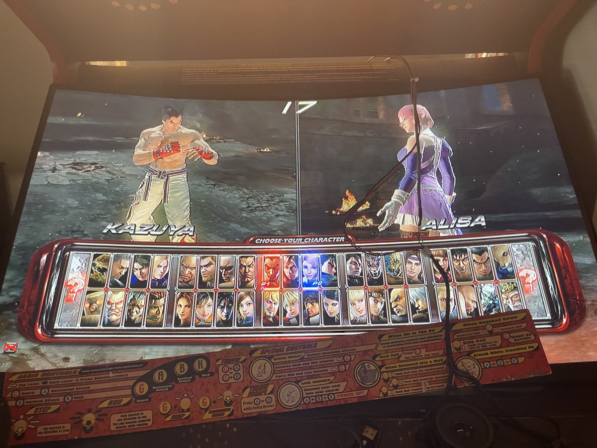

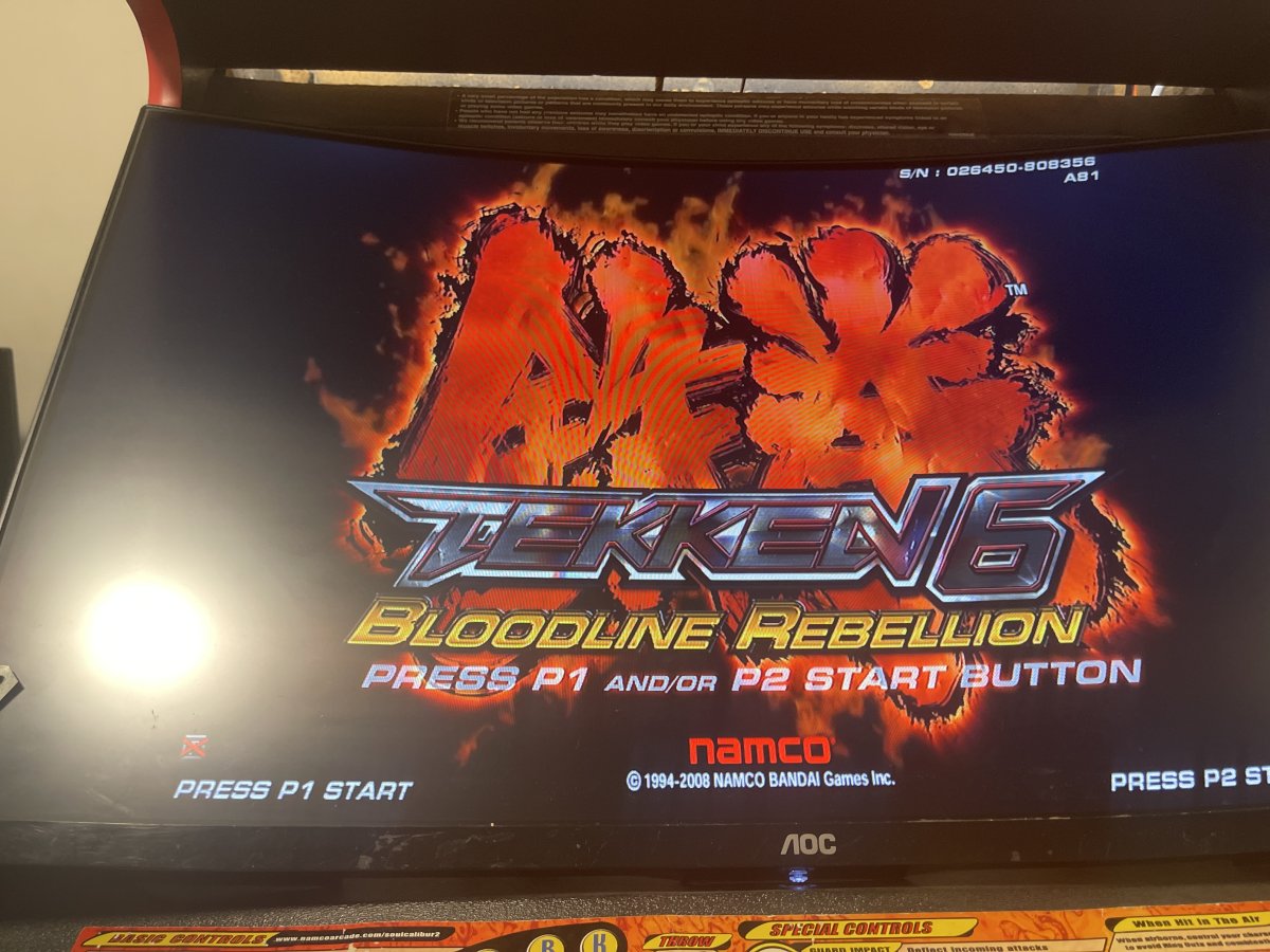

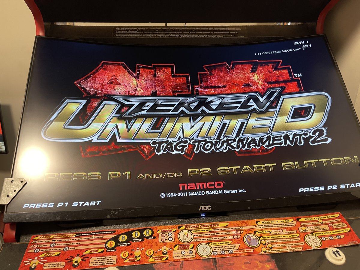

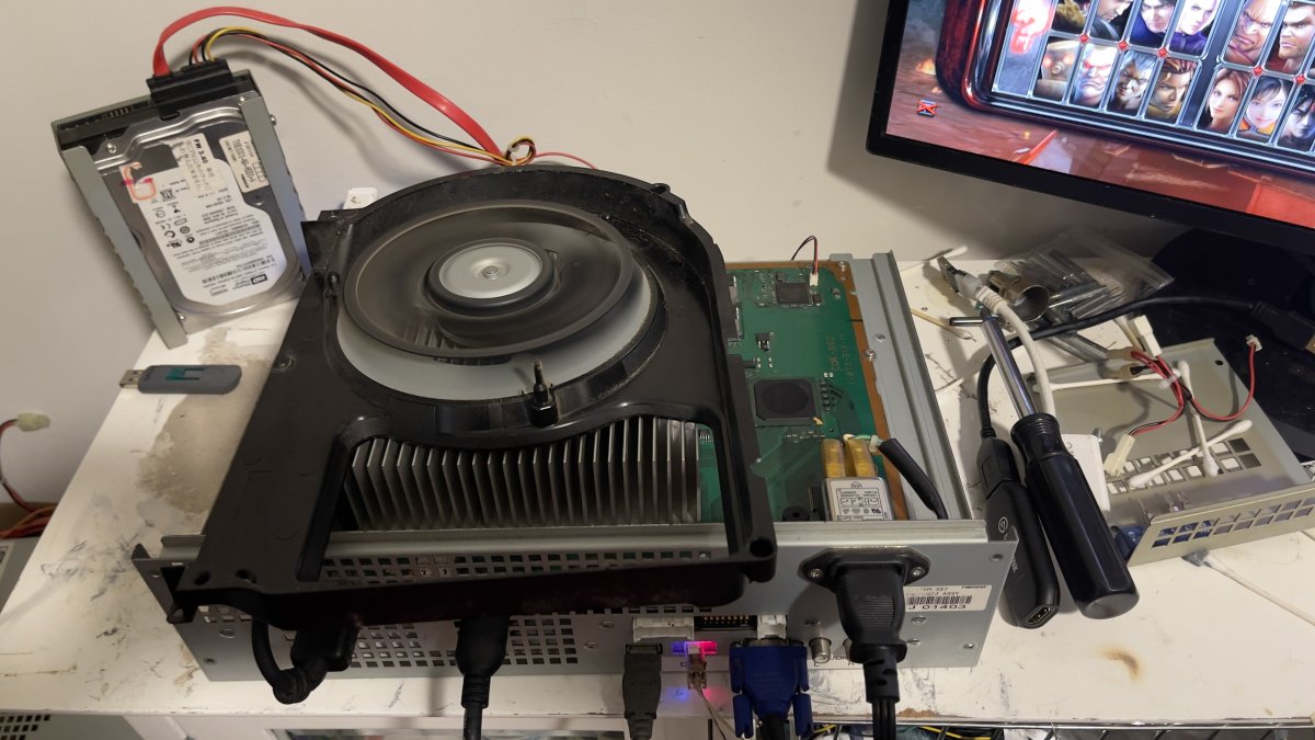

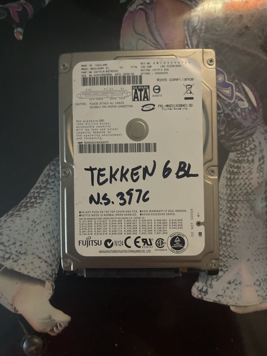

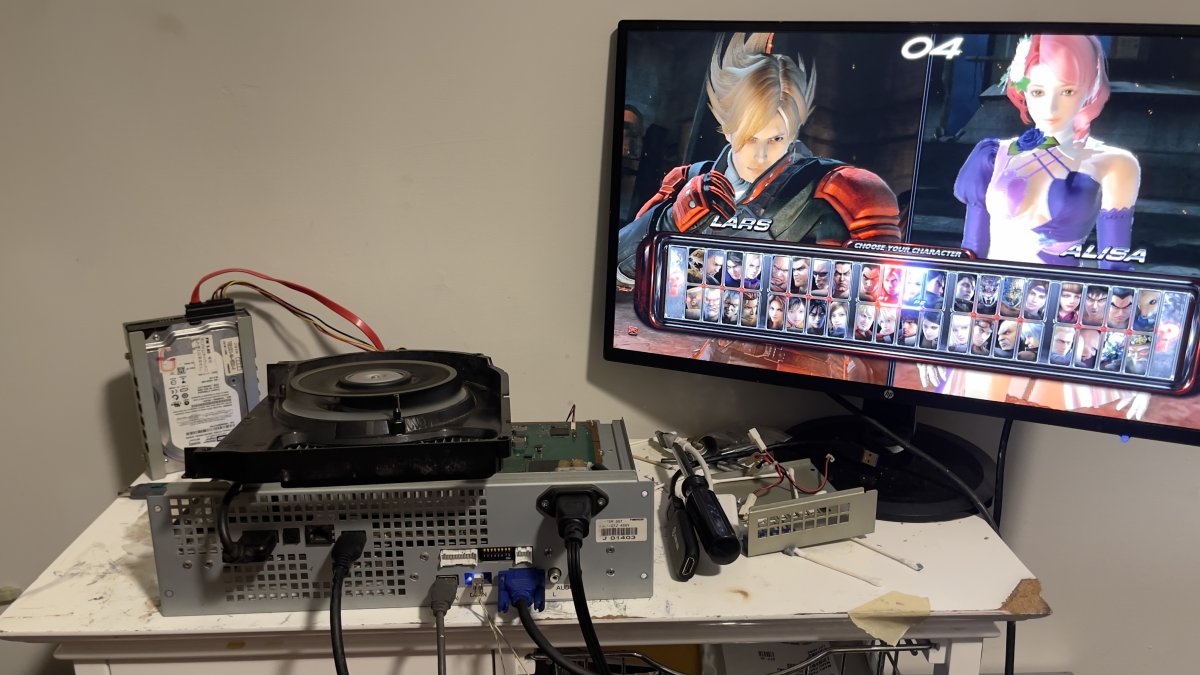

Decided to play around with my 357C I found and made a hard drive with tekken 6 BL installed. Pretty cool that it works on this system but I can see some differences with this specific system which bugs me a bit. The VGA port doesn’t display any video, and no audio comes out through the HDMI port which is a huge bummer! The RCA and optical digital audio ports work fine though. Sucks for recording captured video through HDMI as no audio, only video! I didn’t have any flash drives left and I decided to use my original usb dongle to see what would happen, works fine! I still need to make a Tekken Tag Tournament 2 unlimited HDD as that was my original plan with this hardware :) otherwise, this is still extremely awesome!!!

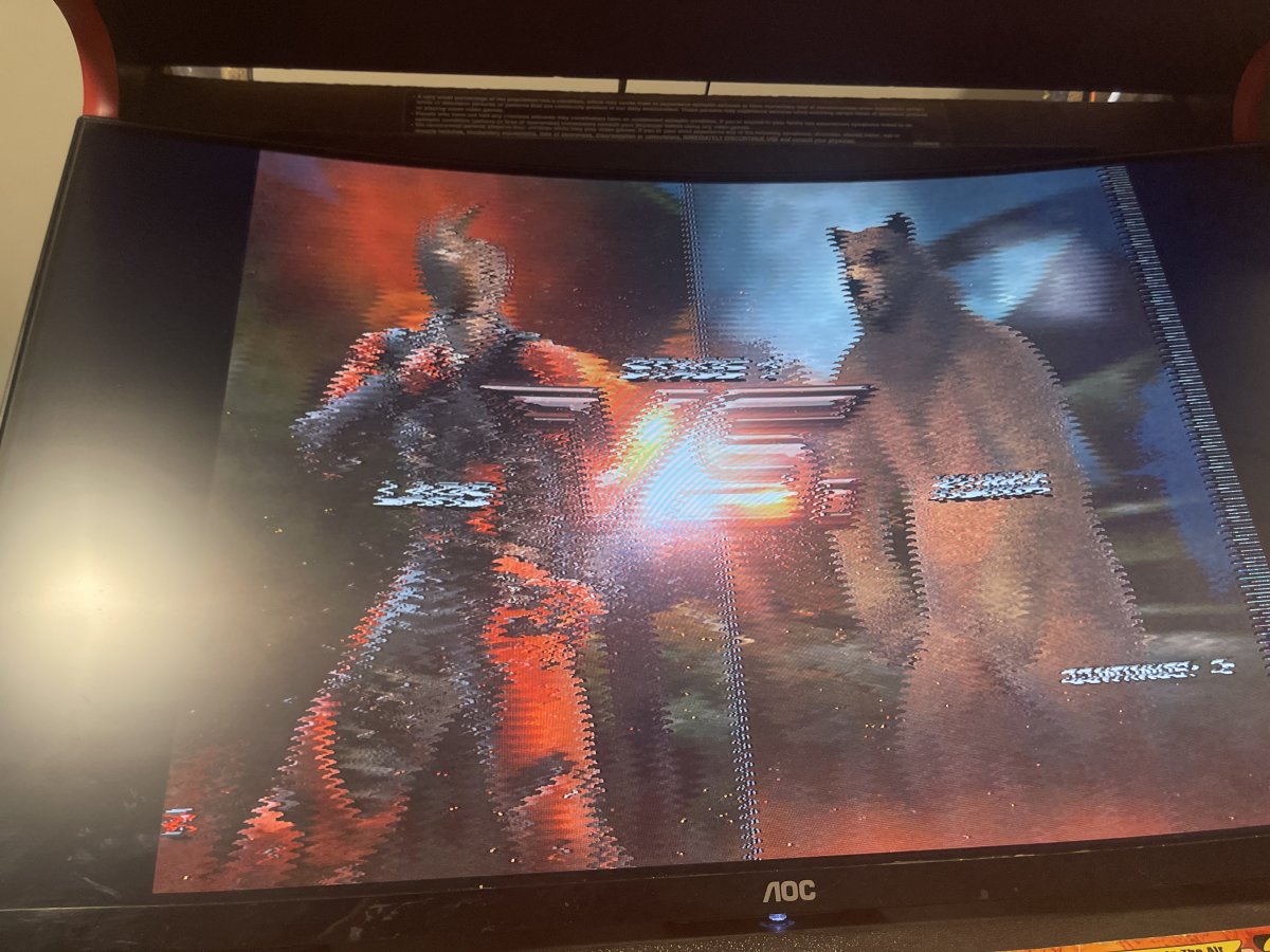

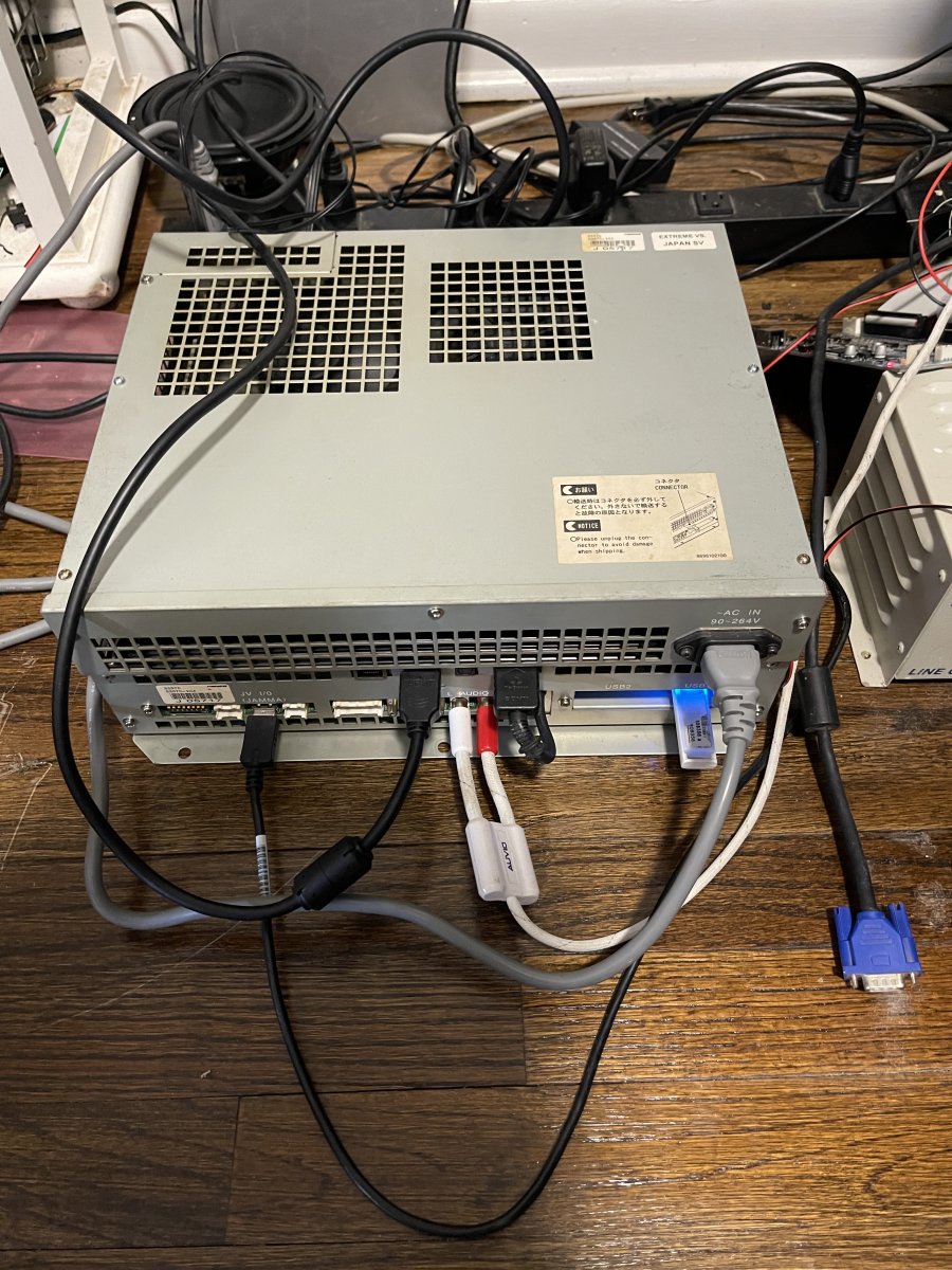

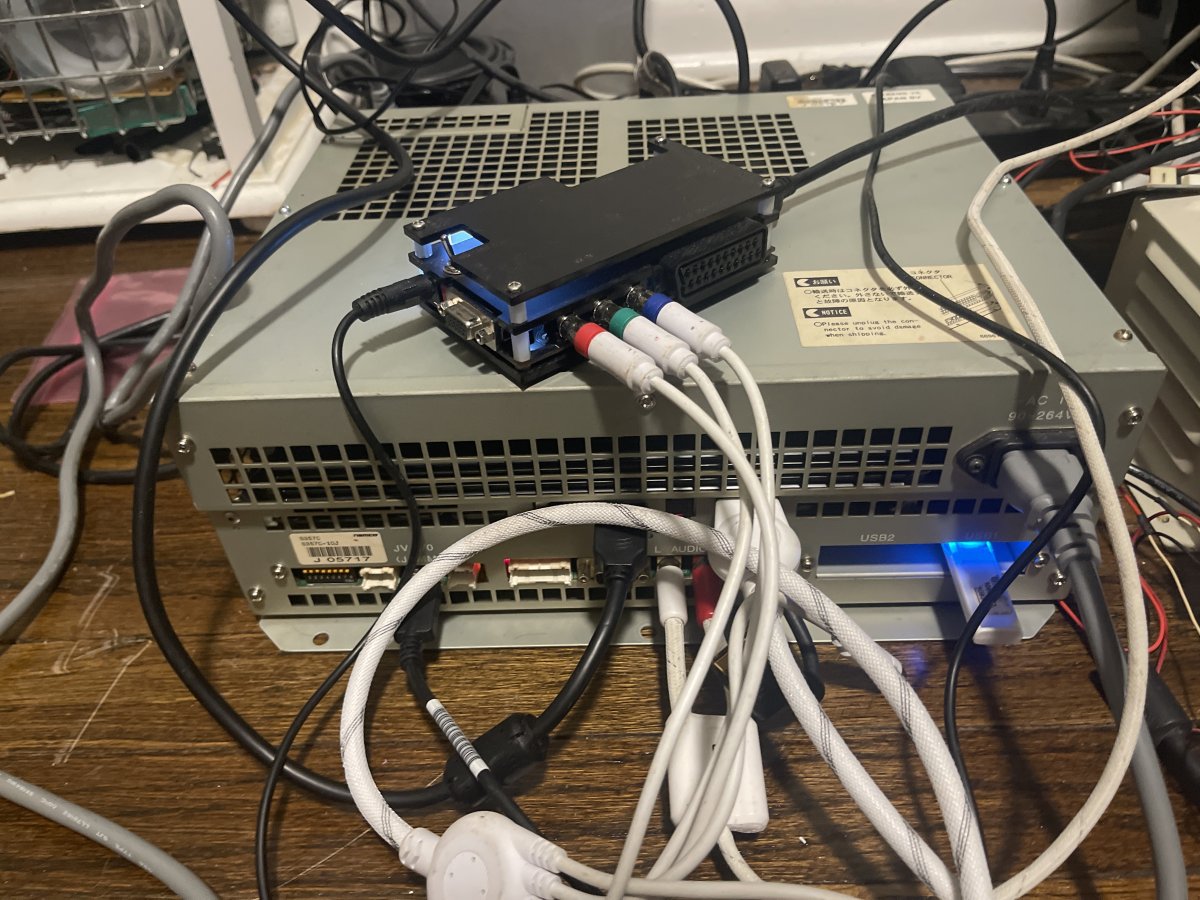

Interesting little discovery I made, like I said before,since the PlayStation 3 can’t do RGB any higher than 480p, the Namco board converts the component YPBPR video signal to RGBHV or VGA for short. Interestingly enough, when I plug in component cables, I get an image. Not sure what the Namco board isn’t converting the signal to VGA, this seems to be an issue with all the 357C and 369 systems that run Tekken 6 BL, not an issue on the older systems or Tekken Tag Tournament 2. I can confirm that VGA did work with the Gundam game it came with.
Update: tried hooking up my OSSC to see if the vga port would sync up, well, this is what I get.

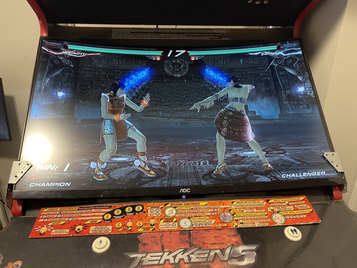

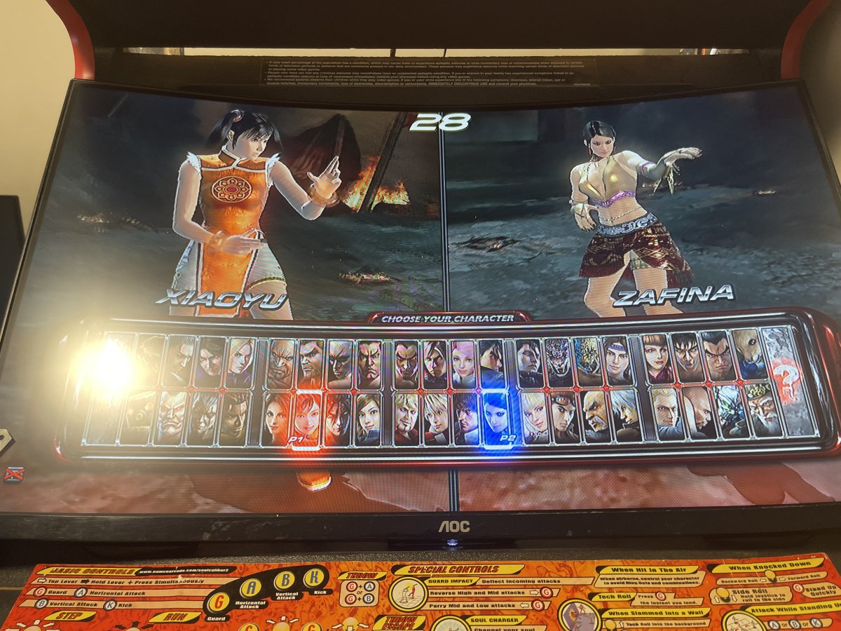

Here are some short videos of the hacked images working on my 357C, pretty awesome!
