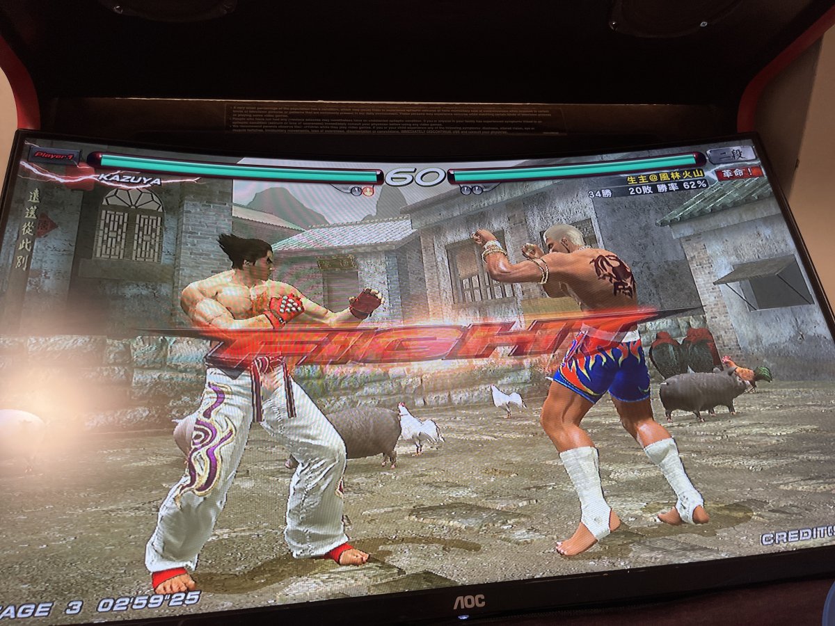

yep :). Tekken tag 2 has the dongle and memory dongle patched out or intergraded into the hard drive image, at least that’s what I guess as the system still does the dongle check boot noise. Tekken 6 still requires a dongle but I haven’t figured out how to make one so I used my original one that came with my original HDD. The hard drive security seems like it has been patched out. Without a dongle on the 357C, it loads up to the XMB, then a black screen followed by a 3 beep code error and it resets, no “USB DONGLE NOT FOUND” error screen, the system just resets until the dongle has been detected.

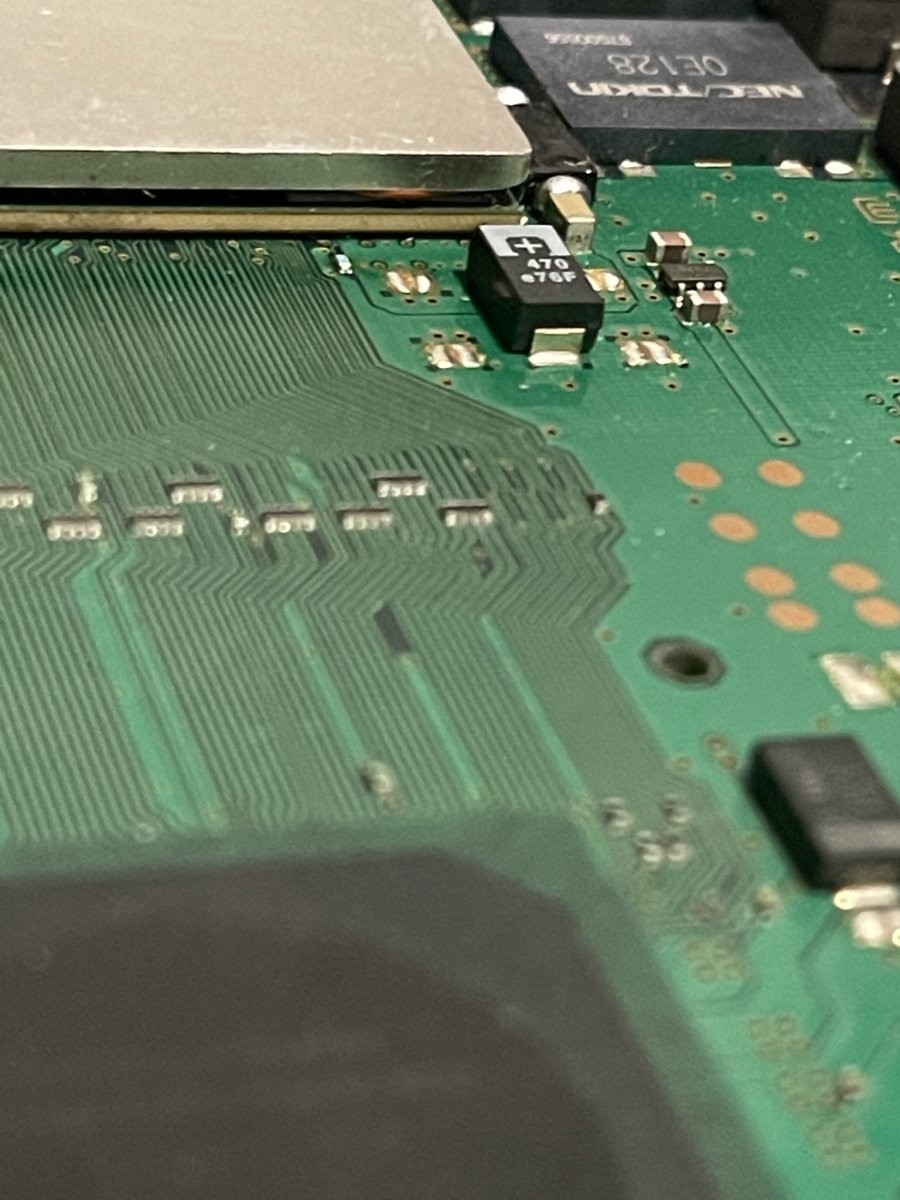

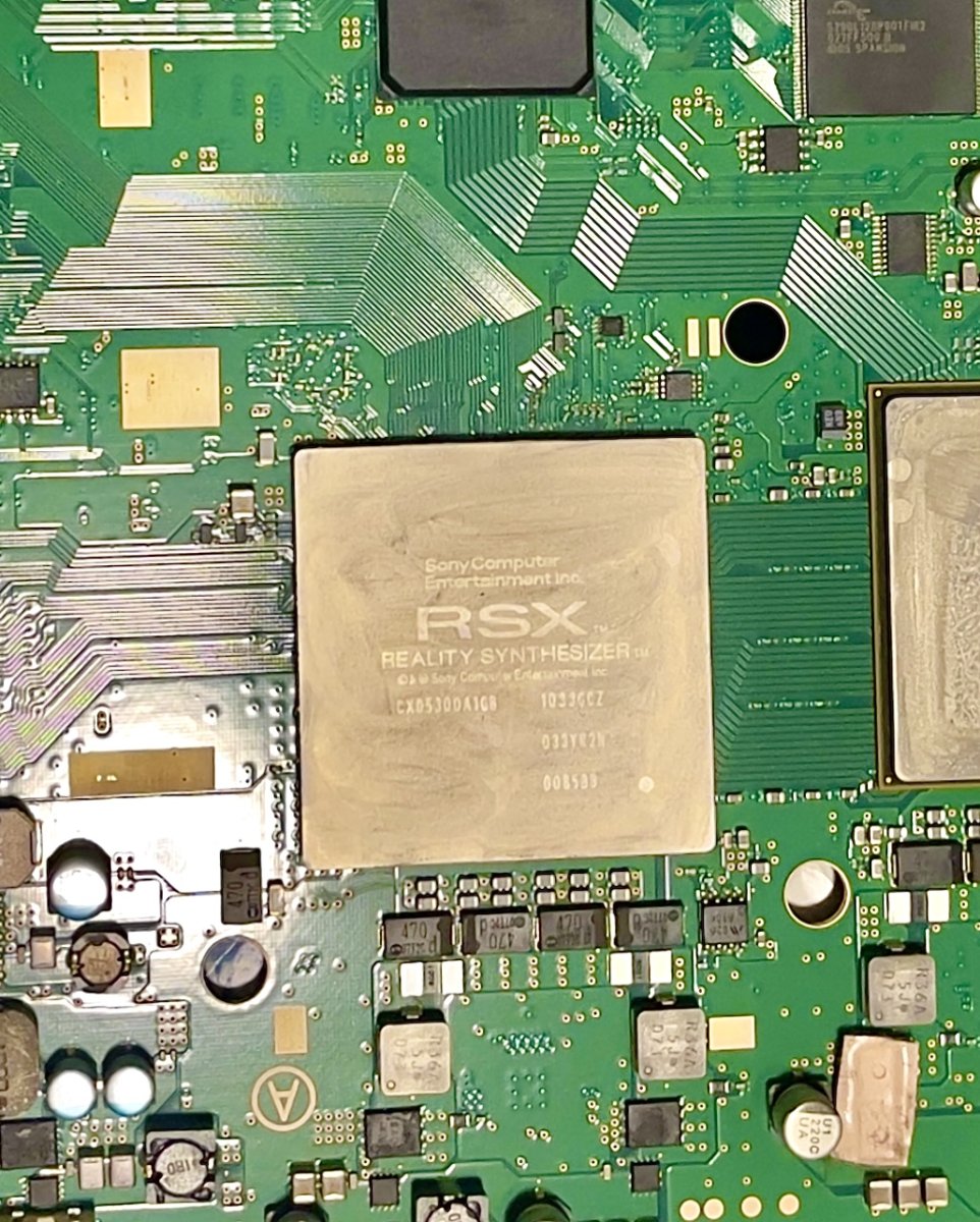

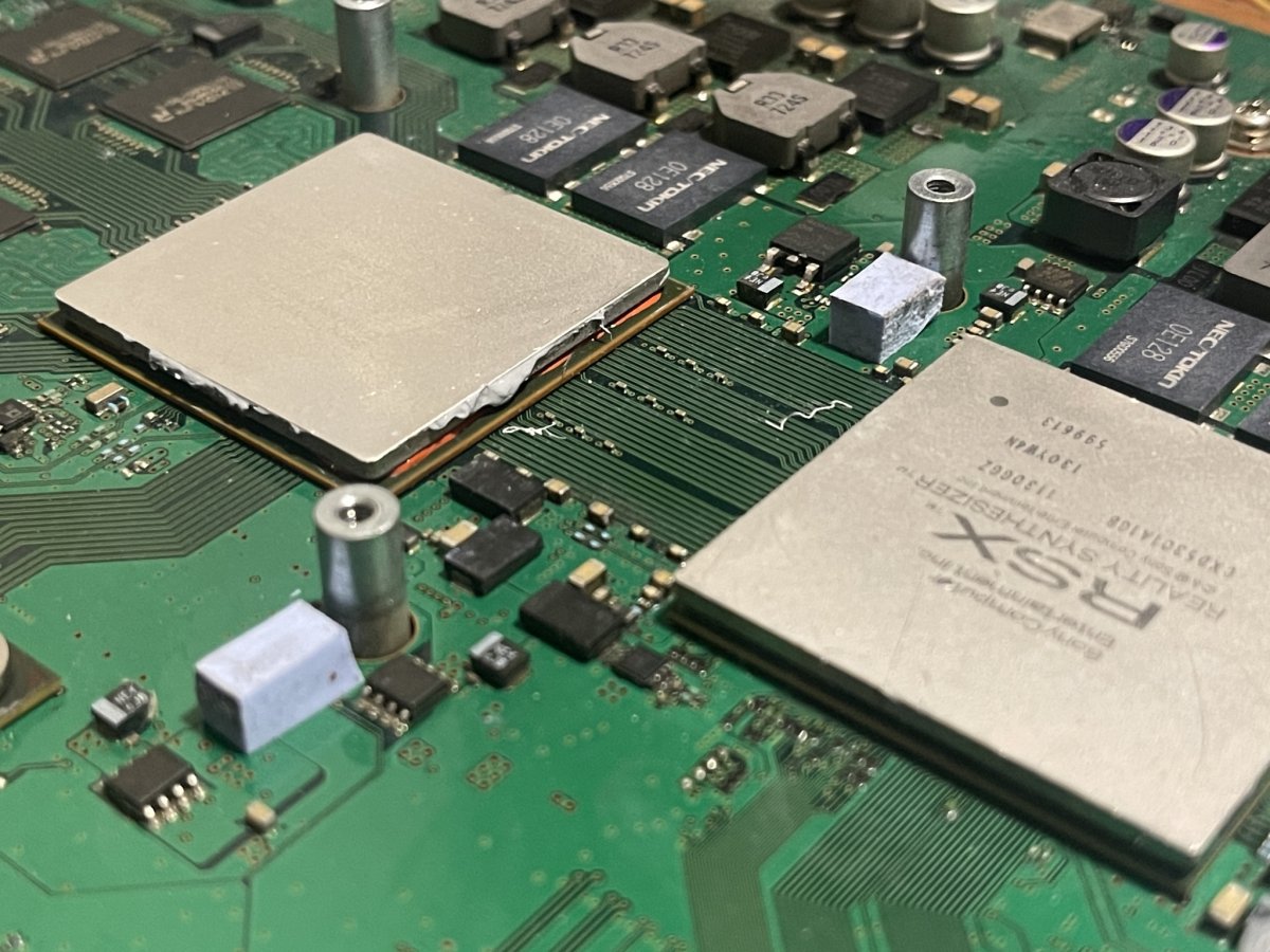

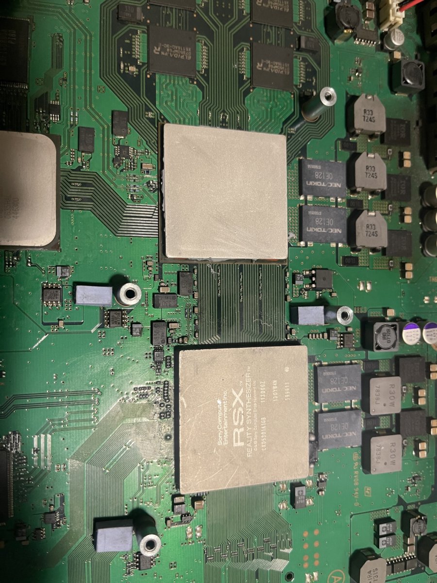

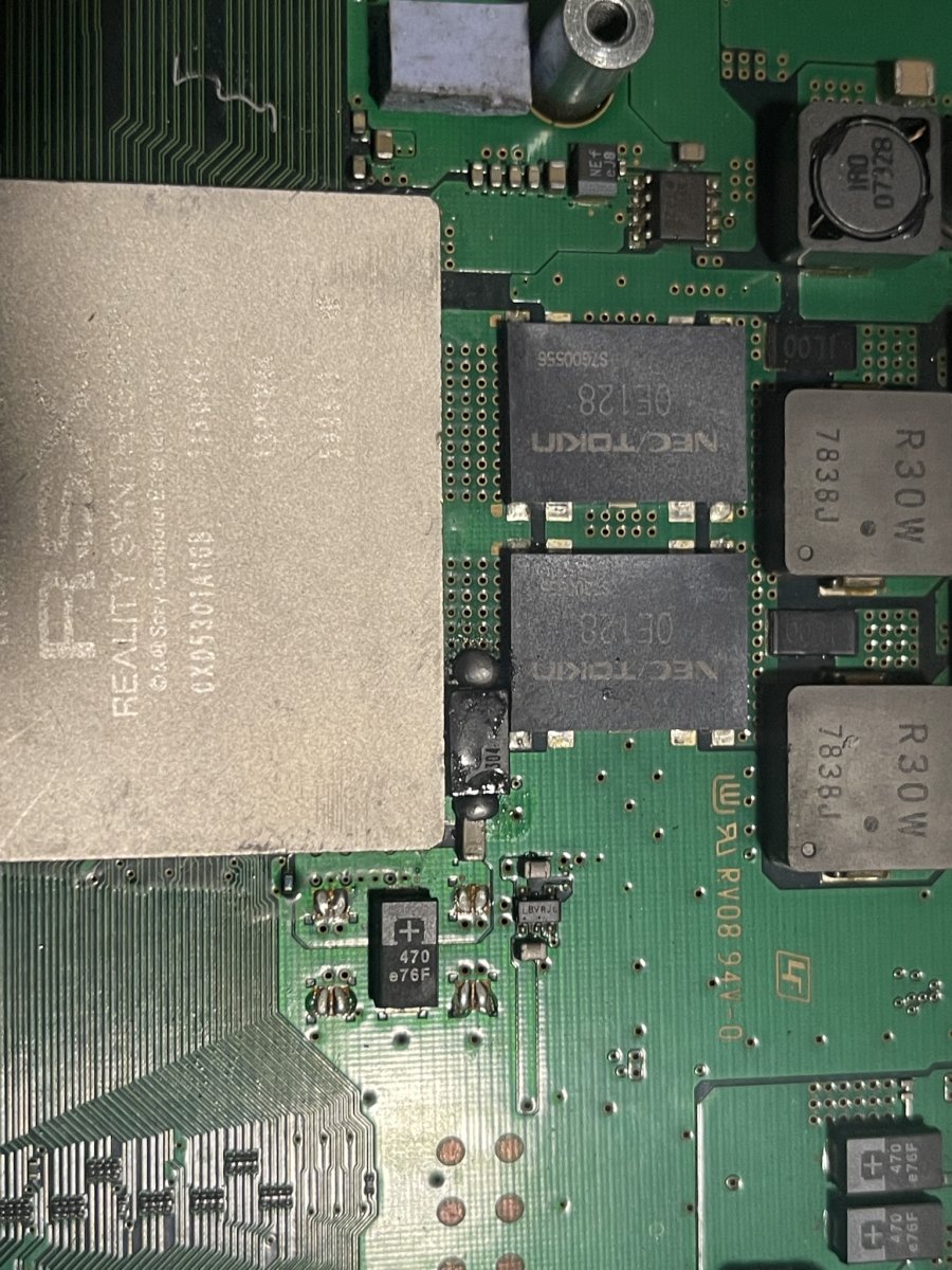

Update regarding the new replacement 357 PlayStation 3 pcb. I actually decided to replace the thermal paste as I was under the impression that the board hasn’t been tempered with but to my utter surprise, it was. It already had new thermal paste and new thermal pads but something really caught my eye. This board has been serviced before as the IHS had new replacement thermal glue that was colored red and looks like the CPU and GPU were fully reballed. Now here’s the interesting part, the RSX has been replaced with a PS3 slim RSX, which runs cooler, more reliable,and more power efficient. I thought that was pretty cool. I guess this proves that the RSX can be replaced on a 357 PS3 motherboard. I have a picture of the previous 357 RSX IHS next to the replacement and another picture of my PS3 slim RSX. The replacement pcb also had some work done to it as well, an added tantalum capacitor, for the RSX. Who ever serviced this board did a mighty good job! I have also done the 5v mod on my pcb as I really hate plugging in the cable all the time. I did repaste the CPU again as well. I have also replaced the PSU with a refurbished one from a fat PS3.

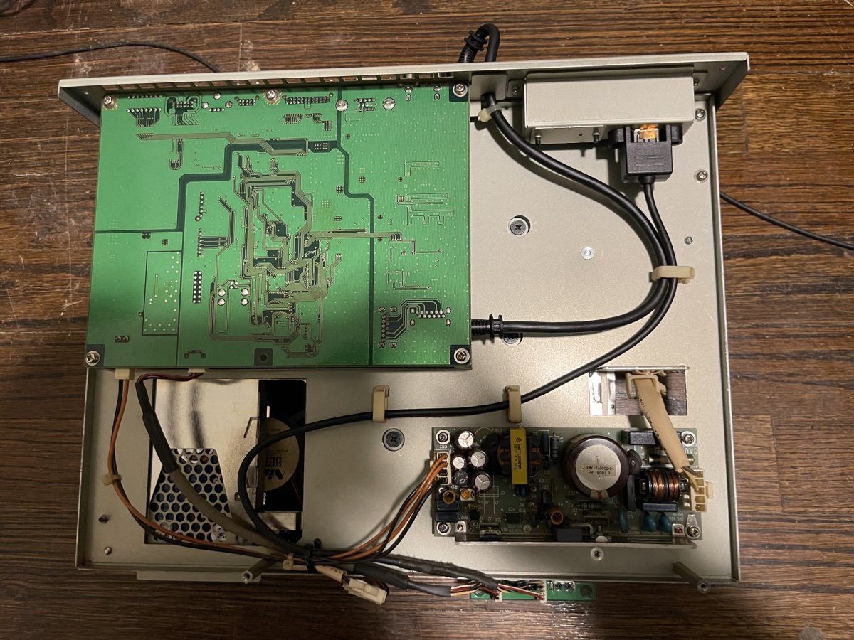

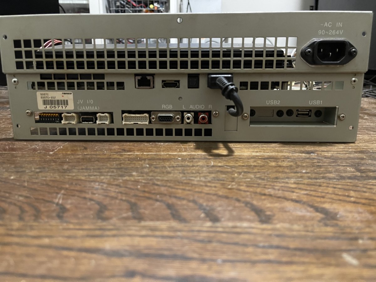

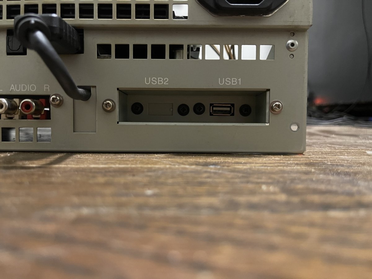

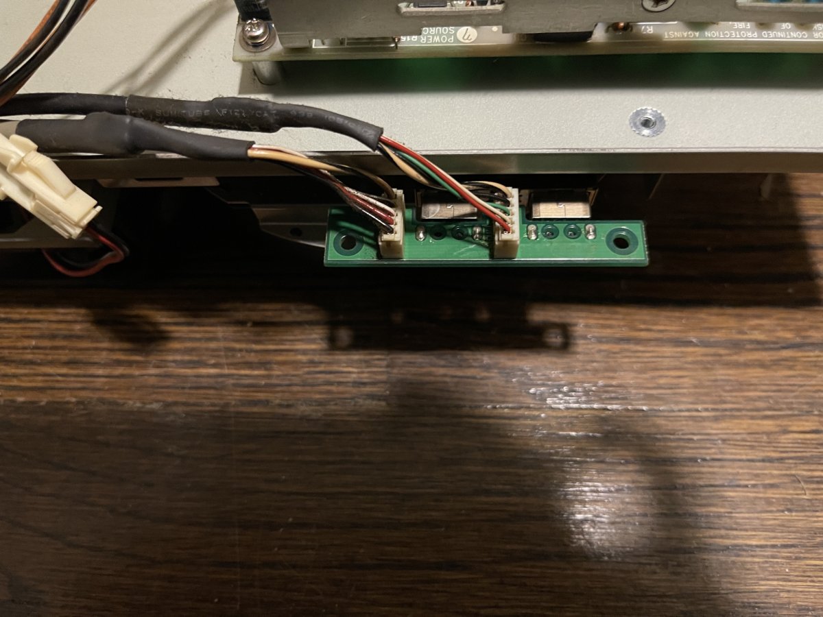

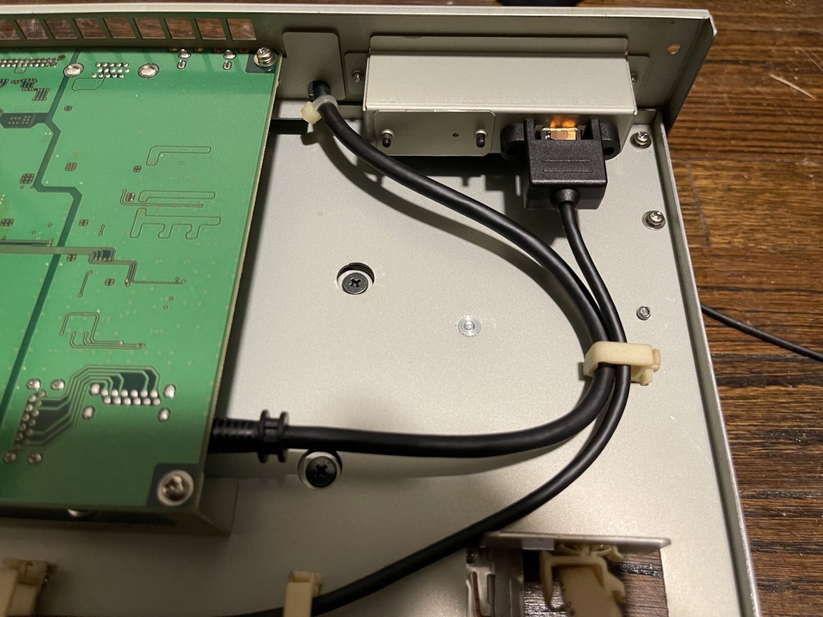

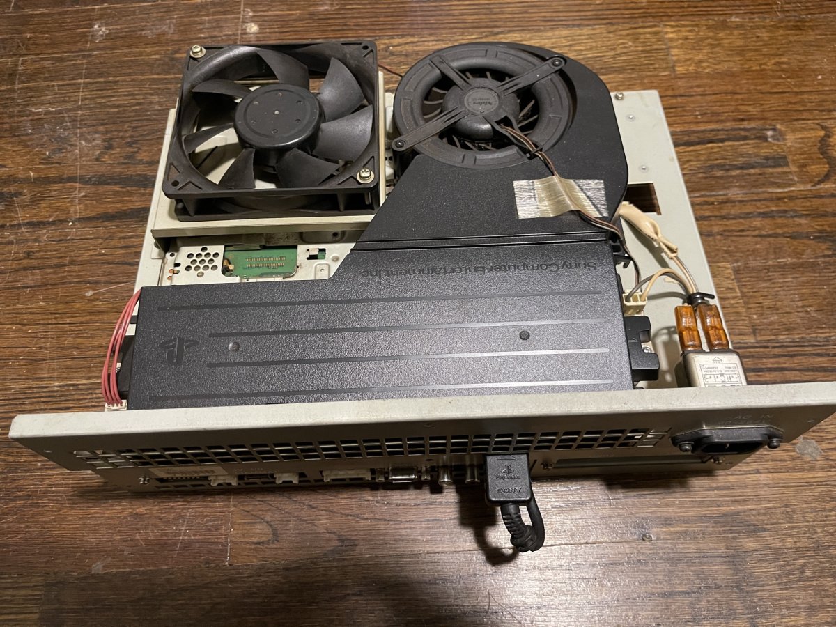

Took apart my 357C a while back to take some close up shots, might as well post them here for future documentation:

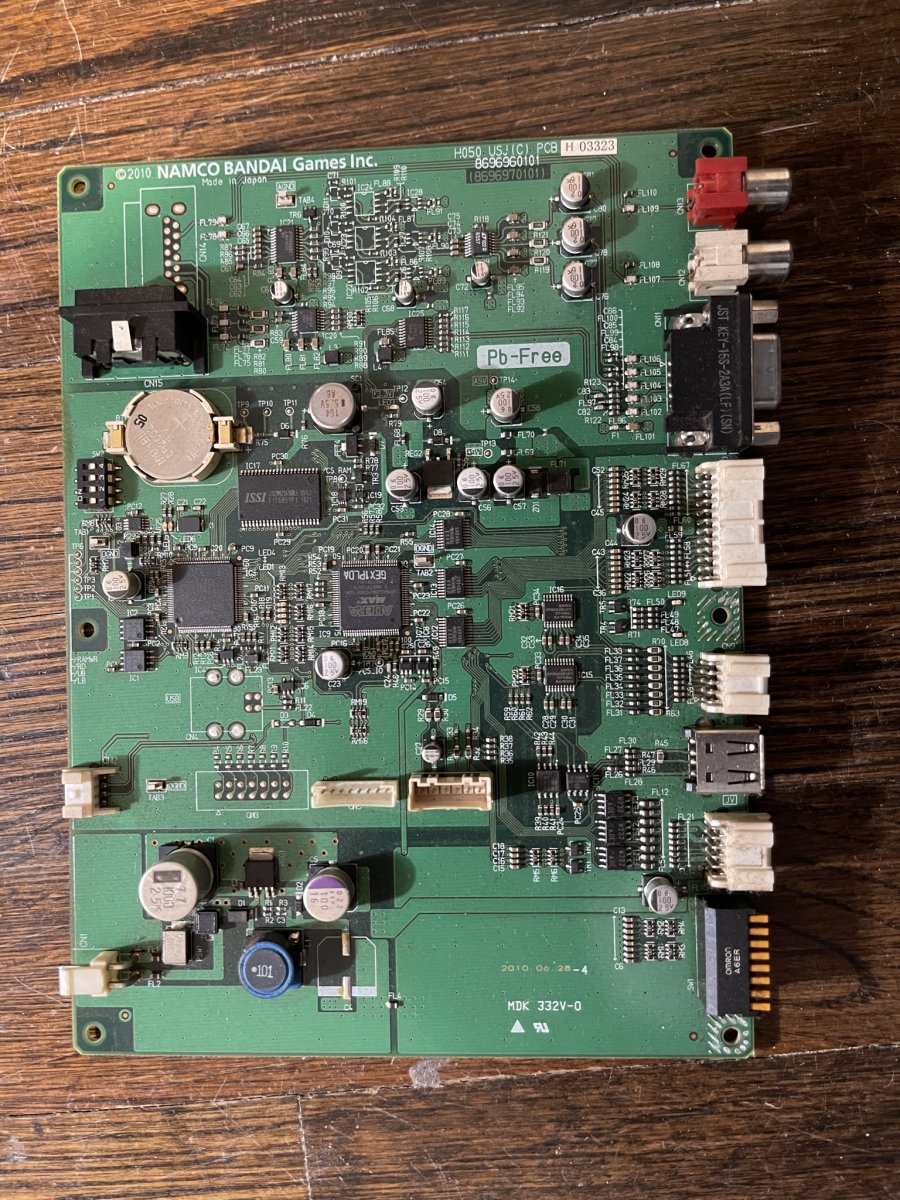

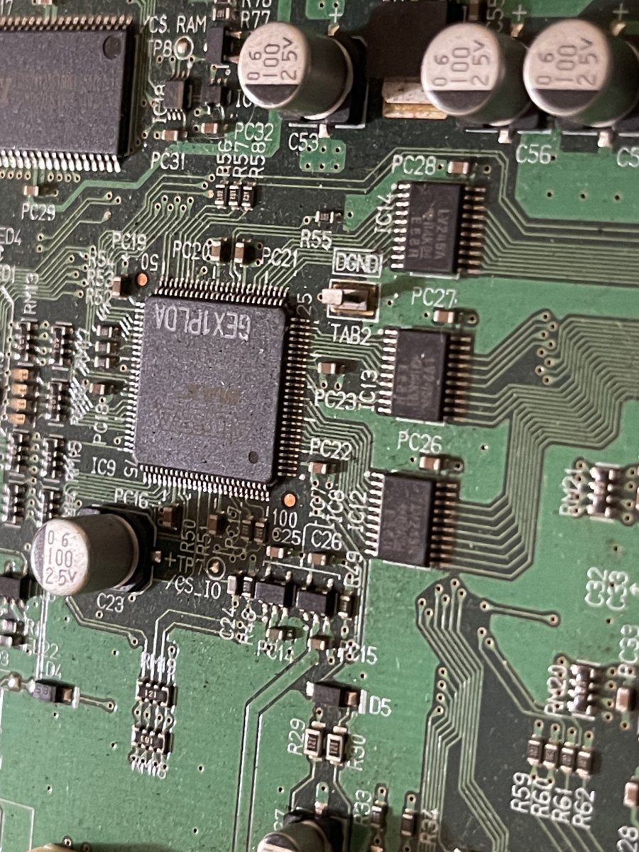

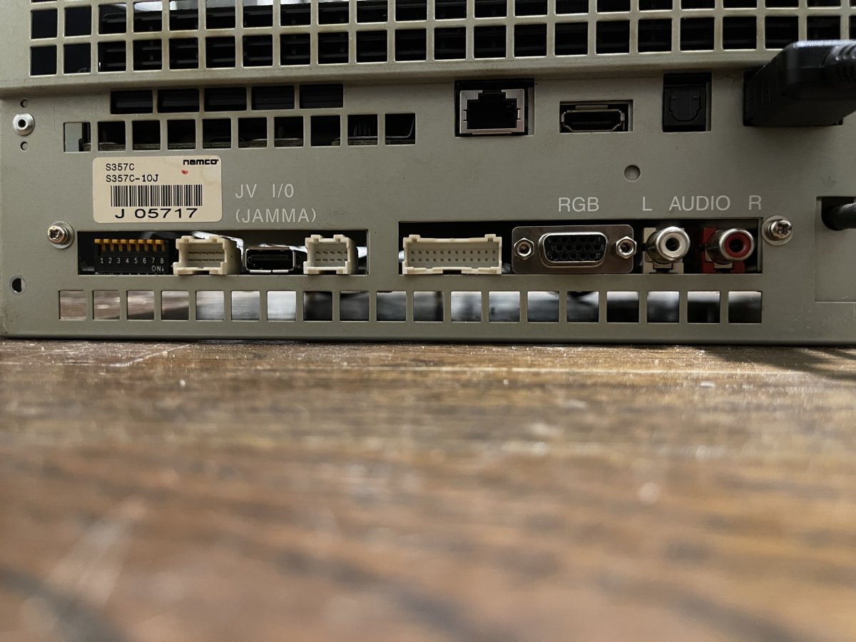

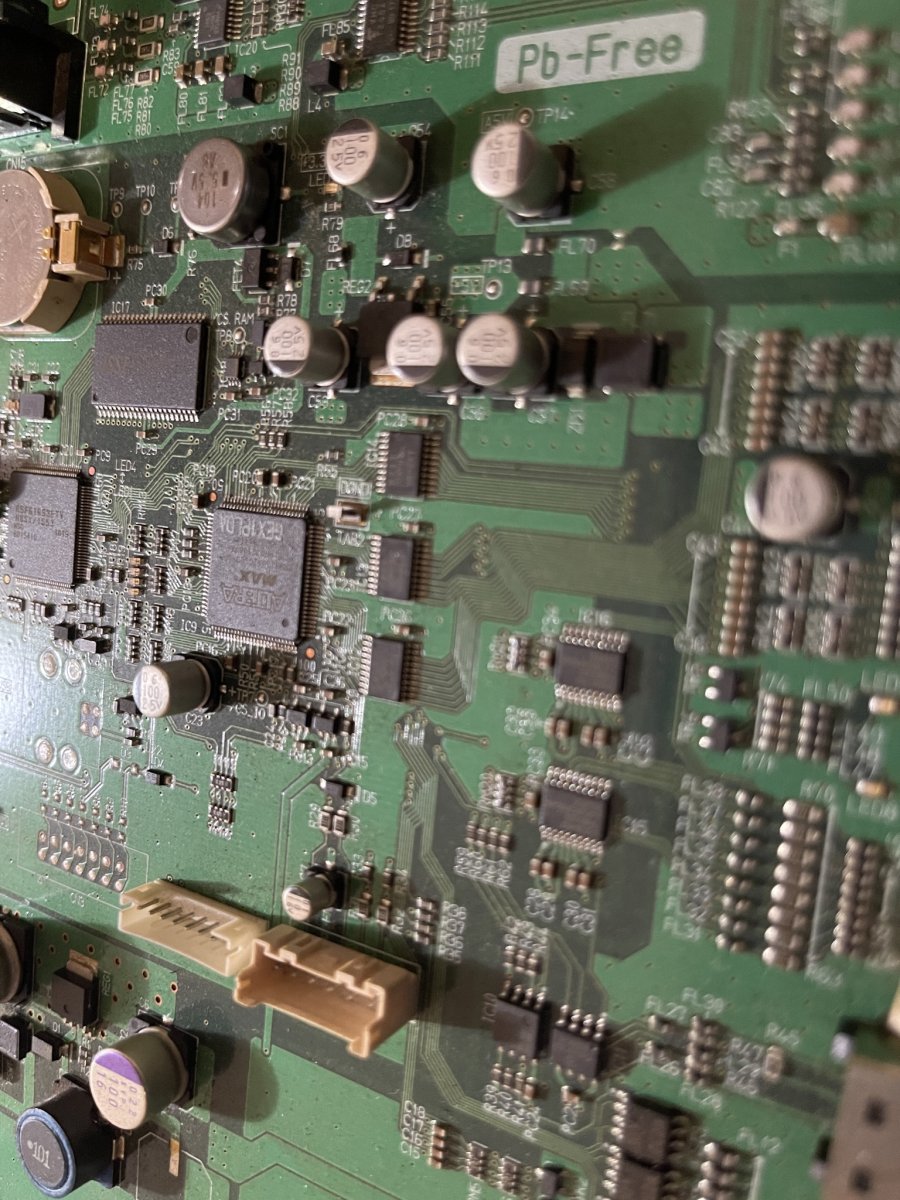

Here’s some more pictures. Surprisingly the video/JVS board on the 357C has a code name “woodpecker” while the 357A/B doesn’t. Not sure about the 369.

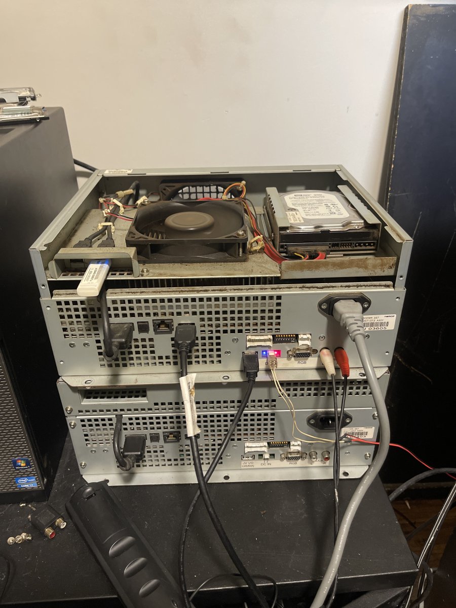

Hi again peeps! I got ahold of another 357A board today and this time it came with the Tekken 6BL HDD and dongle, seems to be an older revision as I don’t see a 3.40 firmware sticker, I need to see what firmware this board has and I’ll update this.
I got it for cheap and it did have the YLOD. I was able to revive the unit by reflowing the RSX, I’m not sure how long it will last but it’s a good start.

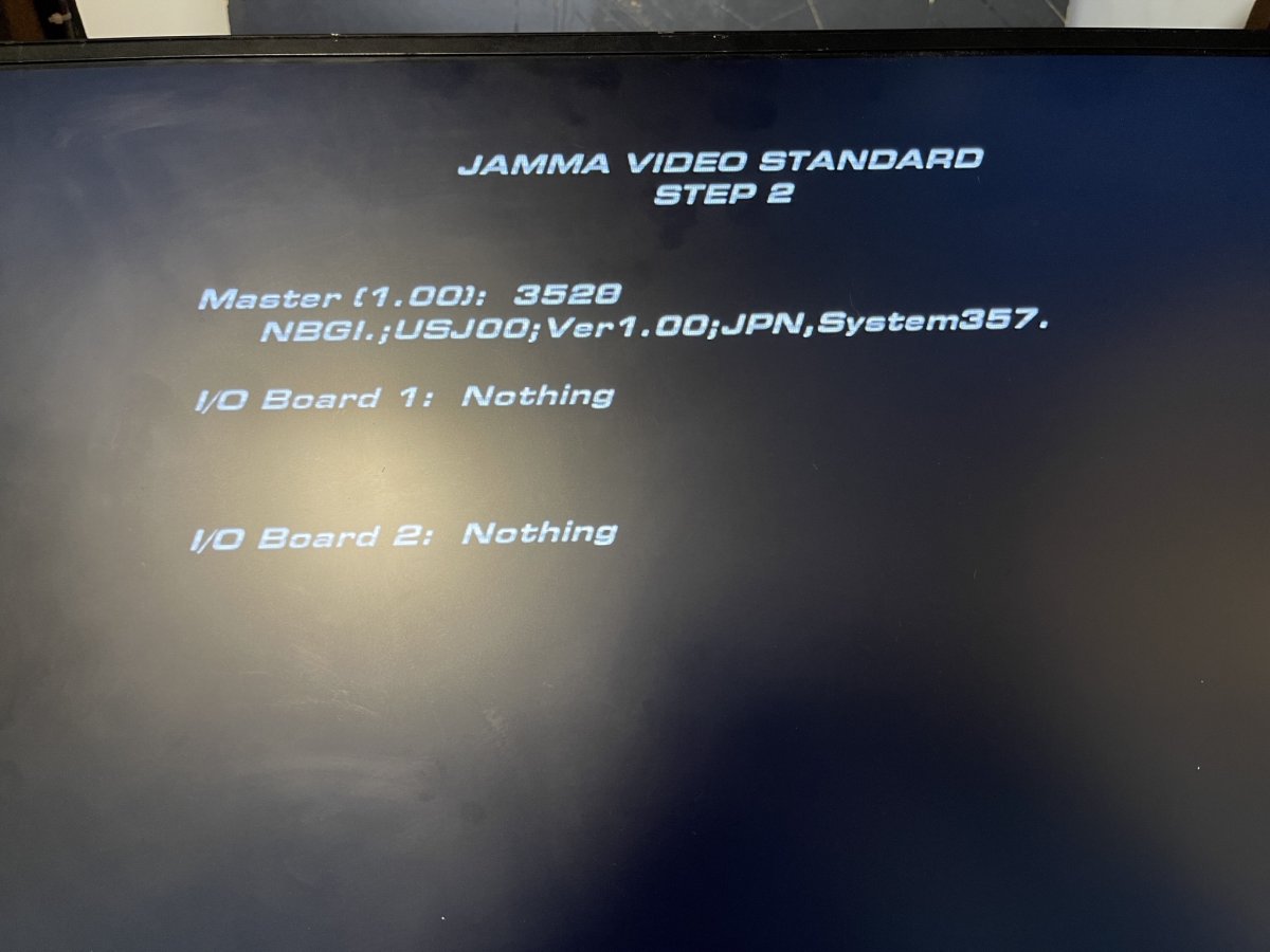

Out of curiosity,since I had an updated 3.40 motherboard, I wanted to see if the myth was true about being able to downgrade and use different firmware HDDs. So I plugged in the dongle and HDD on my system and it did not work. It threw up an error stating that the HDD was corrupted but it wasn’t. The HDD still works and even has the original arcade custom characters data. Pretty cool. I do need to heavily deep clean this unit because it’s extremely disgusting. If anyone is wondering, the unit did come complete, just have it disassembled for testing purposes. :)
Edit: I forgot that I can’t check the firmware version on the early models as they don’t tell you on the error screen, on the 357C and 369, it will tell you the firmware.
